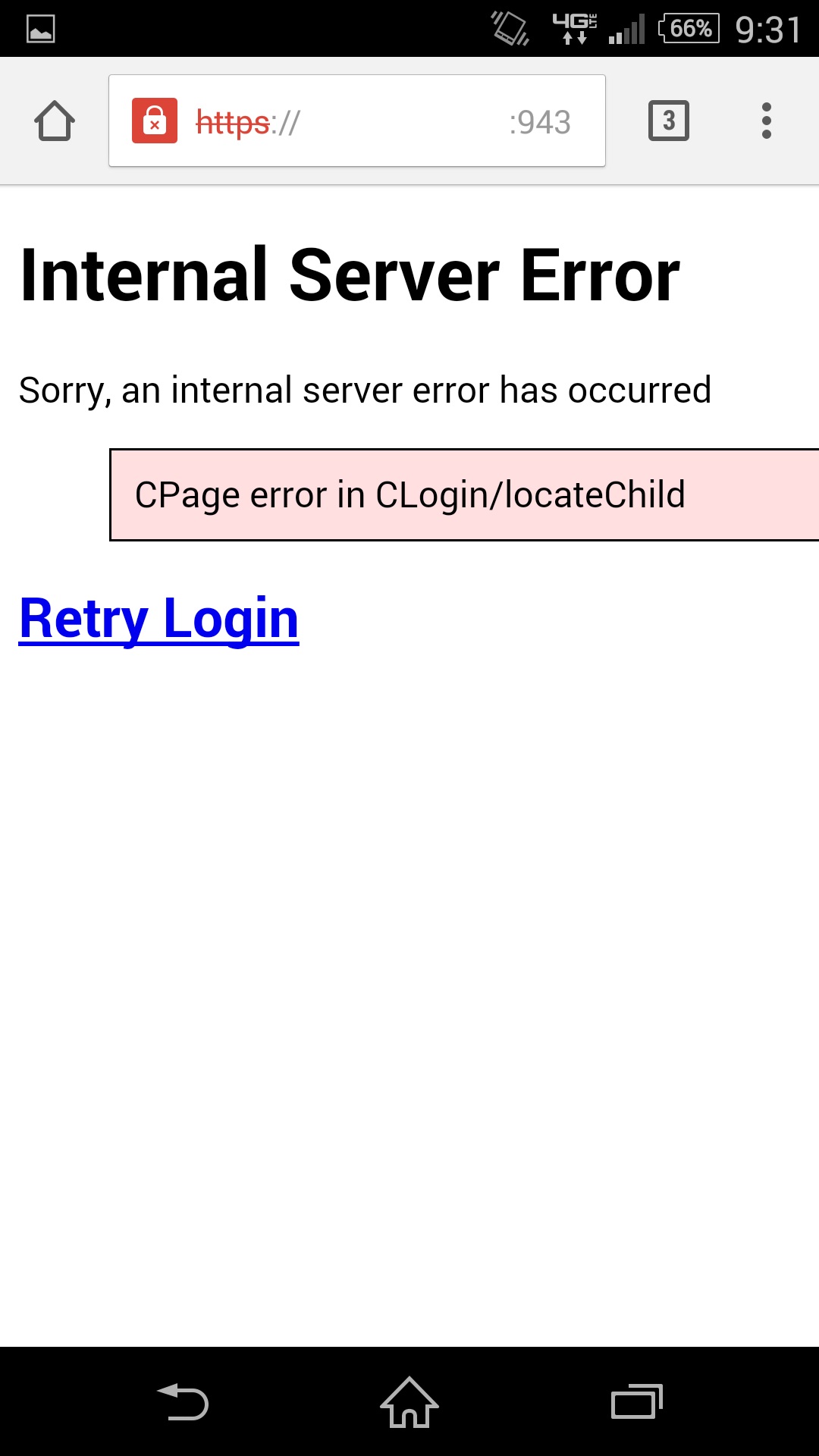

So I've been reading up on setting up openvpn for my unraid server as I'm often away on business and would like access to fix an errors in my other dockers...I had some time to read through the thread and the steps prior to installing the first time however have yet to achieve success.
Steps I've taken thus far:
1. Installed docker template and set config location to /mnt/cache/appdata/openvpn
2. Login to OpenVPN to confirm I can access it
3. Set my external IP from my router in the Server Network Settings
4. Added 192.168.1.0/24 in the VPN Settings
5. Created a user, assigned a password
6. Went to my router (it's a Verizon router...not sure if that matters) and forwarded ports tcp/443 * tcp/943 * tcp/9443 *udp/1194 (figured I would do all for good measure at this moment since I've never done this before)
7. Went and did a connectivity test, all errors...
8. Tried accessing https://externalIP:943 and got an 'Internal Server Error' with this "CPage error in CLogin/locateChild"
Not sure what to do next to get this working, is there a specific place I should pull a log from that might assist?

Tried it from my phone as well per your suggestion, attached a screenshot of the error (removed the external IP)

The only thing I could find about that error seems to be that i can occur when disk is full.
Hows the space of your docker.img?
Other then that all I can sugest is to remove the image and config and see if that helps.

I got OpenVPN-AS working - I deleted the docker image, increased sized to 15GB (just to be safe), restarted and just re-added all the containers.
I had 10gb and 8gb were full however it was still causing the error.  After re-install, it's still showing 6gb usage but no errors with OpenVPN.
In addition to your tip aptalca, I installed cAdvisor before starting all of this which let me see that some dockers and templates I had removed were still taking up space...just tips for anyone else in the future that might have issues like this in the future.

I had to try to reproduce the "bug" and it was quite easy.
A docker image of only 2gb and only openvpn-as installed reproduced the same error.
So I installed an ubuntu vm and tried the same, when disk space got below 2gb I got the same error.
Guess thats the limit =P

An existing openvpn server connection stopped working after I changed my ISP. Router, internal ip address range etc are exactly the same. What could I need to change?
