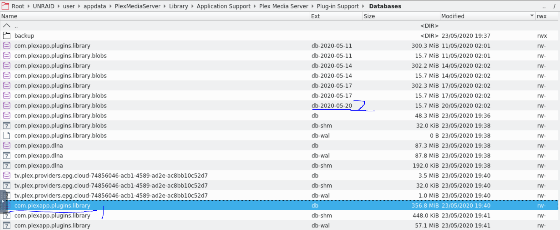

Woke up to plex not working and the log is full of "Starting Plex Media Server".  I have tried restarting the docker and rebooted unraid, neither worked.  My cache drive became 100% full at some point last night I think, this might be related.  Usually when that causes docker issues a reboot solves it.
User uid: 99
User gid: 100
[cont-init.d] 10-adduser: exited 0.
[cont-init.d] 40-chown-files: executing...
[cont-init.d] 40-chown-files: exited 0.
[cont-init.d] 45-plex-claim: executing...
[cont-init.d] 45-plex-claim: exited 0.
[cont-init.d] 50-gid-video: executing...
[cont-init.d] 50-gid-video: exited 0.
[cont-init.d] 60-plex-update: executing...
No update required
[cont-init.d] 60-plex-update: exited 0.
[cont-init.d] 99-custom-scripts: executing...
[custom-init] no custom files found exiting...
[cont-init.d] 99-custom-scripts: exited 0.
[cont-init.d] done.
Starting Plex Media Server.
[services.d] done.
No update required
[cont-init.d] done.
[services.d] done.
After that the last message just repeats.
Go to Tools - Diagnostics and attach the complete Diagnostics ZIP file to your NEXT post.
Sounds like maybe your issues are larger than just this container, so I may split to its own thread.

Thanks, diagnostics are attached.
nastheripper-diagnostics-20200523-1146.zip
You have a lot of shares, all with no Minimum Free, and a lot of mostly full disks. This is likely to cause issues with overfilling disks.
The general recommendation is to set Minimum Free for a share to larger than the largest file you expect to write to the share. Unraid has no way to know how large a file will become when it chooses a disk to write. If a disk has less than Minimum, it will choose another. Cache also has a Minimum setting in Global Share Settings.
Other than that, it isn't clear what the specific issue is. You might try deleting and recreating docker image in Settings - Docker. Then the Previous Apps feature on the Apps page will reinstall your dockers just as they were.

I was aware of the fact that unraid would try to write files that were too large for the destination but never looked for a setting to prevent it or did any research.  I guess I don't understand why unraid doesn't just look at the current file size and determine that it won't fit, and then write it to the array?  I have put some values in for this on my shares the write to cache and hopefully it will help prevent this issue in the future.
 First I tried removing the plex docker, no dice, then I stopped docker in settings and removed the image, added plex back alone and still no dice, same error message, I haven't seen any issues before or after with any of my other containers, they all added back fine.  I'm attaching a fresh diagnostics from after re-setting up docker, just in case.
nastheripper-diagnostics-20200523-1726.zip
Did some googling and got it fixed.  In case anyone else has the same issue, my database was corrupt, probably because it wasn't able to get written to.  First I stopped plex, and moved the file labeled 1 in the below image to a backup folder that I created.  Then plex was able to start , but it was a fresh install, I thought maybe it would grab a backup, no luck, but at least plex would start.  Then I stopped plex again, deleted the tiny version of file #1 that had just been created, copied file number 2, because it was the most recent date, to the backup folder, then renamed the original copy to not have the date.  That worked and now plex has only forgotten the last 3 days.  Too bad plex will only create a copy every 3 days.  I was waiting on winrar opening CA_Backup.tar, and it looks like I have a newer version in there, so that's even better.  Thanks for the help @trurl !
