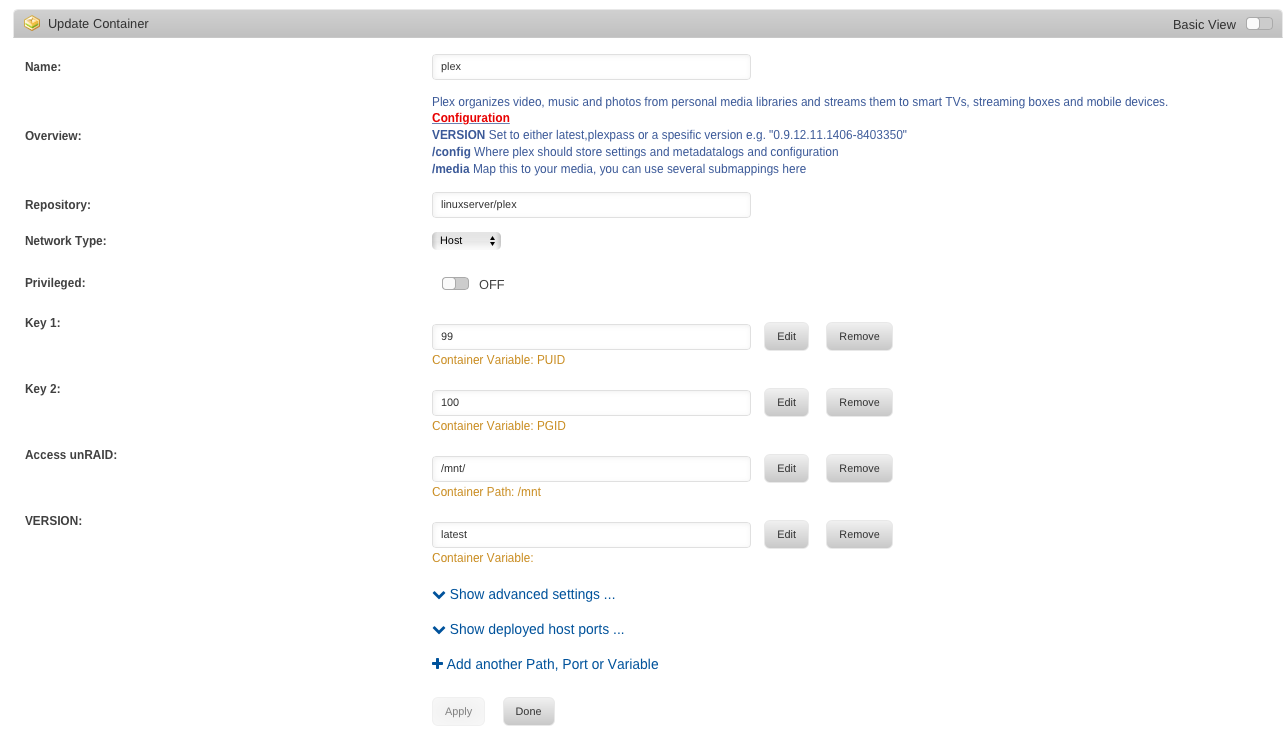

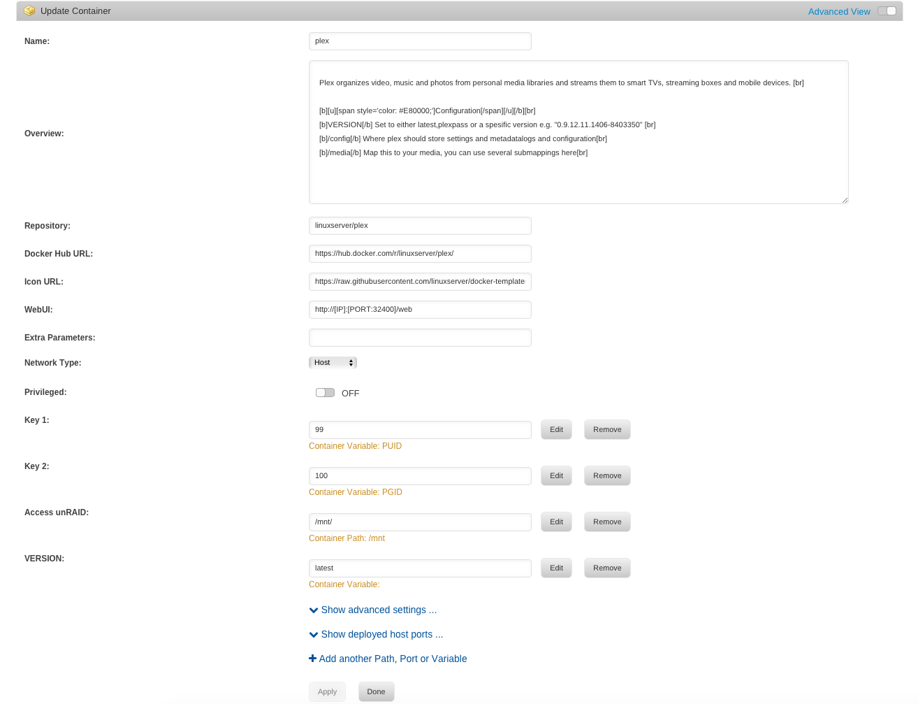

Been using this docker for quite a while without any issues. I tried the Plex DVR Beta by changing the VERSION variable to the string for the DVR version. I just changed it back to latest but I can't seem to get it to update to the current latest plexpass version.  Seem to be stuck on version 1.1.4.2757, despite there being a newer version available. I've also tried specifying the string for the latest version, which didn't work. I've also deleted and recreated the docker using CA but again, it doesn't seem to have changed anything.
Any ideas what else I can try?
Not sure if it's related but I spotted this in the docker log:
# Update routine will not run because you havent set #
# the VERSION variable or you opted out of updates. #
# For more information checkout :- #
https://github.com/linuxserver/docker-plex #
Doesn't look like you have set the variable for version. Please post the run command for the container.
I think you're right, heres the run command
root@localhost:# /usr/local/emhttp/plugins/dynamix.docker.manager/scripts/docker run -d --name="plex" --net="host" -e TZ="Europe/London" -e HOST_OS="unRAID" -e "PUID"="99" -e "PGID"="100" -v "/mnt/":"/mnt":rw -v "/mnt/cache/Apps/AppData/Plex":"/config":rw linuxserver/plex
66398a1d5bac042c0a5296df1cbe36788100161f82a62c7c4d5c49a7acd0714a
The command finished successfully!
I can't see the version variable listed... heres a screenshot of my settings
Here it is
I have version set to plexpass.
Kevin.
