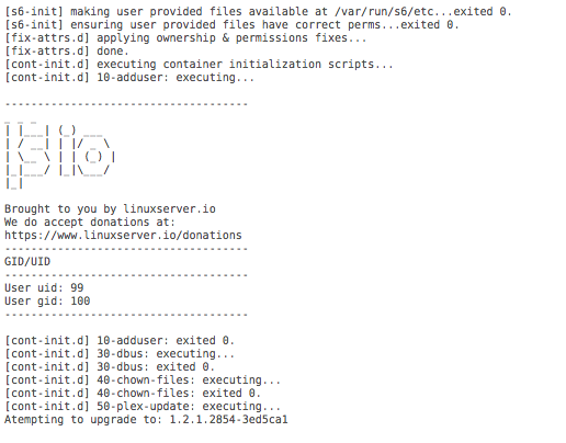

Upon update of container, I get this message.  I can't see the problem.
My port mappings are blank like that for Plex.... maybe something to do with the network set to Host. Why not take a look in the Plex Docker log to see what's up?
Well I let it run for 33 minutes and I just get the below.  Seems its still trying to update.  Bed time for me.  I'll check in the AM.  Any other advice, please share!
If you stopped it pre-maturely last time it may have gotten half an upgrade. I'd remove the container image and start over.
Well I think the problem was just my lack of patience (and my slow internet speed).  All is working well after leaving it overnight.  Thanks for your help!

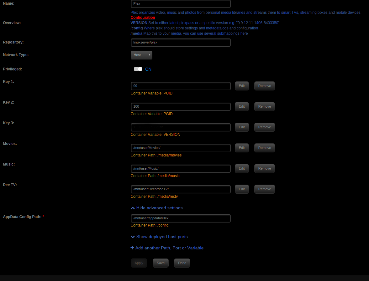

Having said that, a screenshot of the docker setup might be helpful just to make sure you've got it configured appropriately.

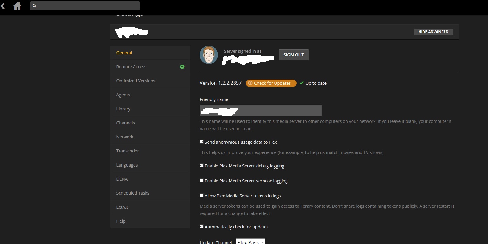

The version string is in thre, i just blurred it out.

Where is the DVR functionality?  I'm using the Plex Pass version (Version 1.2.2.2857) but I can't find anything?
Thanks!
For Plex DVR, go to the plexpass forum,  grab the version from the downloadable filenames and entre that value in the version field of the docker.  Please don't post the version number here though.
