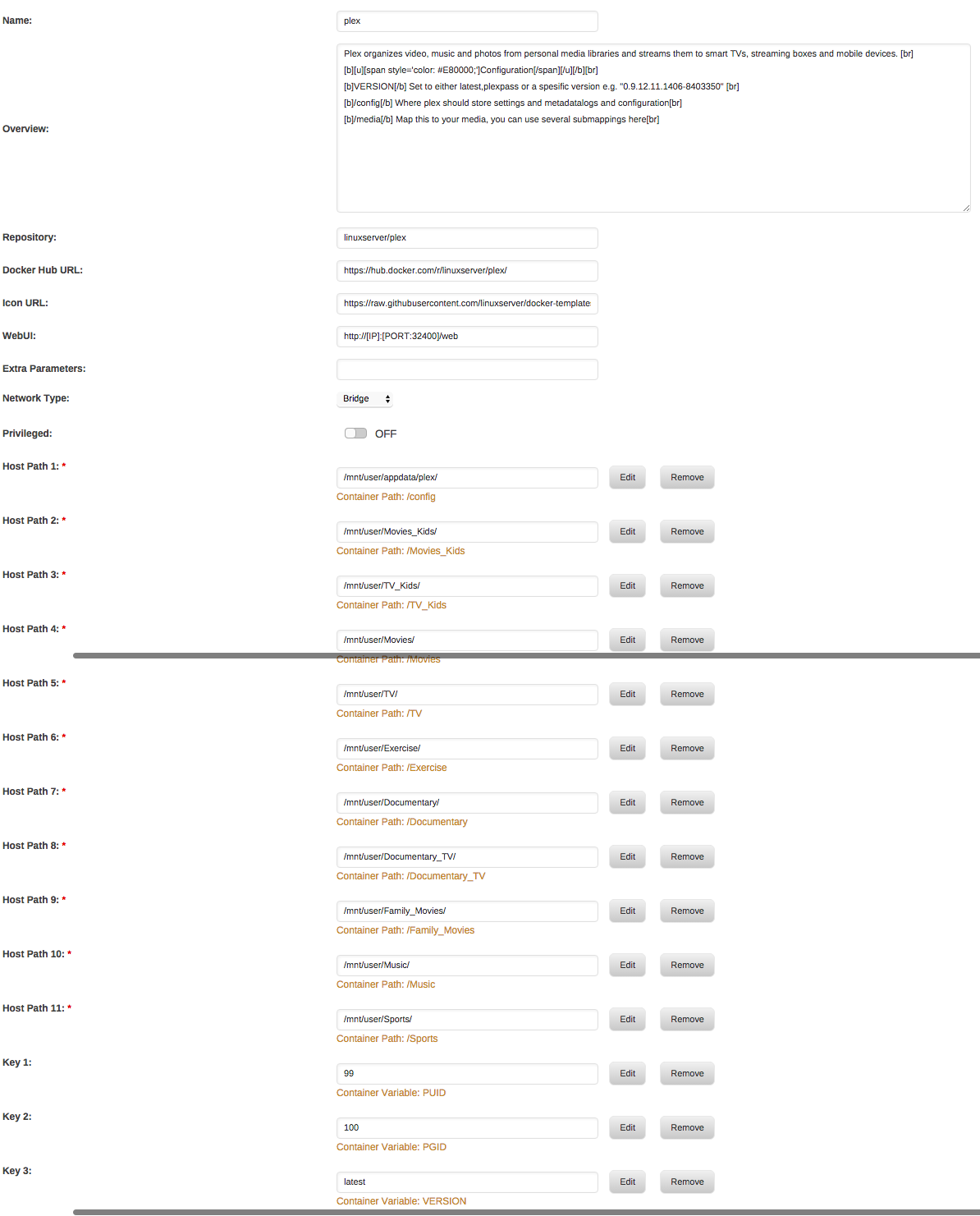

October 4, 20169 yr Hey guys. Just upgraded unraid to 6.2 and forced the update on Plex docker. Its not working now. I noticed that the Port Mappings Section is blank on just that 1 docker. I went into settings and started to tinker. Stupid me didn't take a screenshot of the settings before playing... Here are my current settings. Suggestions?

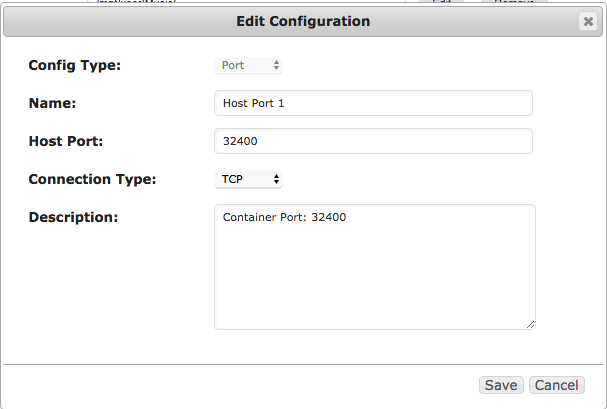

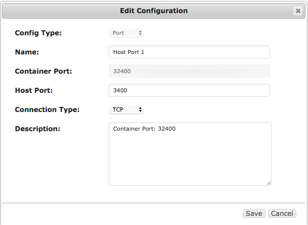

October 4, 20169 yr Hey guys. Just upgraded unraid to 6.2 and forced the update on Plex docker. Its not working now. I noticed that the Port Mappings Section is blank on just that 1 docker. I went into settings and started to tinker. Stupid me didn't take a screenshot of the settings before playing... Set Network Type to Host
October 4, 20169 yr Hey guys. Just upgraded unraid to 6.2 and forced the update on Plex docker. Its not working now. I noticed that the Port Mappings Section is blank on just that 1 docker. I went into settings and started to tinker. Stupid me didn't take a screenshot of the settings before playing... Set Network Type to Host Tried. Got same result. All other dockers are "Bridge"... I set as "Bridge" and setup a host port (32400). Still not working though... Can you confirm what you have for the webUI?
October 4, 20169 yr If you read the github linked in the first post, you will see that net=host is required.
October 4, 20169 yr If you read the github linked in the first post, you will see that net=host is required. Thanks. Just read through it again and then switched back to net=host. Still not working. Wondering if I have something wrong with the PUID or PGID values. I didn't change those and not really sure how to check what I should put in there. I see that its the only docker without port mapping applied.
October 4, 20169 yr That screenshot says you don't have a config mapping. I was looking at the same thing. I mapped a host port but need to do something else?

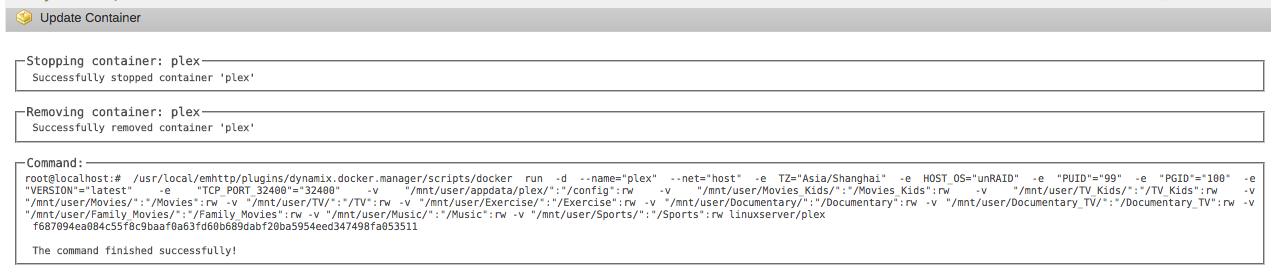

October 4, 20169 yr Upon update of container, I get this message. I can't see the problem. My port mappings are blank like that for Plex.... maybe something to do with the network set to Host. Why not take a look in the Plex Docker log to see what's up?
