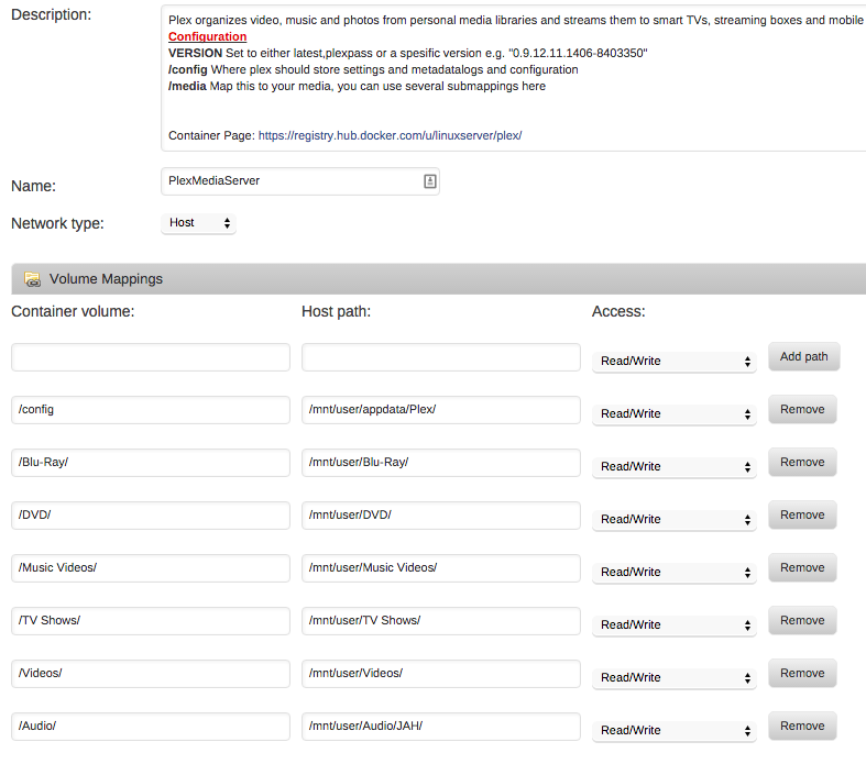

Does anybody have Run a partial scan when changes are detected working?, mine isn't.
Thanks for help
JAH
Thanks for help
JAH
Yes mine is working perfectly.
What can be wrong on mine, I have  Update my library automatically and Run a partial scan when changes are detected selected, Here is a screenshot of the docker config.
