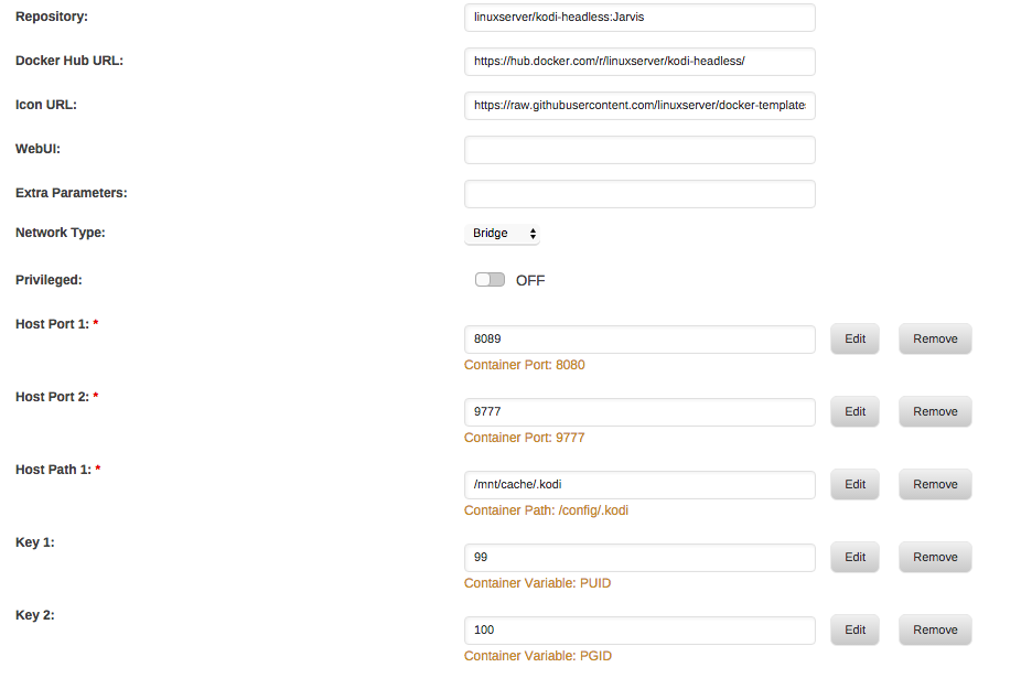

I'm having problem with this docker. It shows that is running, but I cannot access it in browser. It seems to be installed properly and it is running. I specified Version = 16 in Environment Variables. I edited advancedsettings and copied sources.

I do not think is browser related. I tried opening webUI in IE and Firefox and it was not successful.
I changed permissions too.
As far as I'm aware due to a bug causing segfaults that affects ALL docker containers of kodi-headless (not just our versions) this currently isn't working.  The posts above explain.

I do not think is browser related. I tried opening webgui in IE and Firefox and it was not successful.
Regardless of the segfault problem, read the first post regarding versioning, and how to pull specific versions.

I'm not using protected samba shares but I tried directing the version to Jarvis by using "linuxserver/kodi-headless:Jarvis" in the repository directory and that seems to have fixed the log spamming.

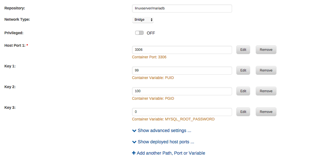

Before I post my little problem I'd like to thank nearly everyone in this thread for all the knowledge and information that has been shared! Im running a few HTPC's with either Android & Kodi or OpenELEC installed. I tried to "centralise" the libraries using Emby but it just didn't work right. So I've literally spent the guts of 24 hours of the past couple of days getting mysql working and I think I've just about got it nailed but It seems i'm falling at the last hurdle.

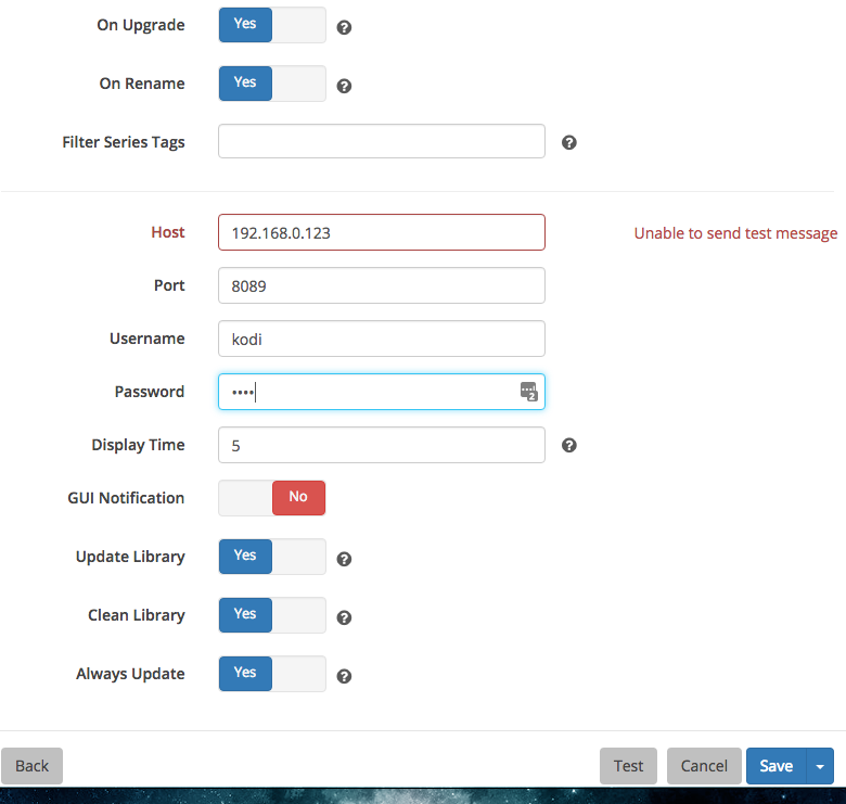

I'm trying to get Sonarr to notify Kodi-headless when it downloads a show but I can't seem to get it working, I get the error Unable to send test message when hitting test or save (see attachments)
This is the advancedsettings.xml (that I have both on my cache drive in the kodi folder and in the userdata folder of my kodi HTPC). I've also copied the sources.xml and passwords.xml over to the config folder.

If you read some of the previous posts you'll realise that this isn't currently working with any degree of reliability.
Haha :D I've read through all 18 pages here, and any other page with anything to do with MariaDB/mysql/kodi/headless etc etc. Just seems strange that my Kodi HTPC is now using the headless database but Sonarr can't connect. If Sonarr won't update it then this has all been for naught!
With Kodi continually having problems running headless (kodi's issue, not LSIO's), the easiest solution by far is to simply run a libreelec VM with 512M memory, and no passthrough.  It works perfectly with VNC, and then you also have the additional bonus of being able to easily run other scrapers instead of the stock ones.

Maybe I'm missing something, but it seems you are inputting "kodi" as a username in sonarr, correct? First off, the default user/pass in the advancedsettings.xml is xbmc:
<webserverpassword>xbmc</webserverpassword>
<webserverusername>xbmc</webserverusername>
Secondly, concerning the seg faults, I got the docker to stop crashing by copying Addons20.db from my 16.1 Mac OS X box (perhaps you can get it from another build) and set the below to 2 in guisettings.xml to prevent addon updates:
<addonupdates>2</addonupdates>
It's worth a try before exploring other alternatives. However, I do like the VM option as well.
