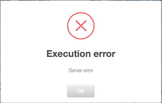

Just got notified that there was an update available, when I updated I'm no longer able to start the docker. Getting a "Execution error - Server error", but cant find anything in the logs.
Anyone experiencing the same thing?
I just updated mine and no issues here. You'll have to provide more info. Where did you see that error? Unraid gui? Docker log?
In the GUI almost immediately when pressing Start
Any way to get more logs? Cant see anything happening in either the docker log or the system log.
Post your diagnostics (Tools - diagnostics) before rebooting, and additionally, a screenshot of the docker Tab (top right switch from Basic to Advanced view)

I was hoping for the whole screenshot, but it appears the problem is this:
time="2017-06-17T20:44:48.181332593+02:00" level=error msg="Handler for POST /containers/134dbc03f12a/start returned error: driver failed programming external connectivity on endpoint sabnzbd (7526baafe1d518db9deda142ac1107319920f674e1f53cbaf46dce849afde753): Error starting userland proxy: listen tcp 0.0.0.0:8080: bind: address already in use"
Port 8080 is in use.
Do you have another app already using that port?  If not, your best bet is to remove the sab container and image, reboot, then reinstall it either via Apps - Previous Apps, or the Add Container Template Drop down and select the my-sabnzbd user template.
Either way, all your appdata will still be present and accounted for.
Thanks, thats it! Im running a Docker with Unifi (network admin tool for my router/APs), and it has to be run in host-mode to work properly.
Any tips for getting around this? ATM im just stopping the Unifi docker to test.
PS. Removed my diagnostics from the previous post to be on the safe side.
Change the host port on sab. Simple and easy.
