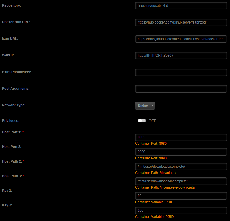

I see that Sonarr (docker linux|server.io 2.0.0.5163) sends a download to Sabnzbd (docker linux|server.io 2.3.3 [1f04343]) successfully. But the download just sits there, and no mkv is extracted from the rar files.
sabnzbd reports
Repair [630d80d5bde8430a9bc59eb7932c8288] Quick Check OK
Unpack [630d80d5bde8430a9bc59eb7932c8288] Unpacked 0 files/folders in 0 seconds
While Sonarr just thinks the episode is downloading 100%, and sitting there. As soon as I manually unrar e "blah blah.rar.part001.rar" the mkv comes out, and Sonarr immediately files it away.
I know Sabnzbd is sitting in a container, and doesn't have access to the normal /user/bin/unrar.
I do have some odd settings in there to keep Sabnzbd from thrashing the server if it's working on a dozen or more episodes at once. Settings > Switches > Post processing >
Nice Parameters -n10
IONice Parameters -c2 -n4
Extra PAR2 Parameters -t0
I don't recall where I got those things. I'll try pulling them out and seeing if that makes a difference.
Anything jump out at anyone? Any other specific logs to include?
attached.
Not sure where the "docker run command" was, so I'll include a couple of screen shots of the config screen for both dockers.
rubble-diagnostics-20180512-2139.zip
sabnzbd 20180513.zip
It might be those custom options. I use the default options and it has no problems unraring. In fact, the later versions do unrar while still downloading. Pretty cool
In the Sab log files can you tell me which episode it failed to unpack or process? Thanks
Edit: I can see what you mean, it says unpacking then shows 0 unpacked.
2018-05-11 18:27:39,266::INFO::[newsunpack:835] Unpacked 0 files/folders in 0 seconds
2018-05-11 18:27:39,266::INFO::[newsunpack:268] Unrar finished on /incomplete-downloads/Once.Upon.a.Time.S07E21.720p.HDTV.x264-AVS-Obfuscated
2018-05-11 18:27:39,270::INFO::[postproc:388] Unpacked files []
2018-05-11 18:27:39,271::INFO::[postproc:393] Finished unpack_magic on Once.Upon.a.Time.S07E21.720p.HDTV.x264-AVS-Obfuscated
As someone suggested, back-up the options you have then turn them off. Try again and report back.

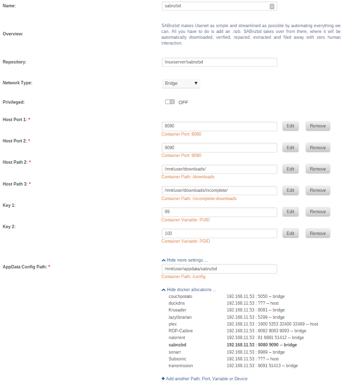

On 3/25/2018 at 11:04 AM, Rick Gillyon said:
Sabnzbd updated on Friday, and after restarting I was getting an error when trying to access it via the browser:
Access denied - Hostname verification failed
Was working fine before the update. Nothing I changed helped, I couldn't start the interface from browser with http://unraidpvr:8083/ like normal. I hadn't realised I was on the unstable branch, so I edited the container to take away "unstable" and after restarting, I could get in once again. All is working as it should except that the "version" section on the Docker tab looks like this:
Any ideas? For either problem... :)
Docker properties currently look like this:
FYI this is a bit older but make sure to to the Config in Sab and go to "Special" and scroll down to the bottom. There's a section for a whitelist, make sure it reads "tower" or "Tower" depending on how you are trying to access it (or whatever hostname you use for your Sab box)
The case sensitivity is key -- it matters.

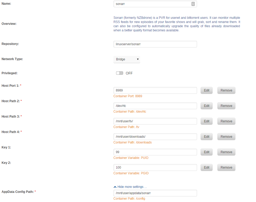

Thanks, think that's the way to go for now. I finally got time to configure this again, and having some confusion in making it work similar to Phaze plugin.
With Phaze plugin we had direct access to the file system, so the Categories had their path in absolute format.
However with docker, and that I also moved Sonarr from Phaze over to docker, Sonarr will not have access to Sabnzbd's final download folder. How would Sonarr monitor the tv category and the file path (/Downloads that's visible in Sabnzbd) and move the file (that Sonarr can't see I think?) in the correct folder that's been set inside Sonarr?
think of it this way
mount point or docker volumes are a union between the internal path of a docker and a path on the host
if you give the same name to the container side of the mount, and bind the same host path to two different containers,  you can use the same container side path in the config ui of any app and as long as the permissions for each app to access the path(s) it works the same it would were it natively running on the host
My current setup is such that Sabnzbd docker volumes is pointing to /mnt/cache/appdata/sabnzbd/complete-download for Downloads and /mnt/cache/appdata/sabnzbd/incomplete-download for Incomplete Downloads.
So from my understanding so far, Sonarr needs to point it's container /downloads path to /mnt/cache/appdata/sabnzbd/complete-download instead of what I am currently setting it as (/mnt/cache/appdata/sonarr/downloads)?
Assuming the above is correct, then how would I get Sonarr to move the downloaded files to it's final destination? I am also assuming it's through the /tv path in Sonarr?  So this would mean I need to change ALL of my current config in Sonarr from /mnt/user/TVShows/* to /tv/TVShows/* right?
Thank you very much for your help!
Edited by CyberMew
Tentatively yes, but since you didn't itemize what the path mappings (container side) are for Sab, I can't say definitively
Yes.  But you can take a shortcut and instead map /mnt to /mnt on Sonarr which will save you from switching the basefolder for all of your TV shows.
To explain what @sparklyballs said in English, you can keep every single one of your settings, etc in Sab (ugh), Sonarr, Radarr, or CouchPotato (also ugh) by simply mapping/adding another path of  /mnt to /mnt on each and everyone of the apps.
See also this:  https://lime-technology.com/forums/topic/57181-real-docker-faq/?page=2#comment-566086
Edited by Squid
Thanks! That is really helpful, the /mnt trick seems to be very useful (I created another host path in settings, hope it didn't break anything that also uses /mnt internally), though I guess giving the whole /mnt might be a little too much. The link that you gave is also very useful for understanding as well. I'm already used to sab so I'm going with that but I'm changing over to Radarr from CP soon since CP isn't that reliable for me sometimes.
