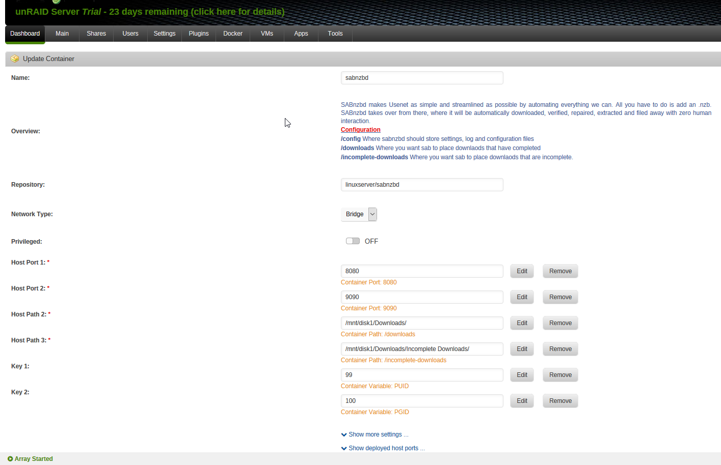

Also, can you post a screenshot of your settings for Sab docker?
Not sure about setting the user for Sab... Someone else might need to weigh in for that. For the record, I have never needed to do that and my Sab has been running without issue.

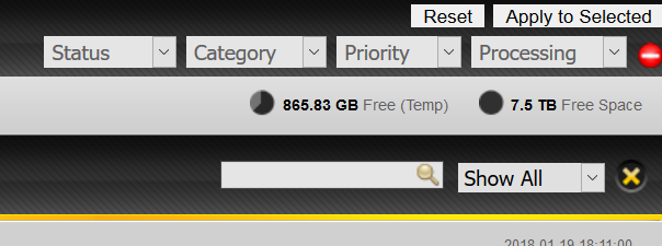

hi, here are my settings.  i am now seeing that sometimes it works, and sometimes it doesn't!  super annoying.  for example, just downloaded an album just fine, but it won't extract a movie.  some tv shows fine, but some just hang there.  maybe size related?  tons of room on my array, and my cache.  for example, just downloaded 3 tv shows, the first two episdoes downloaded and were sorted fine, the last one just hangs at 100% downloaded.  really up for any suggestions!!!
Edited by grither

Hi all.
I upgraded from "needo" version to the linuxserverio version as it seems to have better support.  Anyhow since upgrading i have has issues which i believe are related to permissions.  When a tv show downloads i get a fault "2018-02-24 19:54:41,568::ERROR::[misc:1597] Cannot change permissions of /config/Downloads/complete/tv/xxxxxxxx" Where xxx is the tv show. I have checked the SAB config and have played with the permissions value, but its at 777.  It seems SAB cant change the file and so post processing fails.  Im totally lost, so can anyone help me resolve this issue?  Im not sure if this is a sab issue, an unraid issue or what?

Hi all.
Thanks des.
Can anyone assist me with this issue? If this isn't the right forum can you point me in the right direction? Almost all my downloads now fail making this system useless for me. Thanks in advance, des.

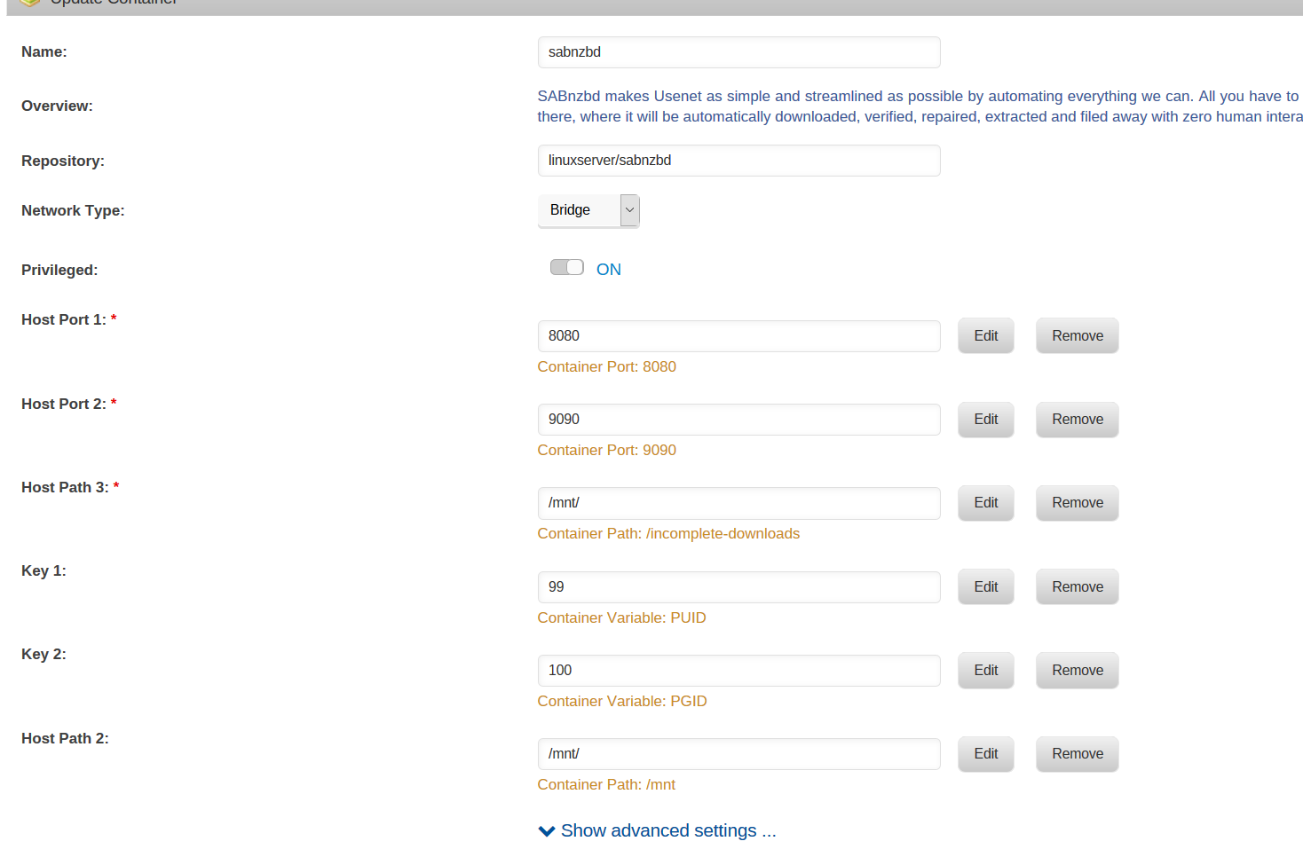

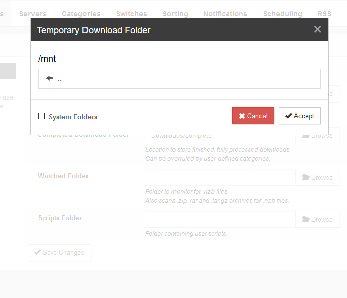

Hello,
I am a noob with this so please bear with me if I am missing something simple. I have searched everywhere and cannot find an answer anywhere. I have recently setup an unraid box with a plex server and it is running great so far. I am now trying to add sonarr and am having problems getting Sabnzbd setup. I am Going off of Spaceinvader one's youtube video. I installed it through Unraid's Community applications and had no problems. The problems is that when I try to change the download directory in Sab settings I cannot find my drive or folder. I am trying to change the downloads to /mnt/disk 1/downloads. I also tried mnt/cache/downloads. In Sabnzbd I go to settings, then folders, then try to change the folder paths for downloads. I also already created the folders and changed the locations in the sab template in unraid. When I navigate to where (I think) the folder is the directory is empty. I have looked through all of the directories but cannot seem to find the downloads folder that I created anywhere. Am I missing something stupid? I have done a LITTLE bit with linux but am really not that familiar with it. I tried to add a couple screenshots but could not get them to load. Thanks in advance.
