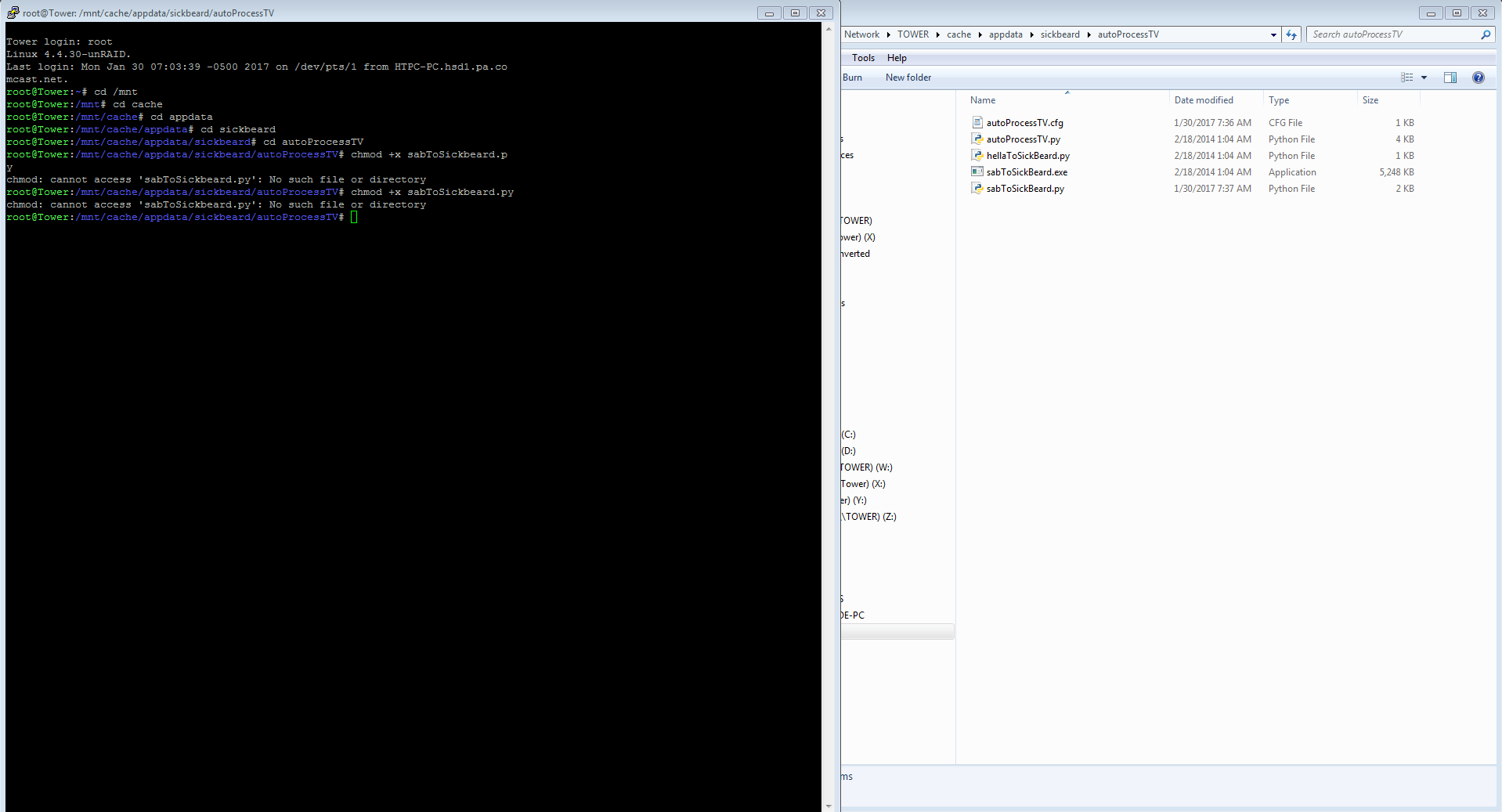

What am I missing? I keep getting errors when I try to chmod +x the sabToSickbeard.py script...
caps issue, notice the capital B for Beard.
tip:- type sab and press tab key to autofill the rest (up to the extension in this case as you have two files with the same name but diff extensions), save you making the same mistake again.
Dammit! That's it. Thanks so much, all sorted
