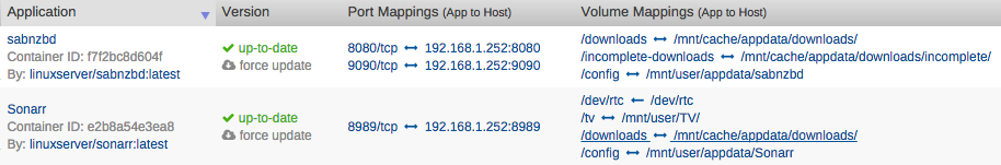

Hi everyone. I've spent about 3 days reading up and trying to get SAB/Sonarr running on unRAID and I'm still lost. The more I read the more confused I'm getting.
These are the mappings I have:

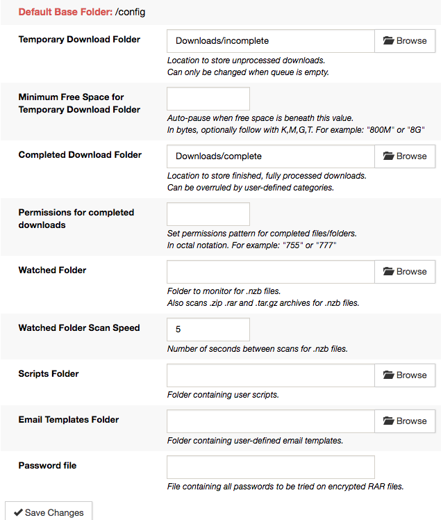

My SAB Folder settings says the base folder is /config, and Temporary Download Folder is "Downloads/incomplete".
index.php?action=dlattach;topic=42441.0;attach=38136;image
How does this relate to my mappings?
Do I need to change the above Folder settings?

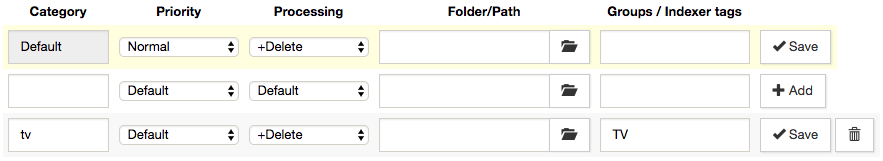

Under Categories, what do I use for Folder/Path?
index.php?action=dlattach;topic=42441.0;attach=38138;image
You don't actually specify what your problem is, but from your settings, I'm surmising that sonarr is telling you that it can't import such and such folder as it doesn't exist and/or doesn't have permission
The problem is within your settings for sab.
If you look closely, it says that the default base folder is /config (which is mapped to /mnt/cache/appdata/sabnzbd
The completed downloads you have as Downloads/completed
Sonarr is probably telling you that it can't import the folder /mnt/cache/appdata/sabnzbd/Downloads/completed/whateverItIs
Problem is the completed downloads setting in Sab.  You're using a relative folder (no beginning slash) so its stored within /Config as per the docs for sab
If you change it to /downloads/completed, then everything will work correctly
Further info that might shed some more light is here:  http://lime-technology.com/forum/index.php?topic=40937.msg488507#msg488507
