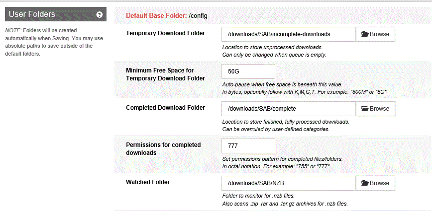

Can someone help with a permissions error I keep getting
Cannot change permissions of /downloads/SAB/incomplete-downloads/examplefilename.rar
Permission set to 777 and did run "Docker Safe New Permissions" but still keep getting the error. The only thing I have changed was moving from NFS mounts to SMB using unassigned devices plugin.
I had an issue recently which saw that folders could not be created. I then checked and for some reason the group:owner of the destination folder had changed to root:root so the service did not have the permissions to do anything with that folder, creating files or otherwise meaning that downloads remained in the incomplete folder indefinitely.
ls  - all
The above command confirmed this for me. So I changed the owner and the permissions of the destination folder (recursive) and all started working again:
chown -R owner-user:owner-group directory
Example:
chown -R nobody:users /directory
chown -R ### /directory
Example:
chmod -R 777 /directory
I think I have the commands correct. Hope it words for you.
