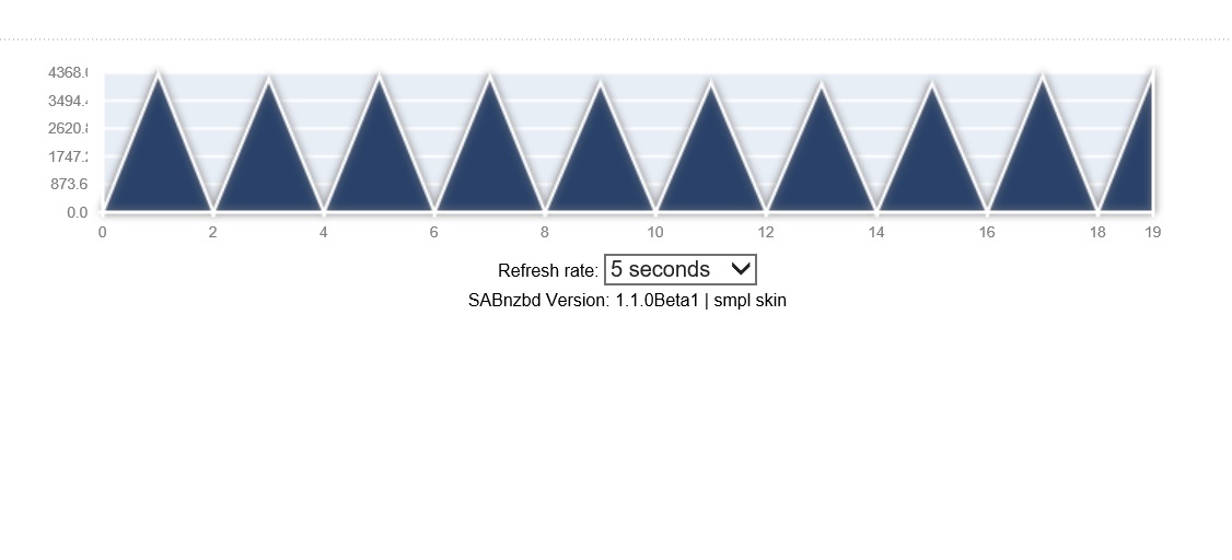

I had a power failure at my house last week and my unraid lost power.  I ran a full parity check and nothing seemed incorrect.  I did notice Sabnzbd was updated but didn't think anything of it.  Fast forward until today, I noticed I am missing a good number of shows I have downloaded and traced it back to the download folder being /data instead of the /downloads I configured.  I have several items I would like to grab from there but honestly I can't figure out how to terminal into that folder and move them.  I don't see them in the appdata folder at all but the container folders are visible when browsing the /data folder.  Any ideas would be very appreciated.
