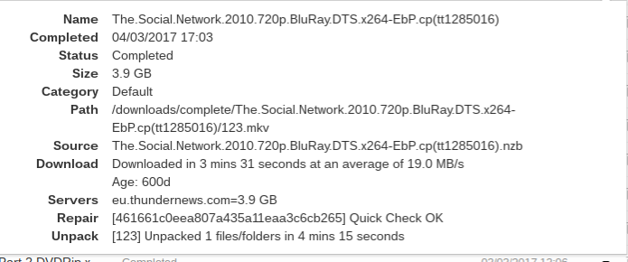

On 3/5/2017 at 5:13 PM, Niallain said:
Files are taking a long time to unpack?
SAB is installed on the SSD and the incomplete/complete download folders are also located on the SSD.
Any possible way of speeding this up?
Attached image for reference.
Digging this up again as I'm still experiencing this issue.
Installed Dynamix SSD trim as suggested, saw some brief improvements but a recent example took 17 minutes to unpack 46GB.
Can anyone offer any further suggestions for improvement?
To be honest, that doesn't particularly seem excessive, especially if any repairing was necessary.  If you install sab on a Windows box and download the same nzb how long will it take?

Unless I'm getting sensitive due to the fast download I now have...
File from last week - 4.7GB
Downloaded in 1min 57 seconds at avg of 41.0MB/s
No repair, unpacked in 1min 20seconds.
Surely I'd expect faster on an SSD?
I've just enabled the "direct unpack" parameter in sab and will see if this makes a difference.

Sorry, was using 2 different examples
File 1 - 4.7GB
File 2 - 46.6GB
Downloaded in 20min 30 seconds at avg of 38.8MB/s
2x verify at 2min 10sec each
Repair in 2min 6sec
Unpack in 16min 59sec
File 1 - 4.7GB
File 2 - 46.6GB
Repair in 2min 6sec
As Squid said then, seem reasonable.
Guess I'm just being picky then.
Thanks, not sure why I thought it was always quicker to unpack...
