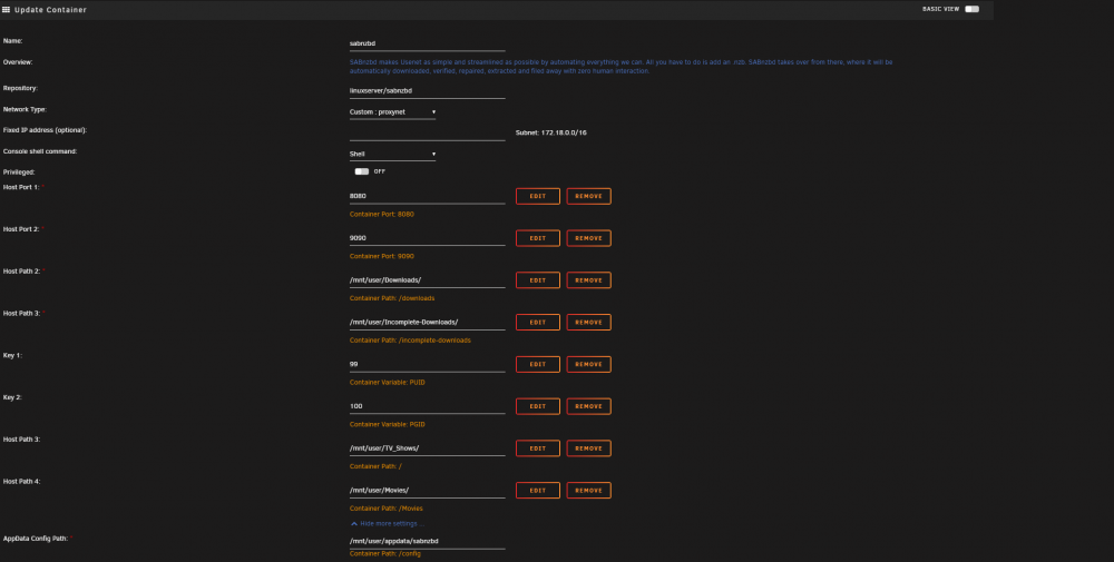

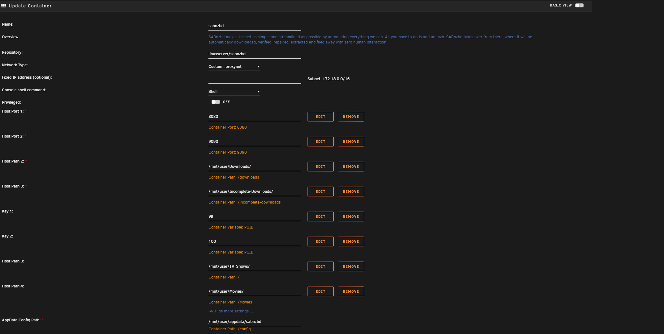

Hey all. I am having issues with sab, and multiple containers, that I cannot find the solution for. Whenever I update any container, the configuration is reset to default and I need to re-enter the configuration in for that specific container. In sab's case, it acts like it would for the first time it was downloaded every time I update the container. Any thoughts? Attached is my current settings for sabnzbd. Thank you all in advance!
Edit - Looks to be something with using the proxy in Sonarr/Radarr.  It was checked to bypass proxy for local addresses but if I set everything back to bridge and disabled the proxy everything worked normally.  Enable the proxy lose connection to sab.  Added server ip to ignored addresses in sonarr/radarr all back up and running
Anyone having issues with Sab/Radarr/Sonarr today?  Updated all dockers this AM and now Sonarr and Radarr are both unable to communicate with Sab. Has been working fine for years and know it was working yesterday so assuming it was something in the update this am.  I can navigate webui's of all three like normal.
Now I noticed on Status and interface options page it lists the ip as 172.17.0.8 which is not in my network range.  If I throw that into Radarr/Sonarr they work but that isn't right since Sab lives at 192.168.1.100.  If I flip network type to host the status and interface options shows the 1.100 as it should but then radarr/sonarr can't communicate.  If I then flip sonarr to host as well instead of bridge those 2 communicate but same things is not working for Radarr
I wonder what changed or why host works vs bridge.
Edited by gzibell
Added solution

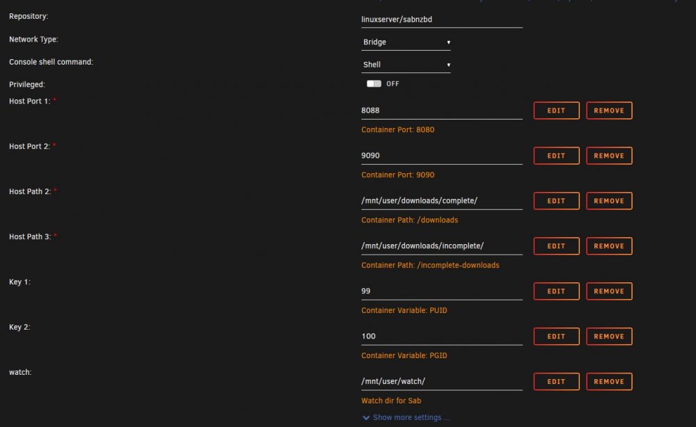

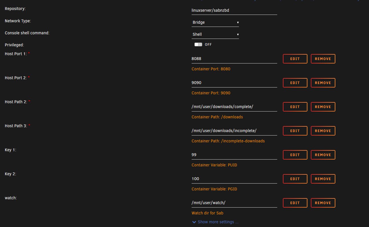

Having a weird issue with a new sab install.  it works fine but I cannot get it to point to the downloads folder I created in my user shares.
Its configured correctly in the docker settings and even created the complete and incomplete directories in the /mnt/user/download folder for me but when I download something it saves them in the config/download folder not /mnt/user/download.
Im trying to access the folder from a windows box and all the other ones work correctly which makes me think Ive not set something up incorrectly for sab.
Only way I can access the files is by sharing the appdata folder and  pulling the files from there.
Permissions for the download folder are set to 777 and the PUID is 99 and PGID 100.  The watch folder I created in my user share also works fine and sab picks the nzb's up.
Any ideas?
Makes me think so too
Lol I mangled that sentence didnt I!
Heres the backend config.
Post the docker run command and a screenshot of the paths settings page in sab.
Sussed it.  I didnt add the leading / to the download paths.  Working fine now.
Thanks for the help guys!!

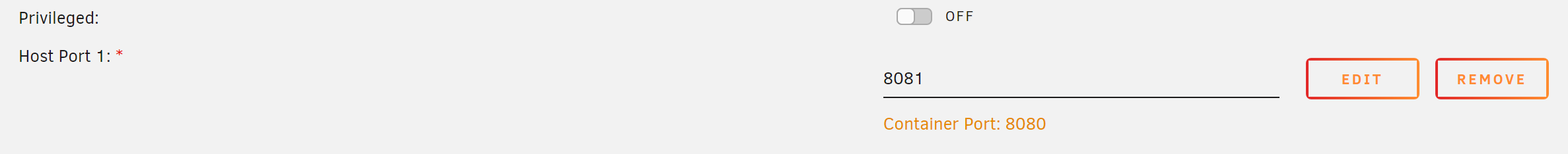

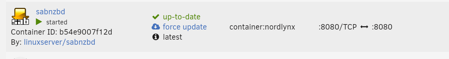

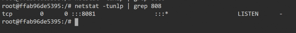

I have changed the port from 8080 to 8081 for my Sabnzbd container but unRAID still shows 8080. I am able to access it on 8081 as expected but for some reason it still shows 8080 on the unRAID screen. Anyone know what is wrong?
As soon as you take the container off of "bridge" mode (which you have), it uses whatever ports that it wants to (ie: what you've specified in the application itself.
What it looks like you're seeing is a GUI anomaly where because the port is still defined in the template it's still trying to display the mappings.  You can always just delete the port from the template screen.
I see. So for this container I am passing network to another container using --net:container=...
So then if I want to change the application's ports I have to do it from within the SabNZBD app, right?
