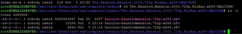

Hi,  Can anyone help with why SABnzb (this docker) downloads then extracts files without privileges for me to delete them please?
1 minute ago, sparklyballs said:
Can't believe I missed that! thanks Sparkly 🙂
