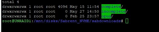

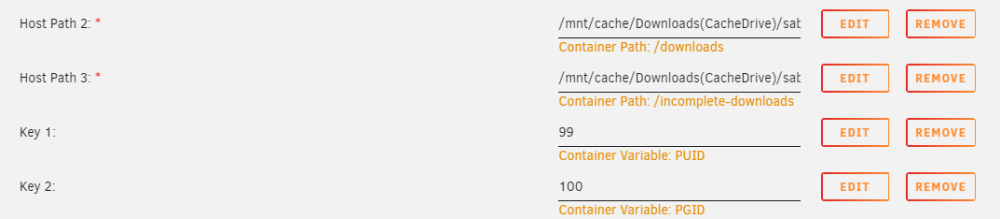

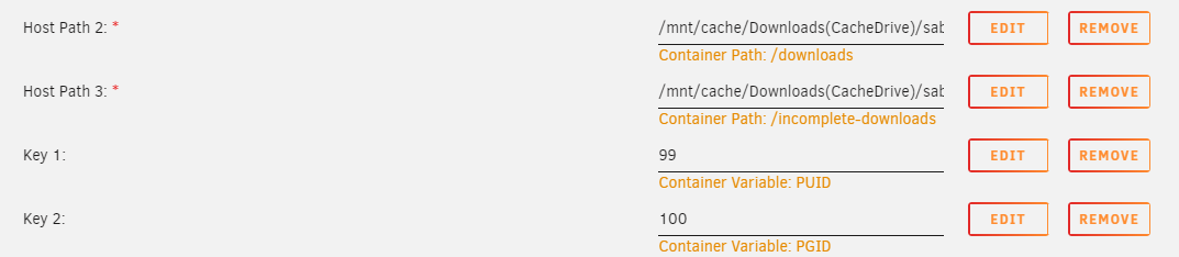

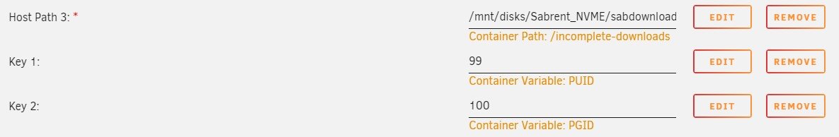

I have just replaced my download disk and now getting "Cannot change permissions of /downloads/incomplete"
I have deleted the folder and let the container re-create it and the permissions look fine, any ideas?

They need to be owned by user 99:100, not root
Thanks for the reply, as I said the container created the folder so not sure why it is not using 99:100 as it is in the template
The container doesn't touch media folders as they are not essential and they are user owned and managed. The container only fixes permissions on the config folder, which is essential for its own operations.

Ok, thank you for the info, I have found the command to change the UID & GID but what user does the sab container use?
99:100 you set that in the template as PUID/PGID
