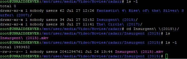

Hi, I am using this docker with great success thanks! but I just have one question....
Everything syncthing copies I do not have write access from my desktop pc? (access denied) I cannot find anywhere to change Syncthings permissions to allow this?  any pointers please?

Hi, Many thanks for your reply!
I have not changed the PUID or PGID within Syncthing and I have Syncthing copy files from my seedbox to my unRAID server into the media share. my user on unraid is what I use to connect to the shares from my Windows 10 PC which has read/write access to all my shares which I can delete/rename whatever to any files except those written by Syncthing?
Still can't say,  but the key is you need to start looking at the file permissions and identify what they actually are.  It might be inheriting them from the seedbox?  Once you work out what the file permissions/owner/group are then it makes identifing the cause easier.

Here is a screenshot of the files & folders created by Syncthing, does this help?
So, I don't know jack about windows smb permissions, but the owner & group look fine.   If Windows can RW files by nobody:users you should be good as on insugent you have 644 as a perm and parent directory is 744.

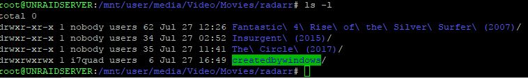

I just created a folder from my Windows machine in the same folder and I can see the difference in privilages just not sure where the problem lies..
OK, well that helps.  Files created by windows are as i7quad:users and existing permissions on the files you're having issues with are RWX for nobody R_X for the users, R_X for everyone else.
Now as both your Windows machine and your Syncthing files are owned by the same group, essentially it means your Windows box can read and execute files just not write.
I can't really help with the next bit, but as I see it, you have two options.
1.  Try and find a way to make your existing files RWX for the group, thus allowing Windows to write
2. Get Windows to access the files as nobody:users rather than i7quad:users
