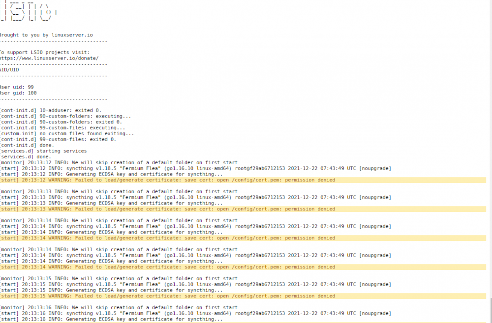

I'm having this same permissions issue.
I just ran DockerSafeNewPerms which fixed all the files created by syncthing, however, I can't modify new files created by syncthing.  Can I somehow pass to the docker to create the files as 777 or some such thing?
Worst off maybe schedule DockerSafeNewPerms to run daily at night... not an ideal solution.

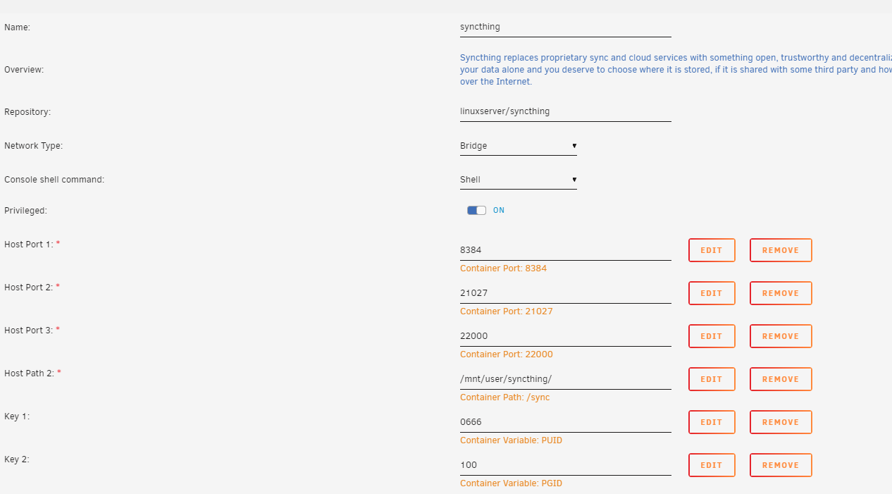

Hello
  I m having a problem or multiple ones to be honest. So I ll try to give out as much information as I can (I tried first to read some othr posts / documentations before posting but it seems I can t find a way to solve my problem - probably due to lack of knowledge). So here it goes
   I installed syncthing and during the installation form I filled in
the host path 2 with the  path /mnt/user/ (it was empty and beneath it mentions greyed out Container Path: /sync)
AppdataConfig Path-> /mnt/user/appdata/syncthing (the default one)
Should I have entered different paths?
Also shouldn't Krusader see the Sync installation path somewhere. I can't find it in none of the above paths I entered during installation
 I started syncthing and first thing to do is  set the already created folder Music Data Base which
Krusader can see it  in  this directory ->/media/Music Data Base
in unraid shares tab it uses this path -> /mnt/user/Music Data Base
Why 2 different paths for the same directory? Shouldnt all programs see it at the same place?

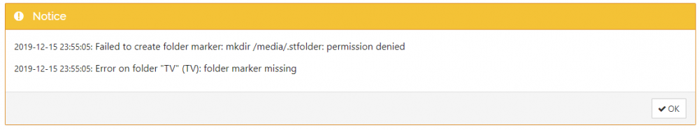

So in the share folder inside syncthing i typed /media/Music Data Base and during save got an error message
<<2019-02-08 12:03:55: Failed to create folder root directory mkdir /mnt/user: permission denied
2019-02-08 12:03:55: Error on folder "Muz" (s3xqe-civks): folder path missing>>
After that I tried /mnt/user/Music Data Base but with the same error message. Ok probably its straightforward what to do due to the message but still i can't figure out what to do
Any help would be highly appreciated!!!

You seem to not understand how docker and volume mappings works. Take a look in the Docker FAQ for a better understanding.
Your docker containers will only see the container path and not the host path.
So Krusader will not see syncthings /sync folder. For Krusader to see what syncthing sees in the /sync folder, you need to map the same host path to Krusader (/mnt/user/). Notice that the folder you see in Krusader will be whatever you set it to in the container path.

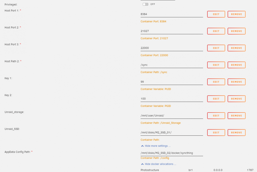

Simple question about Folder Path ...
In the Syncthing config, I set Host Path 2 to: /mnt/user/
When I create a folder to share, I set the folder path to: /config/Sync
If I understand correctly, that should be the same as /mnt/user/Sync
Do I have that right?
Cheers, Richard
Cheers, Richard
You have it wrong.
The default path inside the container is /sync. So it you added /mnt/user as the host path, /sync inside syncthing is /mnt/user on the host.
You can see the folder path inside the container under where you choose the host path. If it's not there, enable advanced view and click the Edit button for that volume mount.

Hi all,
I'm having an issue where everything connects, but there seems to be an issue of permissions. I have the log bellow. I have tried a lot of other folders and have the same issue. Private or not.

2019-12-15 20:55:05 Failed to create folder marker: mkdir /media/.stfolder: permission denied
2019-12-15 20:55:05 Ready to synchronize "TV" (TV) (receiveonly)
2019-12-15 20:55:05 Ready to synchronize "Default Folder" (default) (sendreceive)
2019-12-15 20:55:05 Overall send rate is unlimited, receive rate is unlimited
2019-12-15 20:55:05 Error on folder "TV" (TV): folder marker missing

So I have the TV set as private and only two users have access, I have tried to set the PUID to one of these users, but it seems to still set the user as 'root'.
Below are my settings in Syncthing. I have tried to add the TV folder here, but the docker fails to install.
Would love your thoughts. Im also very new to unraid and linux. So far learning lots. Thanks in advance!
Your PUID value is wrong... you have put the file permissions mask in, not the PUID - should be 99 I believe, on a normal unraid setup.
Thank you for the reply. I had it at 99 and it would still show the same issue. I have been playing around with it to see if it would change anything. I've read that the user syncthing is on doesn't have access to where i want the files transferred to. I'm wondering if there a way to give access to allow it read write access?
Where can I add the permission mask? you know what it should be?
Edited by Gursh
Hmmm... I don't know, sorry... your config looks about like mine, and mine has been working fine.
I have fits with permissions on unRaid for some reason - I wish it did things a bit more "standard" (at least as I understand standard), but...
Have you tried changing the permissions of your target directory?
Make sure all directories are 777 and files are 666, including (in your config) /mnt/user/syncthing itself?
And the ownership should match the 99/100 of PUID/PGID.
Otherwise, sorry, all I know to check.
