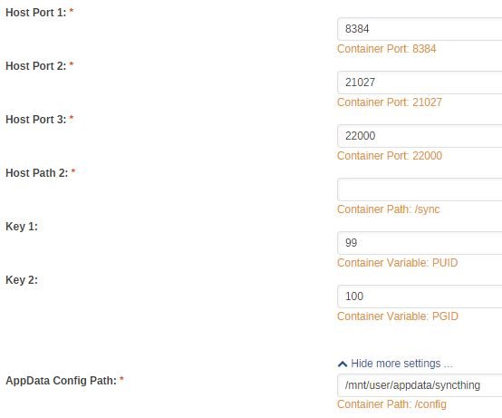

I see Host Path 2 in the edit screen, but not Host Path 1. What happened to Host Path 1? What should Host Path 2 be set to?
Here's a screen grab of a new install. No Host Path 1. Is this normal?
Yeah, don't worry about it. Just a naming problem rather than a serious issue. you may find the appdata is using host 1 and we've just renamed it

How about this: I want to sync /mnt/user/media. What do I put into:
Host Path 2
AppData Config Path
Folder Path (while Adding Folder)
Thanks.
Host Path 2 = /mnt/user/media
Appdata = wherever you keep your appdata in a subfolder called syncthing?  Generally this is auto completed for you based on settings in the docker section on Unraid
Folder path = container path = /whateveryouwanttocallit host path = /mnt/user/whateverlocationyouwant
