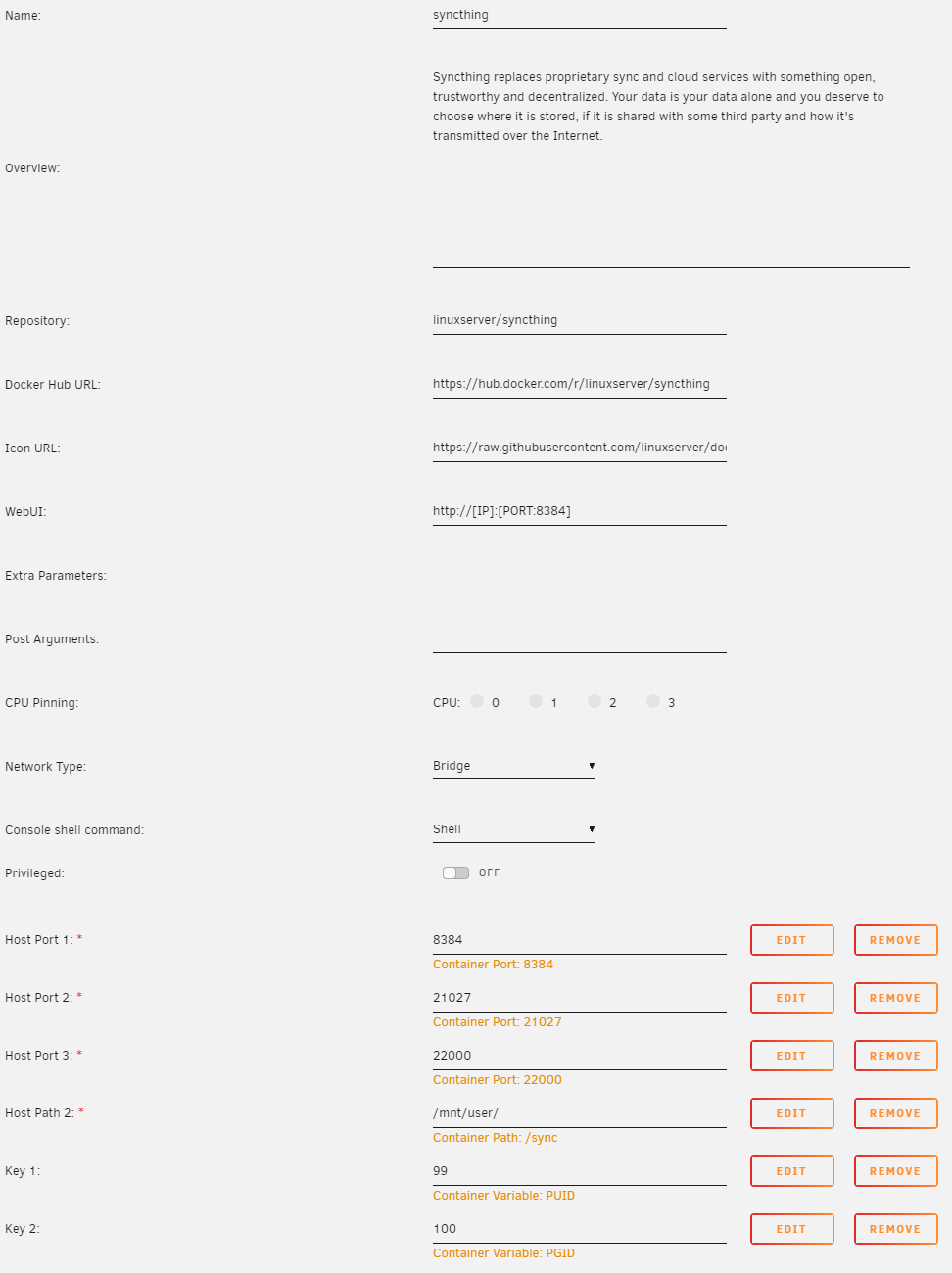

I want to backup my laptop documents on my NAS, like I did befor with my synology (with Drive)
I setup my syncthing folders this way in the container :
mnt/user/backups/BACKUP_XIAOMI_MI_AIR       > /sync
/mnt/user/appdata/syncthing                 > /config
The PUID / GUID are 99/100
I have no error messages (like I read in this thread, like permission issues)
The problem is : all the data I want to backup is stored in the config directory on my cache drive (which is now full ^^)
So the /sync folder is not used...
What am I doing wrong ?

Syncthing offers a default folder path that starts with config, which you need to remove
In the container configuration for my backup location, My Host Path 2 is:  /mnt/user/
In the Syncthing app, my folder path is: /sync/Backup/Richard
That puts the files into a share called Backup with a subfolder called Richard
Thanks a lot for your hints. It seems to be the right thing to do, but in my Syncthing app (via the webUI) I can't change the folder path, the input is grey :
So it's impossible for me to change /config/myfolder to /sync/myfolder

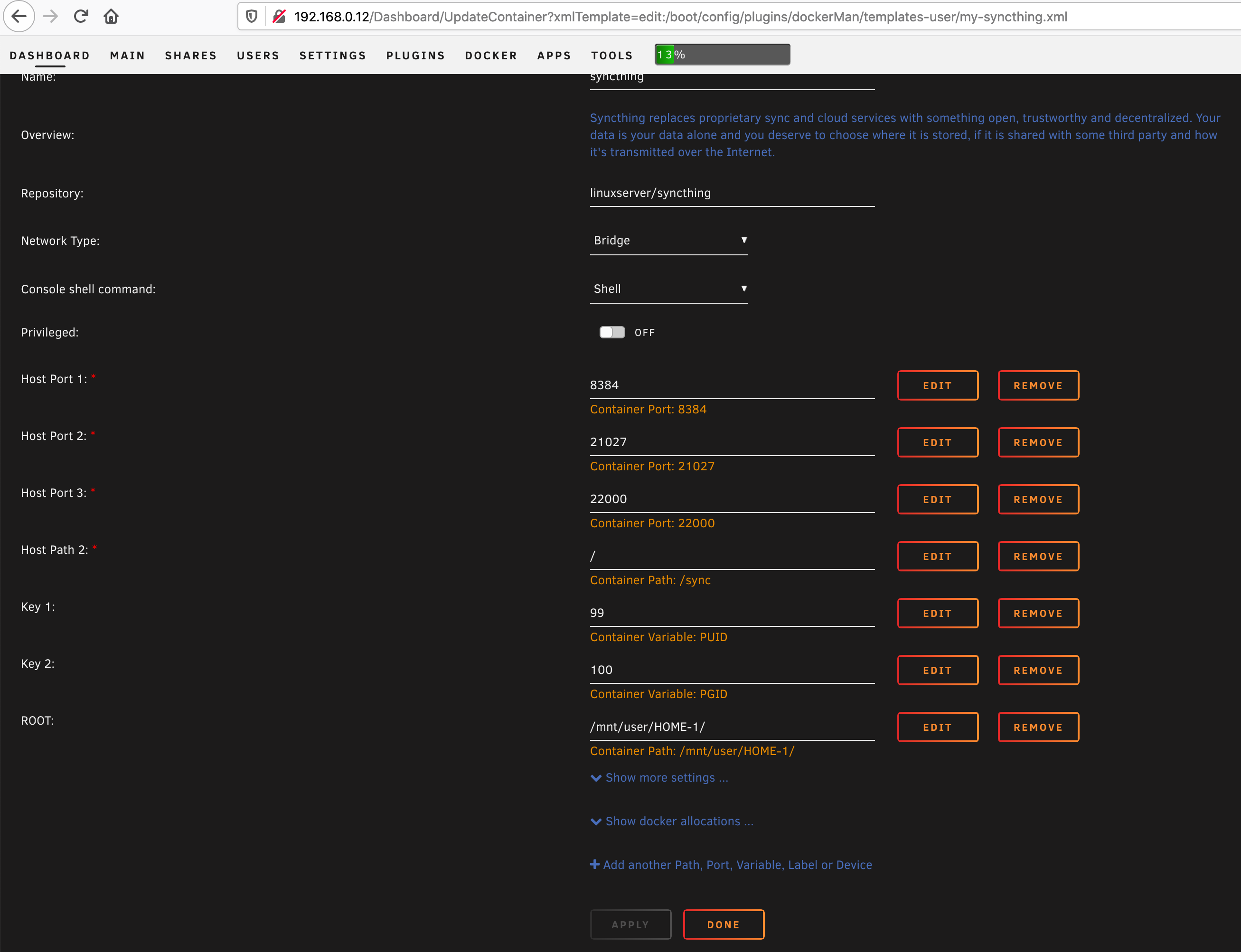

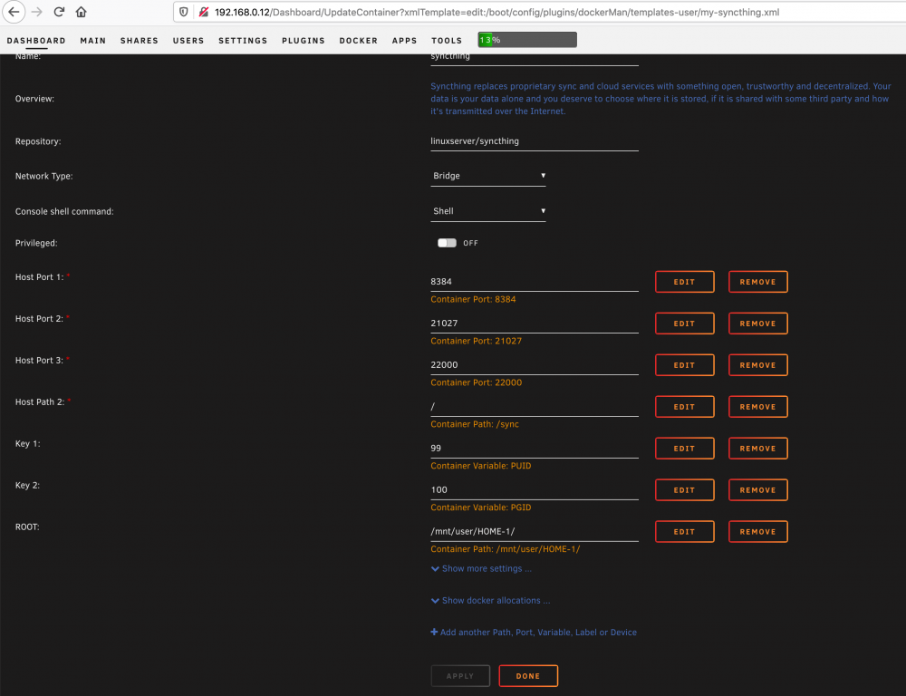

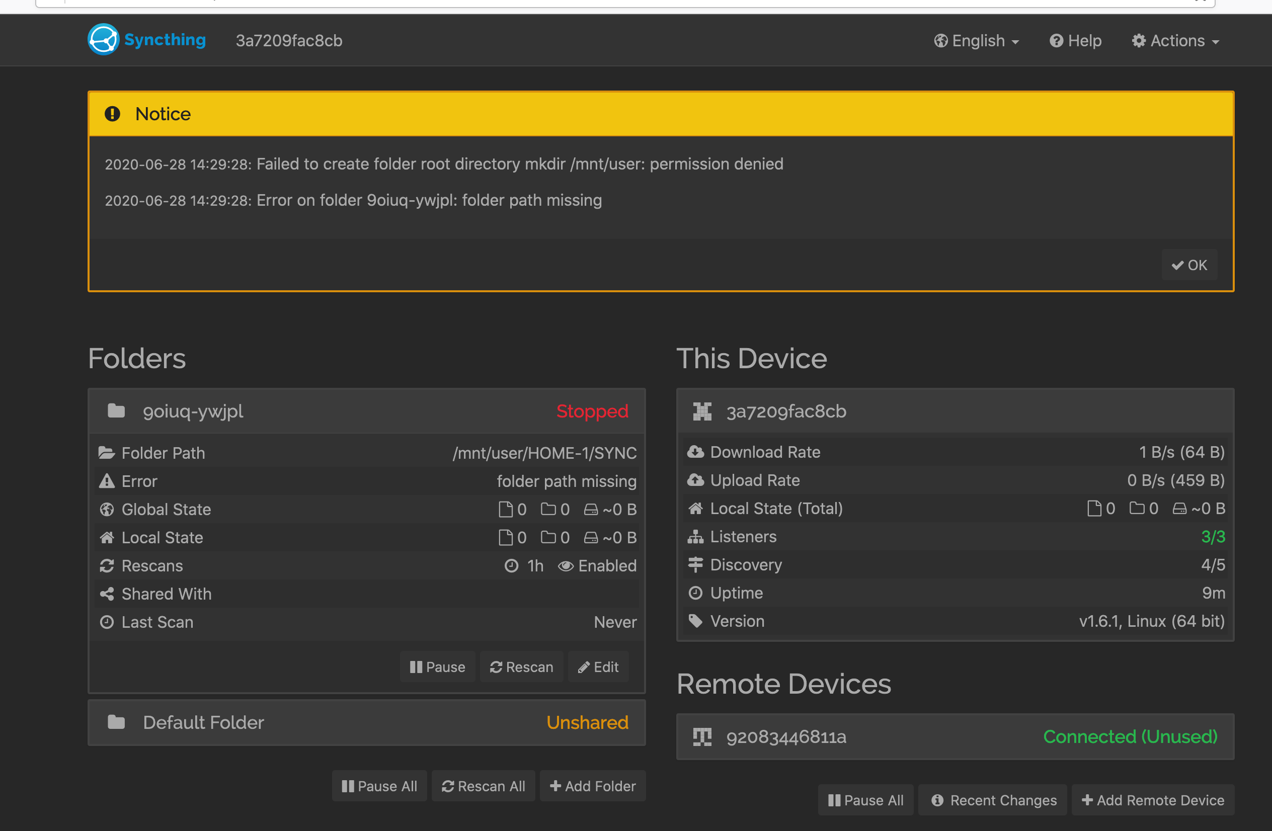

I think it has been asked here but I see no answer or guidance. I managed to setup Syncthing in 2 Unraid servers and they're talking to each other. Now this is not very clear.
How do I point Unraid 1 to an existing folder/share to sync it across to the Unraid 2?   Looks like permission issue to me?
Well found the solution to my own problem   You'd could just add extra Host Paths as required, in my case / ROOT and be done with it    Work perfect now.

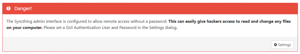

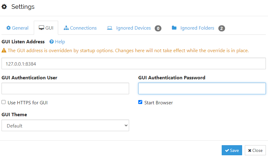

What can I change here:
To avoid getting this:
You can set the password in syncthing itself. Its in settings-GUI.
You're right! Thanks.
My mistake was thinking "Changes here will not take effect" applied to the whole page
