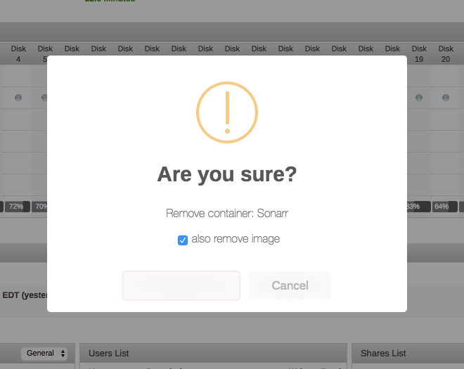

So now I have decided to remove the docker, but its stuck on removal.....not sure what else I can do but wait. Are there any commands I can run in the CLI to either remove the docker or do something?

Now I am trying to take the array offline and that is timing out, ugghhhhh. Is there a command to unmount the array or do you have to do it one disk at a time?
What do I put in place pf {WHATEVER} if I try to unmount the docker image?
The path to the docker image....  ie: /mnt/user/docker.img or /mnt/user/appdata/docker.img, etc

Wondering if someone can advise me on next steps.
Are you just trying to power down now?
I am trying to take the array offline gracefully so i can reboot. Last night I did a hard reset and I want to avoid doing that if at all possible.
