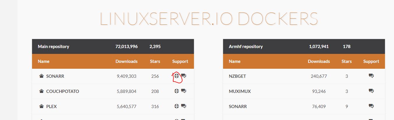

strange... the support link from linuxserver.io is what sent me here.
I can't even get Sonarr or Radarr to even start. I've tried deleting the database file and letting it recreate it, but that didn't work. Permissions are sane. Other containers stored in the same location work without issue. I opened the database with an SQlite3 browser and it's not corrupt, it just doesn't contain any data.
