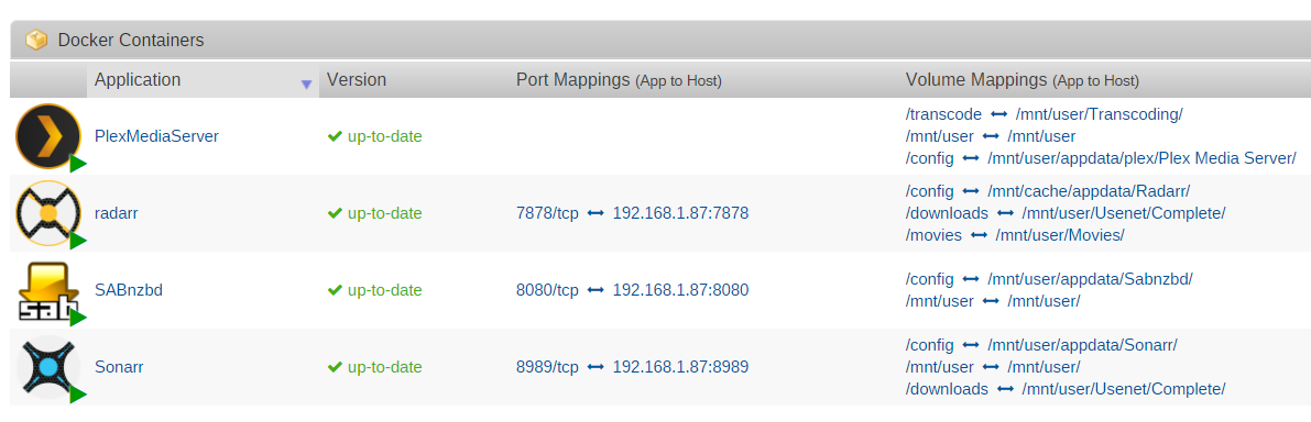

  • When deluge is finished, it's telling Sonarr that the file is stored in /data/completed/..., but you don't have /data/completed mapped to /downloads/completed on sonarr or radar  Add that mapping, and

    I left /data and /config alone, deleted /media and created /mnt ( = /mnt) for Sonarr, Radarr and qBitTorrentvpn.

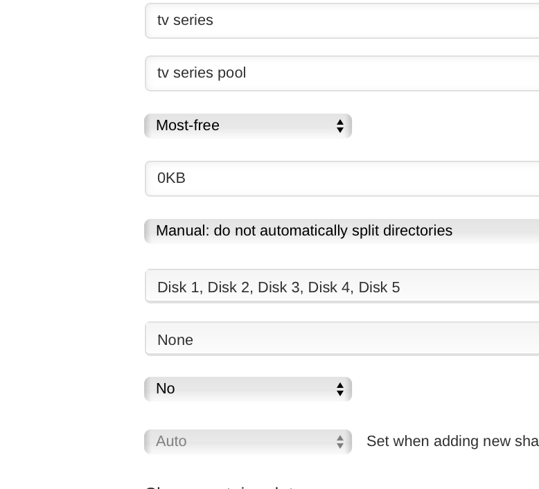

Hi Squid, I solved the problem!
When searching I'll find out that some episodes did get imported. Episodes begin with A --> M was no problem, but episodes beginning with N --> Z did not get imported, and gave the message disk full. The problem was I only selected disk1, disk2, disk3 in the disk included checkbox. So I also selected disk4 and disk5 and problem solved!!! :)

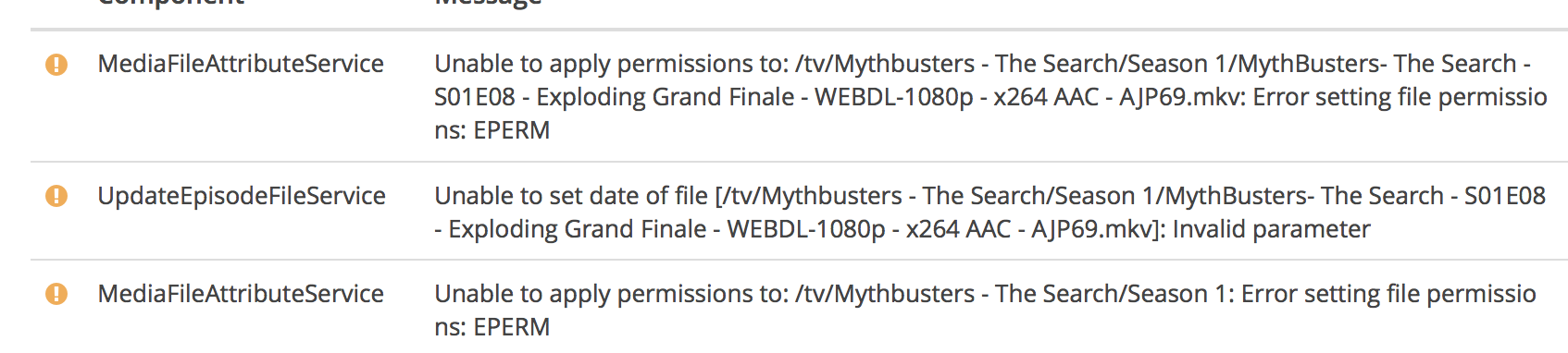

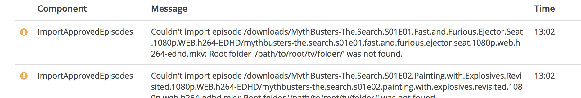

I have a bit of a weird situation. Sonarr is complaining about a missing root folder, but if I check by entering the sonarr container there is no problem. If I go into the "tv" folder I see all of my tv shows. This tv show folder is mounted with unassigned devices. The only differences I see is that the owner is "root:root" and not "abc:users" which is the case with the "downloads" folder. Any idea?
Edited by MvL
Go to the offending series, "mb - the search" in this example, and edit it. Change the series location to one that actually exists in the docker's view.
Hi Jonathan,
That was a great suggestion. It solved the problem! Never tough about doing this with the offending series. I did go to the series editor, and selected the root tv folder for all series, but that didn't helped.
I still have a problem with permission I'll see the error in the screenshot. I'm not sure if it is possible to set permission, and if it is necessary cause if I'm correct it's already 0777. I also see this behaviour with headphones.
