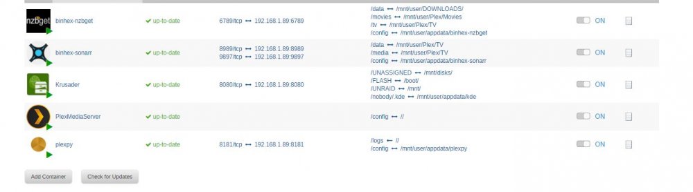

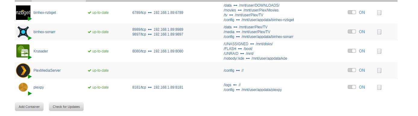

I believe this is a sonarr side of things issue, but I'm using sonarr with nzbget. I can get a show to download episodes and put them in the right folder however sonarr cannot import them to rename and place them in the right folder. Right now I have it setup so files will be put into the /tv directory since I use a Series category in nzbget that sonarr is set to use. What happens now is that each episode I download will have its own folder placed in /mnt/user/Plex/Tv and inside the folder will be a single mkv file with a nonsense name. Sonarr will say /tv/"folder name" has no files found are eligible for import. I'm sure it's a simple fix but I'm not having much luck with it.
https://forums.lime-technology.com/topic/57181-real-docker-faq/?page=2#comment-566086

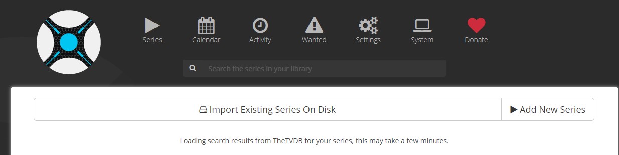

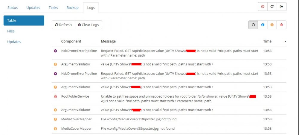

Hello everyone!
I've searched a lot but I haven't found the solution to my problem with Sonarr and I hope you can help me :)
For some reason Sonnar won't add any serie it it's watch list. Nothing happens
- If I add the serie by Importing (Add series -> Import existing from Disk ) it just says: Loading search results from TheTVDB for your series, this may take a few minutes.
(screenshot_1jpg)
- If I search for the serie and then click on the Plus sign, it loads for 1-2 sec and then changed back and nothing happens.
I don't find anything in the log
 (Screenshot_2.jpg)
Sonarr config: Screenshot_3.jpg
Sonarr Log: Screenshot_4.jpg
Thank you!

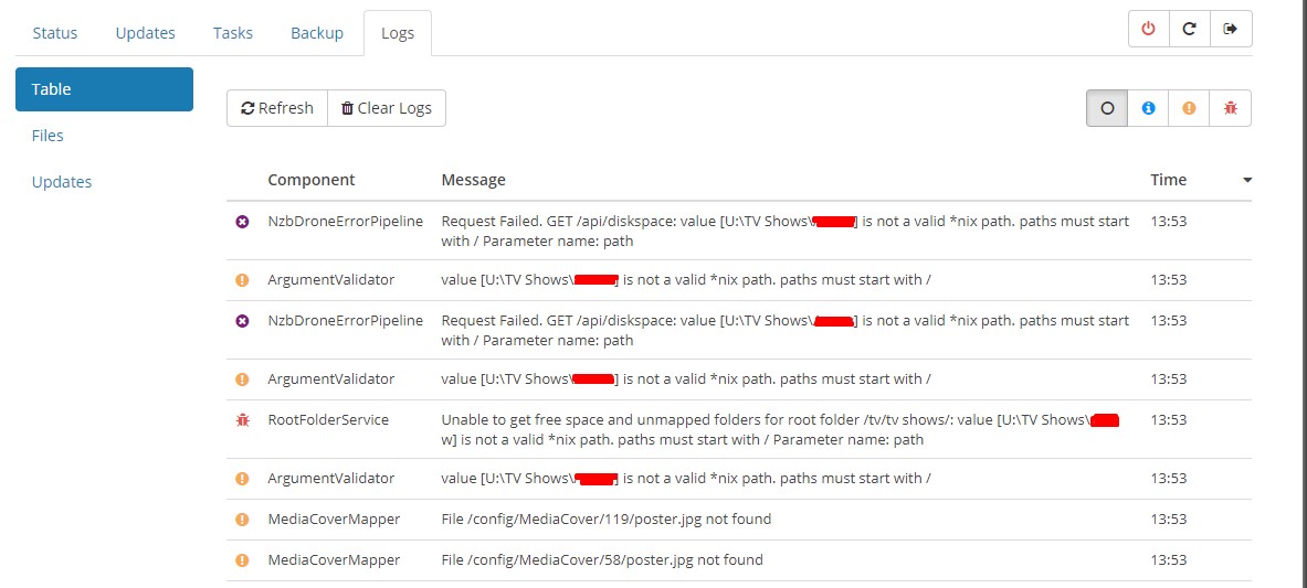

1 hour ago, Muff said:
Hello everyone!
(screenshot_1jpg)
 (Screenshot_2.jpg)
Thank you!
Based on the errors, the incorrect setting is what you've got within the setting for the show etc.  The show's setting is trying to save to U:\TV shows....   Change that and everything will start working.
I'm trying to add a serie that I have already moved to the new setup/location.
The serie in the logg aren't the same as the on I'm trying to add.
and this is my config:
so it's showing the wrong series in the logs?  Implies you selected the wrong series when you added it, unless I'm reading your post wrong
Yes, it's showing another serie and that is probably because Sonarr do a search in alphabetical order since the serie in the log starts with "A" and the serie I try to add starts with "P".
And when I posted the log I wanted to show that there were no entry in the log when I tried to add a serie.
Edited by Muff

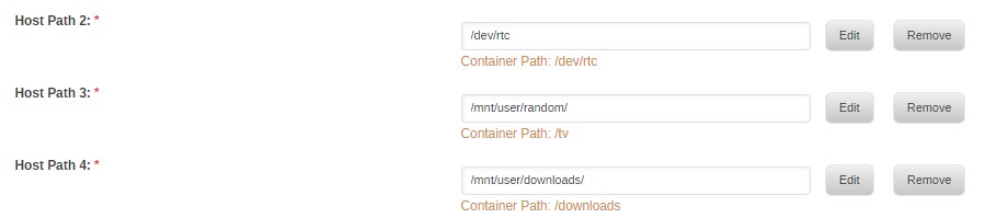

Hi again,
I tired to change the root folder for \tv
from: /mnt/user/random
to: /mnt/user/random/tv shows/
But that didn't help at all.
I also tried to edit an existing serie but Sonarr acted the same way as when I tried to add a new serie/tv show.
Any idé? Or should I just re-install Sonarr and don't import/restore the config?
