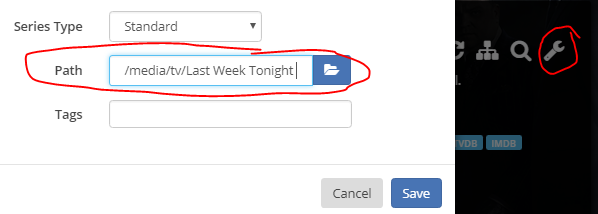

Unfortunately I don't even see /media in the settings in Sonarr.  I suspect it is a mapping based on the container values.  Based on the error, /media should be the "tv" folder in the container setting.  Very odd.
You have the containers mapped with /media pointing to your media share but the error says Sonarr tried to put the file into /tv. You either have to change the containers and replace /media with /tv and make sure the server side direction does point to the TV location on the server. Otherwise, set Sonarr to put the file into /media.  In Sonarr, go to the Series page and then click the wrench icon for the Last Week Tonight series to see  the path.
If all series have the wrong path it'd be easier to just change the mapping.

You have a similar issue as clearzero, sonarr is trying to write in the wrong place. lionelhutz gave the right explanation.
Take a look at the sonarr log: Access to the path "/tv/....
And in your sonarr, you defines /dev/rtc, /media, /download and /config.  Sonarr has no idea what /tv is.
Either define /tv to /mnt/user/whatever in the sonarr container options or in your series, go in options and save them to the path /media/tv/Last Week Toni...
Creating the mapping in the sonarr container parameters is probably a *lot* less clicks

Ugh... yeah, that was it.  Corrected the path and I'm good to go.  Thanks!

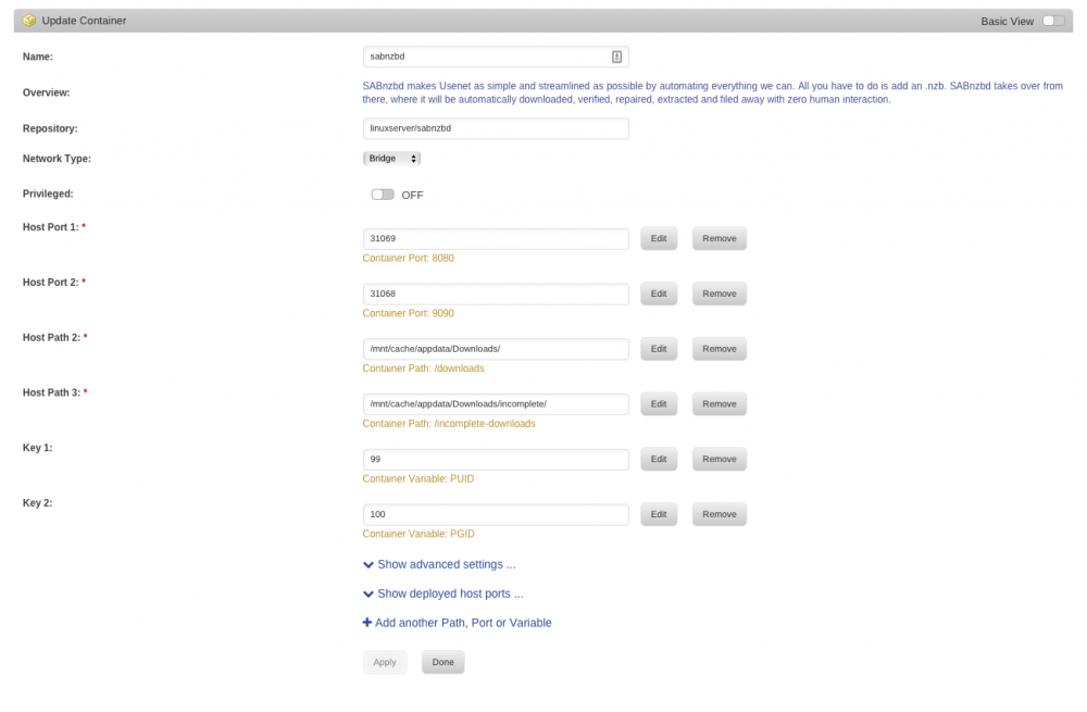

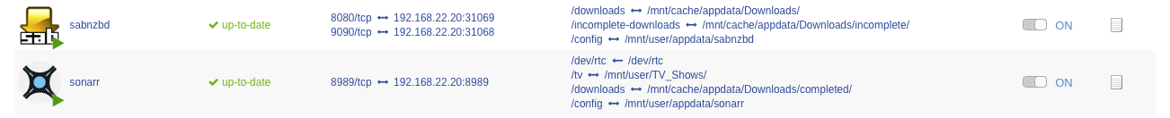

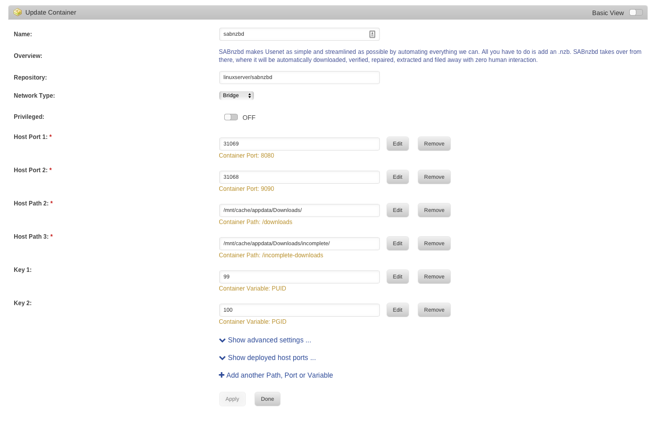

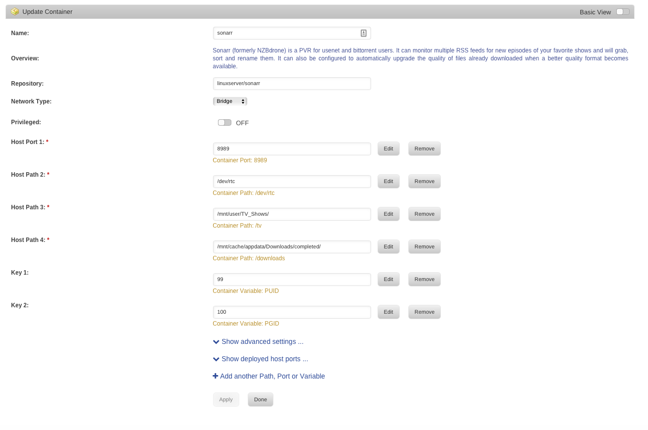

Trying to figure out why a shared folder, mapped outside the containers is not allowing files to be moved by Sonarr?
Sabnzbd pulls the file, sorts it to redo obfuscation and sonarr and sabnzbd are both pointing at the same directory...
Sonarr just shows it as downloaded (purple bar) and never moves the file.

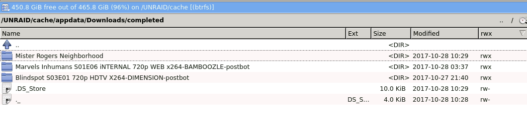

Only thing left is that after sonarr takes the info, it's not deleting the file from the completed folder.  it's like it's copying it and not removing the original.
@mkyb14, I'm going to give you exactly what you need to put in for all your download paths, copy in exactly what I type. (only copy the parts that start with "/mnt/user/...")
sabNZBd:
/downloads-complete --> /mnt/user/Downloads/complete
/downloads-incomplete --> /mnt/user/Downloads/incomplete
Sonarr (and radarr):
/data --> /mnt/user/Downloads/
Deluge (Host Path #2):
Just make sure the Cache option for your "Downloads" share it set to "Yes"
Edited by MowMdown
^^^^^^^^^^^^^^ Don't use that because it will not work. It must be like below. BOTH the container and unRAID sides have to be exactly the same for it to work.
FOR ALL      /downloads --> /mnt/user/Downloads/
Point completed downloads in SAB to /downloads/complete and incomplete downloads to /downloads/incomplete.
When incomplete downloads are in the Downloads share you can just delete this because it's pointless to have it in the container.
That’s all dependent on who’s container you use. Binhex uses just one, /data,
LSIO uses both it appears
so yes you need to specifiy completed and incomplete
