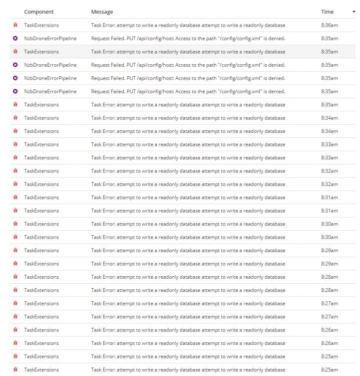

Having a few issues with this container it has been working for ages then 7 days ago it stopped working, its still running but none of the automated tasks are running, it doesn't send requests to look for new episodes, it isn't recognising when new episodes are added to the array and also the log file hasn't been updated in 7 days. Any thoughts?
So in the log shown in the docker window this is repeated god knows how many times:
[v2.0.0.5163] System.Data.SQLite.SQLiteException (0x80004005): attempt to write a readonly database

[Error] TaskExtensions: Task Error
But in the log section in the actual docker it shows it not having been updated for 7 days?
Edited by Connor Moloney
not just me then.
Same issues, fixes with reboot but doesn't last long before playing up again.
Docker run commands please, you're the only two reports of this that we've seen, nothing in Discord or Github about it.

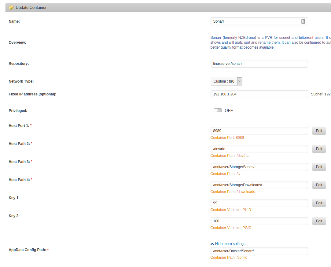

Stopping container: sonarr
Successfully stopped container 'sonarr'
Removing container: sonarr
Successfully removed container 'sonarr'
Command:root@localhost:# /usr/local/emhttp/plugins/dynamix.docker.manager/scripts/docker run -d --name='sonarr' --net='bridge' -e TZ="Europe/London" -e HOST_OS="unRAID" -e 'PUID'='99' -e 'PGID'='100' -p '8989:8989/tcp' -v '/dev/rtc':'/dev/rtc':'ro' -v '/mnt/user/Media/TV Shows/':'/tv':'rw' -v '/mnt/disks/192.168.1.72_My_Pc_-_Spare_Storage/Movies/completed/':'/downloads':'rw,slave' -v '/mnt/cache/appdata/sonarr':'/config':'rw' 'linuxserver/sonarr'
dfa8aadc778577e64943c3ac6fc3a814925d814b2eda5fd9be4a90ed98e52abe
The command finished successfully!

Have you run "New Perms" or changed permissions on your Unraid box at all?  Just a hunch.
Try running these two commands and posting the output of the second one.
docker exec -it sonarr bash
ls -la /config
18 minutes ago, CHBMB said:
My gut feeling looking at those logs is some sort of database corruption tbh.  SQLite is readonly which is a problem.
You may want to grab some debug logs and post over at the Sonarr forums, I'm not as convinced as @saarg that the remote mount is the issue, although it's a possibility.  Be interesting to see @hayleraid's logs etc because until we see them, to assume it's the same problem is a little too speculative for my liking.
Oh I was not convinced, but the only thing I noticed from looking at the docker run command.
