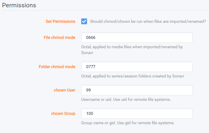

Or it might be a Permissions issue that stops Sonarr from deleting them on the Unraid server?

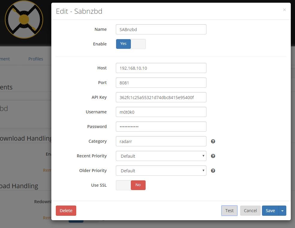

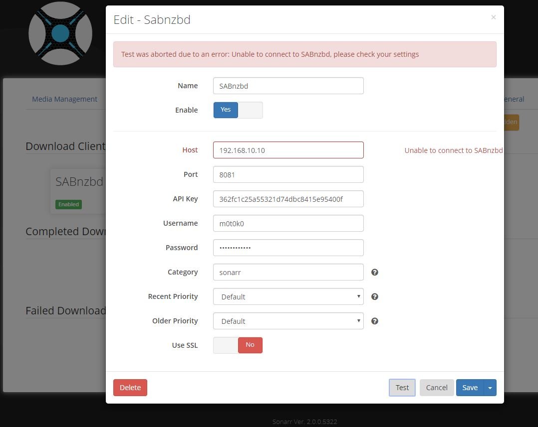

I noticed today Sonarr is unable to contact SABnzbd. I don't know how long it has been like this maybe a couple of weeks max.
I have both Sonarr and Radarr setup the same, Radarr no problem.
Any help with this would be greatly appreciated.
Here is what seems to be the relevant bit from the debug log.
[v2.0.0.5322] NzbDrone.Core.Download.Clients.DownloadClientException: Unable to connect to SABnzbd, please check your settings ---> NzbDrone.Common.Http.HttpException: HTTP request failed: [404:NotFound] at [http://192.168.10.10:8081/362fc1c25a55321d74dbc8415e95400f/api?mode=addfile&cat=sonarr&priority=-100&apikey=(removed)&output=json]
