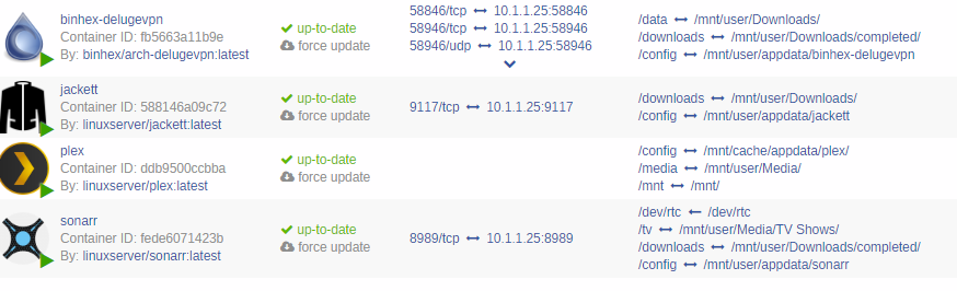

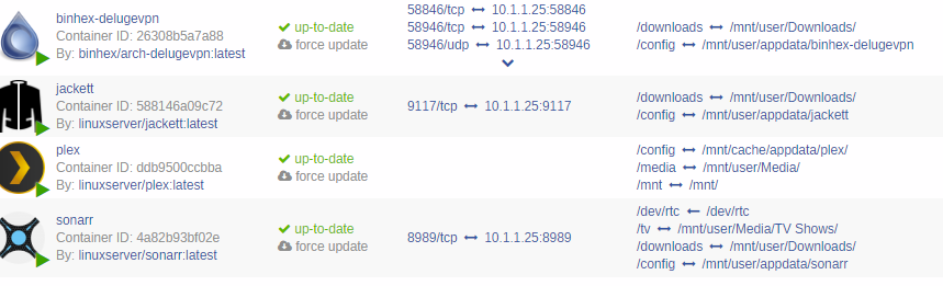

  • When deluge is finished, it's telling Sonarr that the file is stored in /data/completed/..., but you don't have /data/completed mapped to /downloads/completed on sonarr or radar  Add that mapping, and
  • JonathanM
    JonathanM
    You misunderstand parity protection as it applies to single disks. The mdX devices are protected by parity, so there is no difference in protection whether you use /mnt/user/appdata or /mnt/diskX/appd
  • thatsthefrickenlightning
    I left /data and /config alone, deleted /media and created /mnt ( = /mnt) for Sonarr, Radarr and qBitTorrentvpn.

Help with paths.
I had my system working fine but now that I was required to start over I can't get the configuration to work. I've been trying since yesterday -- tried googling and keep finding things I think will resolve the issue but it doesn't. Hoping someone will be nice enough to help me.
Everything works up to the point where Deluge doesn't signal back to Sonarr that the torrent is finished and ready to move.
165075169_2018-11-2714_06_52-Castle_Docker.png.908691d7ee944ab2c83459989ccb3aa2.png897119686_2018-11-2714_07_08-Deluge_WebUI1.3_15.png.acdeb4b8d5e416aef5b7b723a6c84156.png
Obviously, there is something that I am not getting and I've tried a dozen variations and none of them work for me.
13 minutes ago, Naldinho said:
Help with paths.
If that 2nd screenshot is from sonarr, the 1st screenshot doesn't have any sonarr mapping for /data. Do you understand container volume mappings?

I thought I had a basic understanding of it but apparently not given how I am struggling with this. I am under the impression that my goal is to get both mappings to match which they do in the above configuration. Completed downloads are put in /downloads by Deluge which is mapped to /mnt/user/Downloads/completed/ in Deluge and in Sonnar /downloads is also mapped to /mnt/user/Downloads/completed/

2 hours ago, Squid said:
I believe I had already tried that and it didn't work for me. I think that is what I have setup here
So, is that 2nd screenshot from sonarr or from one of the other applications?
1 minute ago, trurl said:
I don't actually use any of these dockers myself. Whether they work together is one thing. Whether sonarr will work at all is what I was getting at with this:
The second screenshot is from Deluge
I have changed things a few times since then but at that time the Deluge setting for Completed was set to /downloads which I has mapped to /mnt/user/Downloads/completed/ and in Sonarr I mapped /downloads to /mnt/user/Downloads/completed/ so my understanding is Deluge would tell Sonarr the file is downloaded and in /downloads and then Sonarr would go to the same place
