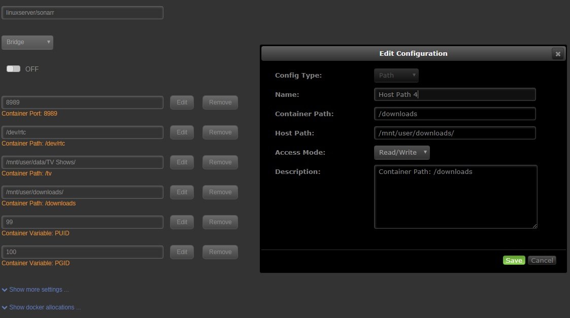

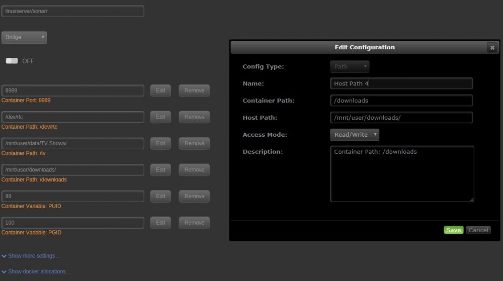

Okay. I gotta add my 2 cents because I'm going rather insane. Years ago when I set my server up I was using binhex for things like sab and couch potato and whatever. Awhile back, I decided to switch to the linuxserver versions. It seemed to go well for awhile...and yet I had trouble getting my movies from the downloads folder into my actual movie folder. Well, I decided I would try to fix that. I moved to Radarr and moved everything to linuxserver thinking that the mappings would be easier that way. Now neither my tv nor my movies will go from the completed downloads to folders where they are supposed to go.  I've made it WORSE!!!!
And it's driving me nuts. I've been reading page after page here and I've tried quite a few things but I cannot get it to work. I really don't want to have to nix my docker and start from scratch. There's just too much information there. But if I have to delete all the sonarr, radarr, sab and whatever else....I will. I'll even try nzbget. I just really want to fix this. It's a massive hassled to come to this thing every night and put everything in it's place.
So thank you in advance whoever is willing to help.

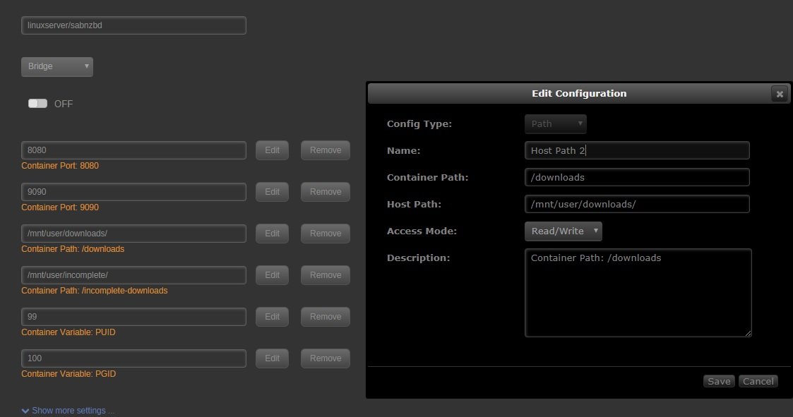

The mappings are as follows: Sab, Sonarr, Radarr.
What are your settings in the folders tab in sabnzbd?
Also run docker safe permissions just to eliminate that as a potential issue.
But what is the error message from Sonarr / Radarr?  It'll be there in its logs
Default Base Folder: /config
Temporary Download Folder BrowseLocation to store unprocessed downloads.
Can only be changed when queue is empty.
Minimum Free Space for Temporary Download FolderAuto-pause when free space is beneath this value.
In bytes, optionally follow with K,M,G,T. For example: "800M" or "8G"
Completed Download Folder Browse
There are those settings, jj. I'm not sure how to run docker safe permissions, but I would be very happy to.
