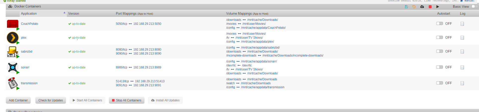

I'm stumped. I reinstalled Sonarr from scratch by mistake and seem to have missed a setting somewhere. (Couchpotato is working perfectly with sabnzb)
Sonarr is having a few issues:
1. It isn't downloading episodes of watched shows. When I manually click search the episode is added to sabnzb.
2. Under activity are 28 episodes that I already. I can see them when I search through my server and I can watch them on plex. When I try to search it says it can't find the file and when I try to remove them sonarr readds them.
3. I'm getting tons of errors
Import failed, path does not exist or is not accessible by Sonarr:
Attached are a sonarr log file and a screenshot of my docker mappings.
I don't see anything obvious with the mappings and am not sure where to look next. Can anyone help?
sonarr.txt
Why have you pulled the /downloads directory out from underneath where SAB (and everything else for Usenet) wants to be downloaded ? I don't know if that's necessarily the issue but it's better to keep it simple and inside the box if you aren't quite sure what you're doing. There's a reason why SAB has categories and separates things like movies and TV shows
Edited by mikedpitt420
I'm not sure what you're suggesting?
In a normal Usenet SAB / Sonarr / Couch(Radarr) scenario your downloaded files end up in /mnt/cache/appdata/sabnzbd/config/Downloads or somewhere underneath /mnt/cache/appdata/sabnzbd/
Again, I'm not saying this is your issue, just seems overly complicated for no reason is all
I was using this setup before. Do you have any advice on what I should change my settings to use the Downloads share I have created?
No. I try to use the programs as they're intended to avoid things like this. I don't think these mappings are an issue, I may be wrong. I am a mod on a fairly decent sized indexer. I advise loads of people each day how to setup their automation. KISS rings true all the time. Don't try to go outside the box unless you know what you're doing. Again, this may have squat to do with this issue but you aren't making it easier on yourself going outside normal directory conventions. I would just use the downloads folder as it's intended in its' intended place for what it's worth. See if that works, it's worth a try
ryanth - your docker container mappings are fine except I would dump the mapping to incomplete-downloads. It just isn't necessary and makes it more confusing. The container already has access to /mnt/cache/Downloads via the /downloads mapping, so there is no reason to map another directory below that. Most people put the complete and incomplete downloads all into a Downloads share so I have no idea why that SAB container has that extra /incomplete-downloads mapping point.
It might be a Folders setting in SAB. In SAB, do you have the temporary download folder set to /downloads/incomplete and the complete downloads folder set to /downloads/complete? You can change the incomplete and complete names if you want, but don't deviate from the /downloads/ part because it must be there to use the mapped Downloads share. Otherwise, the downloads can end up in /config which is /mnt/cache/appdata/sabnzbd on the unRAID side.
Once SAB does a download, check that the file is in the complete directory in the Downloads share. If you use categories then it will be in the category directory. If it's not there, then you still have the folder settings in SAB set wrong.
mikedputt4120 - if you want to know why I do it, it is so I can share the Downloads as public for reading and writing over the network but NOT share the appdata share at all so it can't get messed up. It is also simpler to get to the downloads when the downloads are in their own share. Besides, It's not outside the box for these Docker containers, but rather quite a normal setup.
