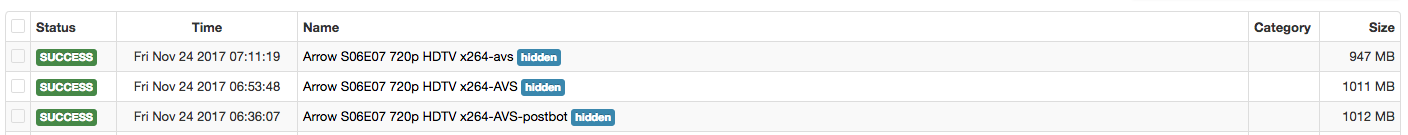

I have a weird problem that has started happening when using Sonarr with NZBGET.  It's "downloading" several TV shows over and over, yet nothing appears in my folders and Sonarr shows them as complete, see below :
This is what is shown in Sonarrs logs for one of the attempts. See the attached screenshot for Sonarrs history. Any ideas? I don't think its downloading it but why is it being marked as complete in Sonarr?
Cheers folks, love yas!
17-11-24 06:50:20.5|Info|RssSyncService|RSS Sync Completed. Reports found: 950, Reports grabbed: 0
17-11-24 06:54:24.7|Info|NzbSearchService|Searching 9 indexers for [Arrow : S06E07]
17-11-24 06:54:41.1|Info|DownloadDecisionMaker|Processing 12 releases
17-11-24 06:54:43.6|Info|Nzbget|Adding report [Arrow.S06E07.720p.HDTV.x264-AVS] to the queue.
17-11-24 06:54:43.8|Warn|ProcessDownloadDecisions|Couldn't add report to download queue. Arrow.S06E07.720p.HDTV.x264-AVS
[v2.0.0.5054] NzbDrone.Core.Download.Clients.DownloadClientException: Failed to add nzb Arrow.S06E07.720p.HDTV.x264-AVS.nzb
  at NzbDrone.Core.Download.Clients.Nzbget.Nzbget.AddFromNzbFile (NzbDrone.Core.Parser.Model.RemoteEpisode remoteEpisode, System.String filename, System.Byte[] fileContent) [0x00068] in M:\BuildAgent\work\b69c1fe19bfc2c38\src\NzbDrone.Core\Download\Clients\Nzbget\Nzbget.cs:50
  at NzbDrone.Core.Download.UsenetClientBase`1[TSettings].Download (NzbDrone.Core.Parser.Model.RemoteEpisode remoteEpisode) [0x0016c] in M:\BuildAgent\work\b69c1fe19bfc2c38\src\NzbDrone.Core\Download\UsenetClientBase.cs:74
  at NzbDrone.Core.Download.DownloadService.DownloadReport (NzbDrone.Core.Parser.Model.RemoteEpisode remoteEpisode) [0x001a3] in M:\BuildAgent\work\b69c1fe19bfc2c38\src\NzbDrone.Core\Download\DownloadService.cs:74
  at NzbDrone.Core.Download.ProcessDownloadDecisions.ProcessDecisions (System.Collections.Generic.List`1[T] decisions) [0x000dd] in M:\BuildAgent\work\b69c1fe19bfc2c38\src\NzbDrone.Core\Download\ProcessDownloadDecisions.cs:76

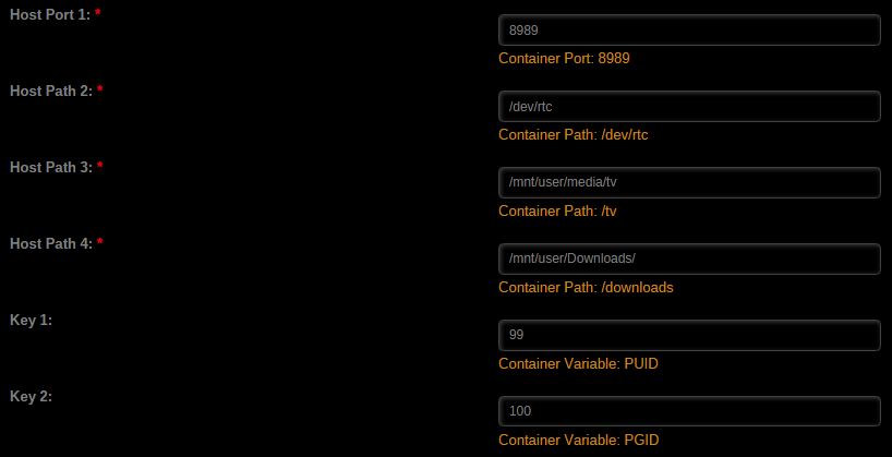

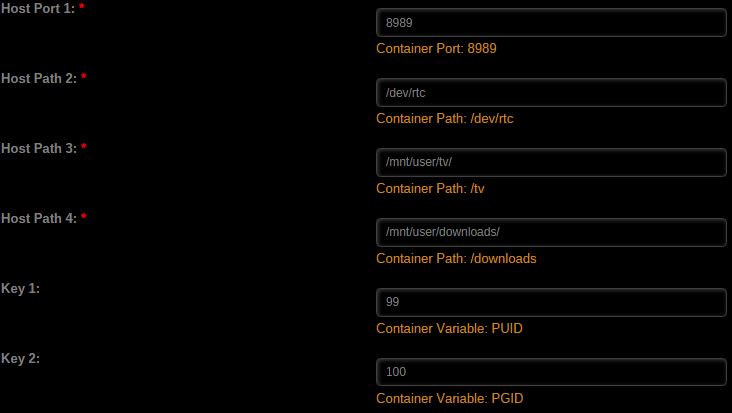

Guys I've got a weird problem and I cant spot where my mistake is. Sonarr is all of a sudden refusing to move my shows. It gives me an error saying the path does not exist. Now I can move them manually myself but thats not really the point now is it. Can anyone see where Ive went wrong? Can't see it whatsoever. Would anyone be able to help?2.thumb.png.bcbda42889977ed4708c6499d06d786d.png2.thumb.png.e5693151180d7bb09b4eabba55c8cc77.png
MagicSG1, do you have a folder in UnRAID named /mnt/cache/Downloads/complete/tv? Make sure you pay special attention to the 's' on 'Downloads'. Sometimes people don't notice a download/downloads mis-match.
No, unfortunately that doesn't seem to be it. ?
Have you tried to go in the sonarr container and see what's visible?
I don't know how familiar you are with the CLI but you could try this from a putty session:
docker exec -it Sonarr bash
cd /data/complete/tv
ls -al

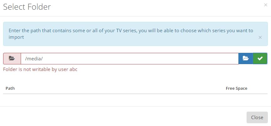

Just installed Sonarr and I'm getting an error while try to select the folder path:
I'm assuming I screwed up the paths in the settings, but I can't figure out the correct settings
You have to use the same path as in the container path in the template. So it should be /tv/
Thanks that fixed it!

Hey all, so I'm having another problem in Sonarr which I can't seem to fix. After a download I'm getting this error
Import failed, path does not exist or is not accessible by Sonarr
I'm thinking it may have to do with how I've did my folder paths, but again I can't see the problem.
EDIT: Here is also how I did my deluge folder pathing if that helps:
Edited by spacepirate
added information
Sonarr is going to read the file deluge downloaded from the same path as in deluge.  In this case, the file in deluge is in /data
Add /data -> /mnt/user/downloads in the sonarr parameters, Sonarr will find the downloaded file in /data and copy/move it to /tv
