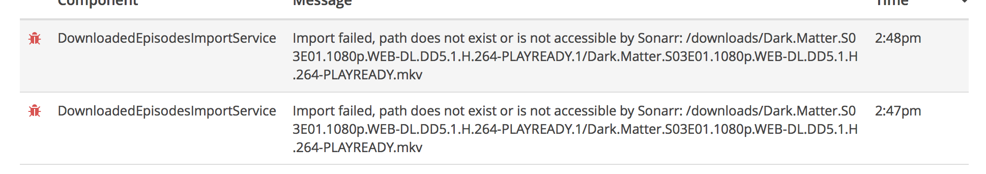

I'm not sure if this is the right location to post this, but I'm having trouble with Sonarr not wanting to move/rename files after they download.
So I've been working on this for a while but I just can't get my docker setup for deluge, sonarr, and radarr to work correctly.
So I can go into Sonarr and pick an episode to download, and it will successfully send it to deluge to download it, but then when it finished it will stay in Deluge. The problem is is that Sonarr wont grab the files to rename it and move it to the correct location.
The log for Sonarr says:
[Error] DownloadedEpisodesImportService: Import failed, path does not exist or is not accessible by Sonarr: /data/complete/Breaking Bad S05E16 REPACK HDTV x264-ASAP[ettv]
Here is an image of my volume mappings for my dockers:
If I could get some help with this that'd be great, as I can't seem to figure it out.
If you need any more info just let me know!

  • When deluge is finished, it's telling Sonarr that the file is stored in /data/completed/..., but you don't have /data/completed mapped to /downloads/completed on sonarr or radar  Add that mapping, and

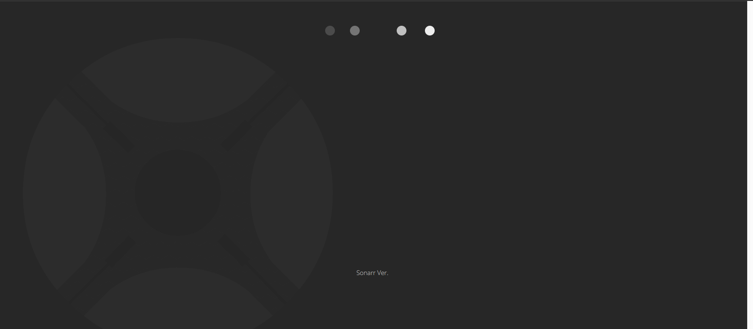

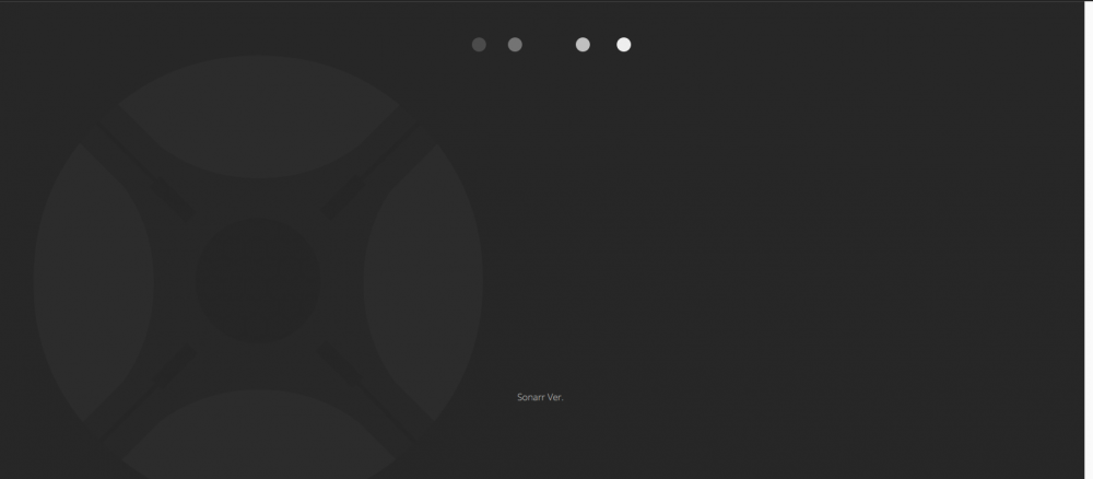

as of today since adding an SSD to the array and forcing it for all my appdata shares (to free up cache drive pool) I am no longer able to load the sonarr gui...it stays at the bouncing white balls going back and forth indefinitely....this is happening on my Mac and a Windows VM hosted on Unraid 6.3.4
not sure whats going on so changed the appdata share back to use Cache and invoked the mover nothing moved. sonarr still wont load. having no issues with any of my other 7 dockers..i even tried the binhex Sonarr and it works. but I want my config back over 200 shows were on it and it took hours to set up :)
any help would be greatly appreciated
Edited by Can0nfan
added some additional info
just a quick update....I noticed shortly after writing my previous post that my Unifi Docker app would constantly tell me my user/pass was incorrect (verified with copy and paste on unifi.ubnt.com just to be sure i was indeed using the correct info)
I deleted both Sonarr and Unifi and then used the CA Clean up App Data to purge the old docker files. reinstalled both set unifi back up in no time and took the hour or so getting sonarr back up. appears i had some corrupted data that somehow only impacted my two Linuxservers docker apps...hmm

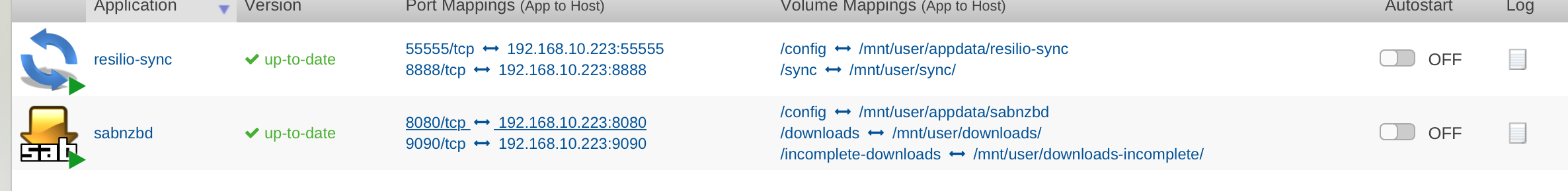

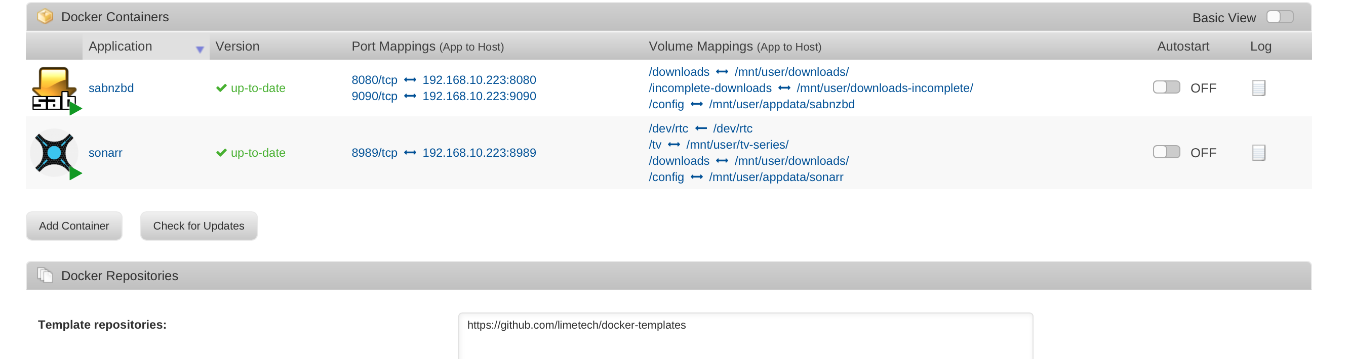

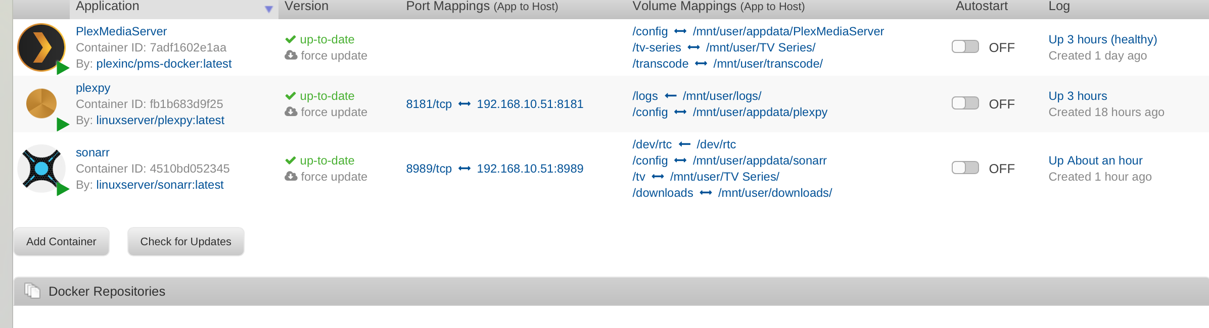

I have some trouble with the mapping, and I'm not sure why.. I've made some screenshots to clarify.

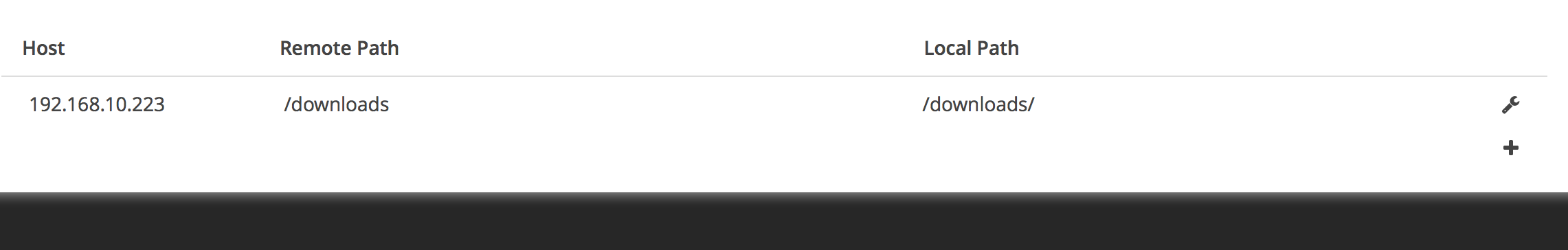

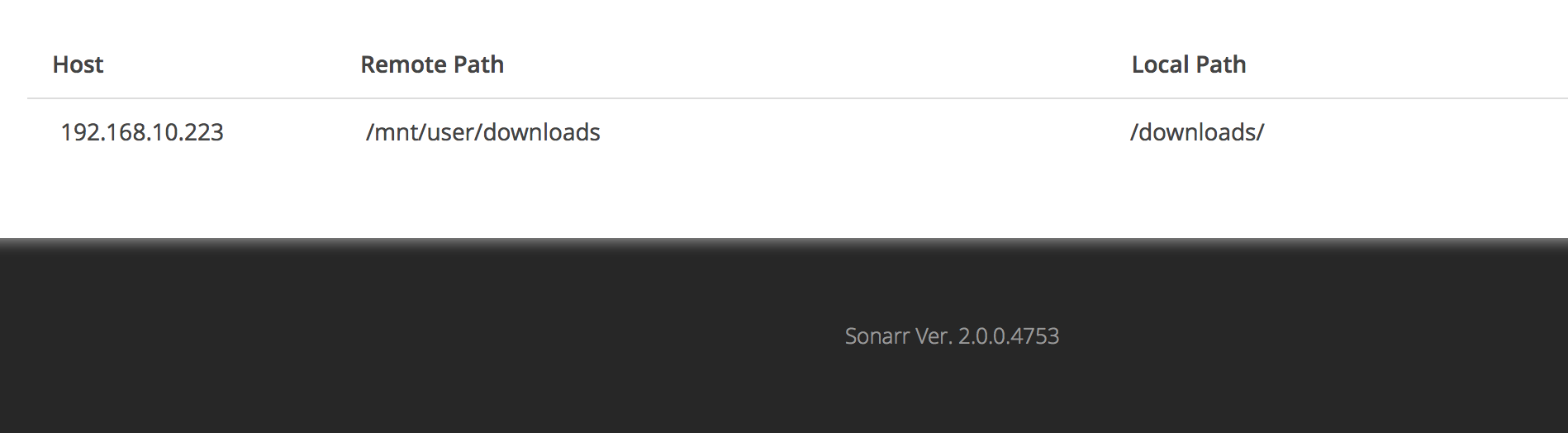

Don't add as a remote path in Sonarr. Add as a local path /downloads

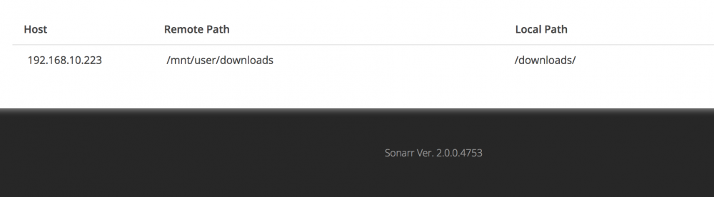

Hi CHBMB, Thank you for the reply. I already tried that, and I'm not sure why it isn't working. I changed it back to (see screenshot).
You're still entering it under Remote Path remove that completely.
/downloads isn't a remote path, it's a local path, enter it like this:

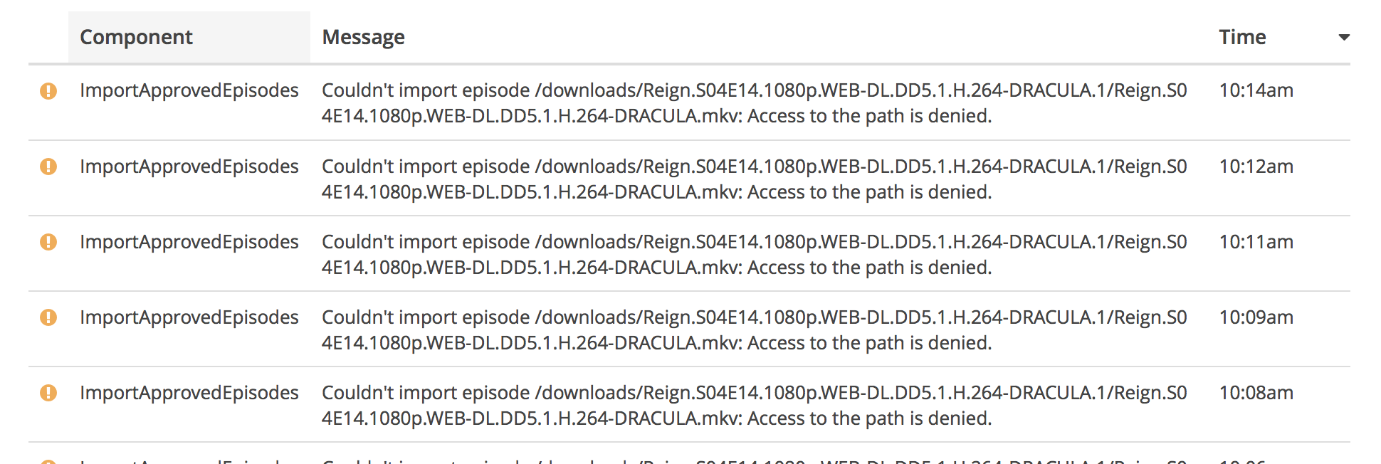

Hi CHBMB, sorry for the late reply. The reason I've changed my setup. I have now 2 unRAID server so SABnzbd is running on a different server as Sonarr. Some screenshots below. So I think in this situation I must use the remote path in Sonarr, but I'm not sure how I have to set this...
Edited by MvL
Use Unassigned Devices to mount the downloads share from SAB onto the Sonarr server.  Then pass that path over to Sonarr.  Then use drone factory with a local path to monitor it.
Thank you for your help.

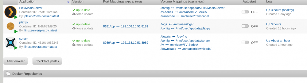

I experimented a bit tonight. I installed sonarr on the same server as sabnzbd and I installed sonarr on the other server. When I installed sonarr on the same server as sabnzbd I mounted the tv series directory. When I installed sonarr on the other server I mounted the downloads directory. I used the unassigned drives plugin as suggested. Cool plugin btw. I did not set a remote path with Sonarr. With both options I receive the message below (see screenshot). Not sure how to solve this.
Pick one of your two options, and post all relevant screenshots with your new settings / template
It's getting late, but I will do this tomorrow evening when I come home from work. If you have some to assist tomorrow then I will be grateful. Thank you for the fast reply's.
