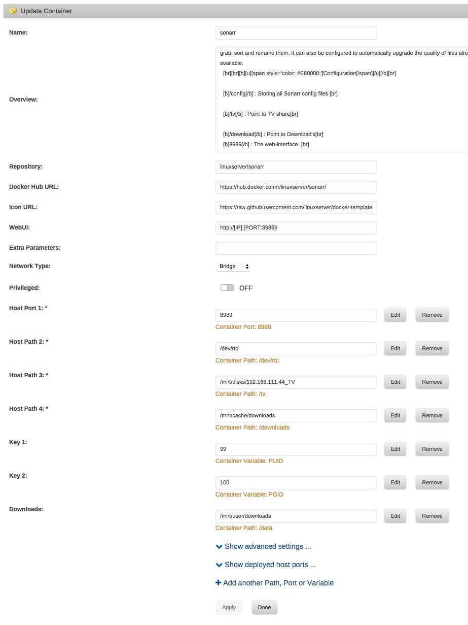

Here is a screen shot of the docker settings. At the moment I can't bring up the web ui of the docker, it won't load, it just spins and spins trying to load.

There's your problem @ashman70
Your host path 3 for TV.
Do you have another server as a samba mount at that point? Are you not using your unraid as your fileserver?
Mine is set to
/mnt/user/TV
As this is the root directory of my TV share.
Additionally, since the mount for path 3 is done via UD and is external to your server, the mappings must be set to RW:SLAVE (edit the path on the template, and change the access mode)
So yes I have a Samba share mounted to another server, the idea is that Sonarr will send a download request to sabNZB who will in turn download the file then it will get copied to the Samba share. It was working ok until Sonarr started screwing up and I had two hard resets of my server, then I removed the Sonarr docker and added it back and now its messing up again.

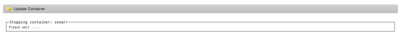

Ok I edited the edited the mappings Squid, unRAID is now trying to stop the docker to apply them......
This is where I am for the past 5 minutes. Is there a command to forcibly stop the container?
So now I have a blinking cursor at the command prompt on the server after I entered the command docker kill sonarr.
I can't do a hard reset at the moment because I am at about 60% on a parity check......great
ok that got be back to the command prompt, anything I should type now?
not really  docker kill should've stopped the container.  Wait til the par check is done...
It didn't the sonarr docker/container is still running.

I have a docker/container I can't stop and because of this I can't unmount my array cleanly and because of this I have to do a dirty shutdown and reboot. Oh and the webui for sonarr won't load either.
Suggestions?
