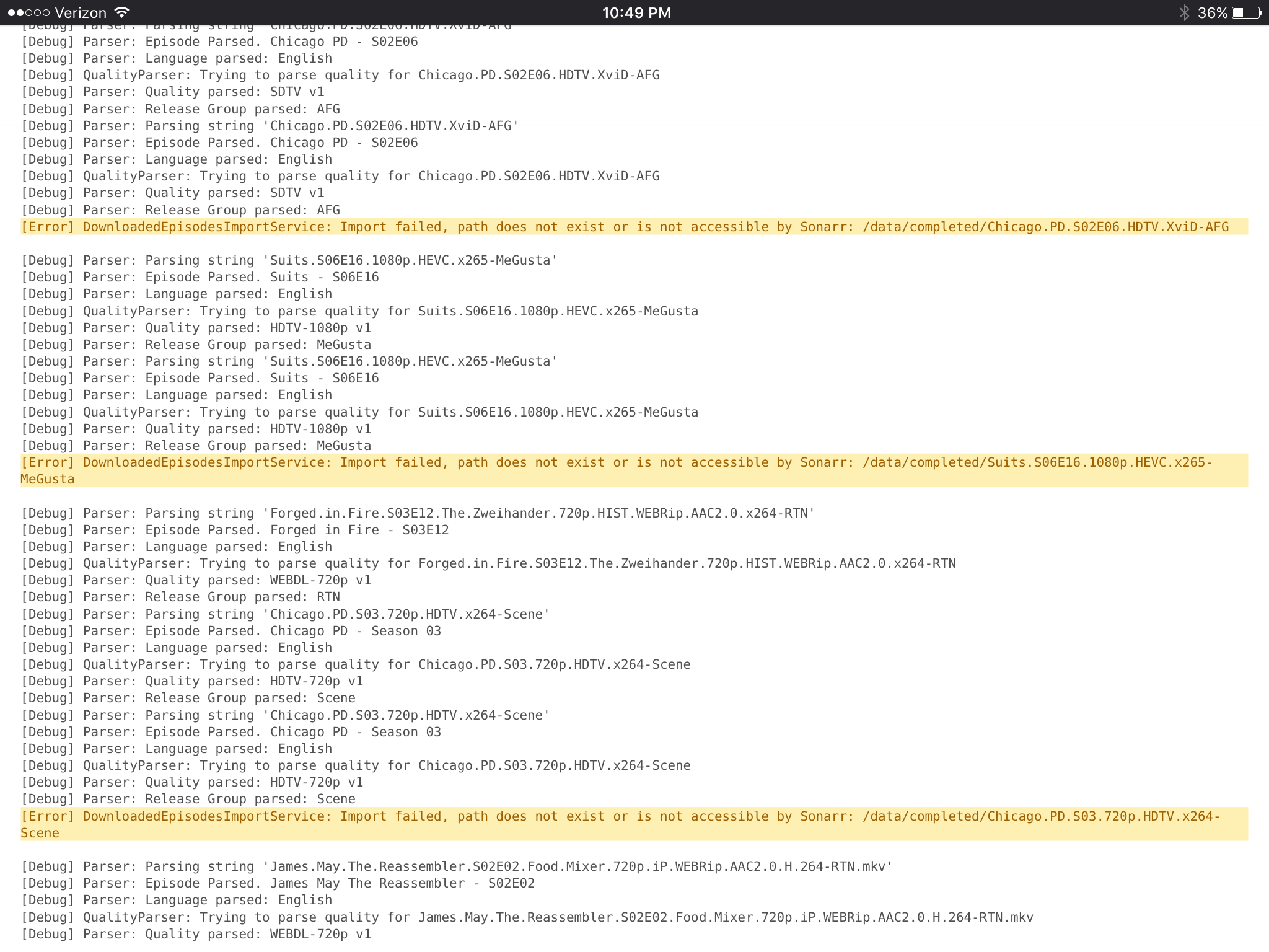

  • When deluge is finished, it's telling Sonarr that the file is stored in /data/completed/..., but you don't have /data/completed mapped to /downloads/completed on sonarr or radar  Add that mapping, and

Alright, my apologies i am not understanding, so you are saying that the issue is with the container mappings and not the host path mappings, so if i add a /Complete mapping that points to /mnt/user/Downloads/completed, even though the only thing that is different is the container mapping, which if i understand unraid correctly, should not matter between containers because they are sandboxed away from each other. Thanks

The host and guest directories need to be the same. You gave the wrong mappings at first, but I also didn't notice the host mappings were not the same. So my first answer was incorrect based on the incorrect mapping you gave but correct based on the correct mapping. If you're still not following that, it's not important. Just trying to explain my error. The bottom line is the guest and host mappings need to be the same (or use the Sonarr remote mapping feature). The host mappings need to be the same in order to link the guests together, and the guest directories need to be the same or the two guests will both have access to the same host directory, but refer the directory by different names. Got it?

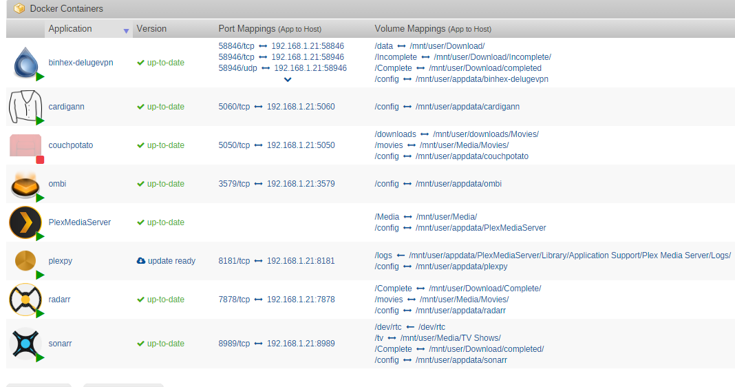

Alright so i have changed the mappings so that they should be set up as you both have stated. The attached image shows that the mapping have been changed. So if i understand what you guys are saying everything should work correctly now? Is there a way for me to tell sonarr to check that folder to test if this is working correctly?
That doesn't look correct, no. Download folders should all be mapped to the same location. More info is in the docker FAQ.
Sonarr and deluge are mounted the same. Radarr is not though. It should work for Sonarr.

99% of the time problems with imports and renaming is that the volume mapping for the downloads folder within sab and sonarr have to match exactly on both apps -> both the host side and the container side.
