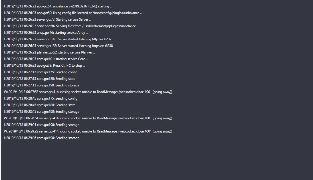

Having the same issue as well...  unbalance wont run unless started from a command line...

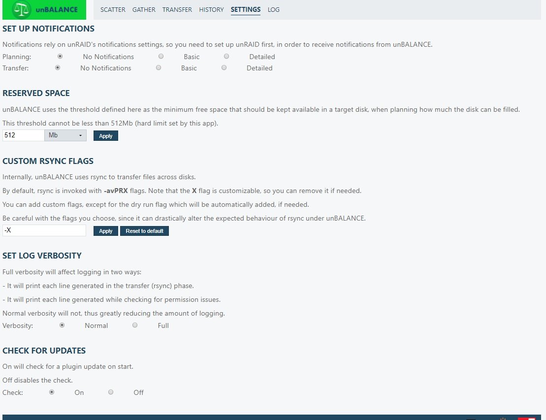

Also, I've been having this problem for a while now...  unbalance is set to use port 6237,
and yet when I try to open it using said port, it won't run... However, if I run it using
port 6238, it works fine...  Am I missing something here?  I've attached image files
and the log in the hopes this can be fixed...

RGauld, I think what's happening is that when you started it from the webui, it redirected you to the secure port (6238) behind the scenes, for the time being, you have to point it to the appropriate port manually
So, in the unbalance settings on the settings page, should I change it from 6237 to 6238?
I think it means you should go to 6238 instead of 6237 (but dont change anything)
