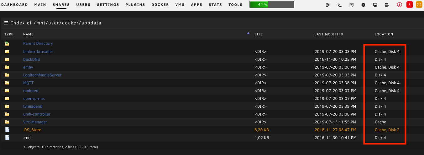

Would be grateful if someone could advise what I'm doing wrong here as I cannot quite grasp how unbalance is dealing with folders....
My Cache drive is failing and I want to move off a number of files/folders resident there. My docker share is set to all disks with cache preferred. so the files are scattered across several disks, but mainly on cache. I want to consolidate them to a single disk, swap out the cache, and move the dockers folder back.
I changed my dockers share to disk 4 only and set cache to no. The share has about 2GB of data in it.
I selected the Dockers share folder in unBalance for a Gather operation. After a period of thinking, it offered top move only 14kB of data. On checking, I see that my docker share contains 2x items, an Appdata folder and an OSX .DS_store file. unBalance seems to want to move the file , and ignores the folder.
I proceeded to try again, selecting only the Appdata folder this time. Again, it offered to move any files inside this top level folder, but was ignoring the sub folders.
Is this how it works?
I went ahead and selected each folder inside Appdata individually and executed the move. Now, what its done is moved some folders entirely, some folders are partially moved (contents now on either disk 4 or remaining on cache) or some folders were not moved at all.
No permissions or other errors were displayed in unValance and there's TBs of space on disk 4.
Do I have a fundamental misunderstanding of how unBalance is supposed to work? The OP says it can be used to move files or folders, but it seems to be very selective about what folders it's willing to move. Why would it not move everything inside a selected parent folder?
Here's what I've ended up with after asking unBalance to gather all the appdata folders to Disk4;

I'm not really sure what the issue might have been.
If you want to send the log (/boot/logs/unbalance.log), I'll take a look at it.
Unbalance is probably not the correct tool for the immediate issue of the failing cache drive. I would disable dockers and vm's in settings, set any shares with data on the cache drive to cache:yes, run the mover, then check the cache drive for any remaining files.
Cache: no is definitely the incorrect option here, as mover won't touch shares with that option set.
Heres the log. Though I did follow @jonathanm's advice and that cleared the remaining files off.
Maybe you'll spot something in the log.
Am I correct to assume that selecting a directory should move any files and sub-directories therein?
It should move all files/sub-folders that fit into the target disks you choose.
If some files/folders don't fit, it won't move them and send an email informing about this (if you have notifications on).

You'll need to remove data from the source disk manually (please note I'm referring to disks, not user shares).
2 hours ago, Hennie said:
I chose move but I don't see the files being removed from the disk
Move is implemented by a copy then delete, to protect your source data in case the copy fails for whatever reason.
This is normal behaviour.
14 hours ago, jbrodriguez said:
Your issue will be that once the copy is finished, the data will exist in both the target and the source disk.
