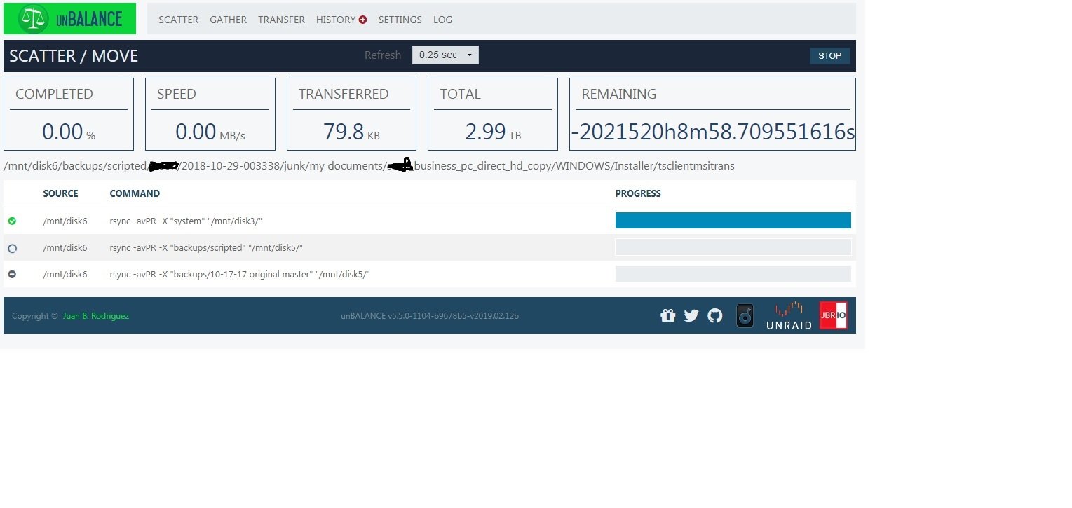

Something doesn't look right, but I can't put my finger on it 😆
I think the values are held in float64 types, so an overflow seems hard to achieve, but it certainly looks like it 🤣 🤷‍♂️

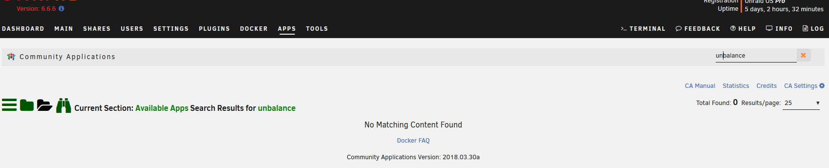

I went to the Apps section and did a search for 'unbalance' and nothing is found ?
Edited by fschris
Hmmm.  Shows up for me searching on that term.  I am not sure if it matters, but it looks like you might not have the latest version of CA.  That's an older version in your screenshot.
Edited by Hoopster
That version is over a year old. You should make sure ALL your plugins are up-to-date.

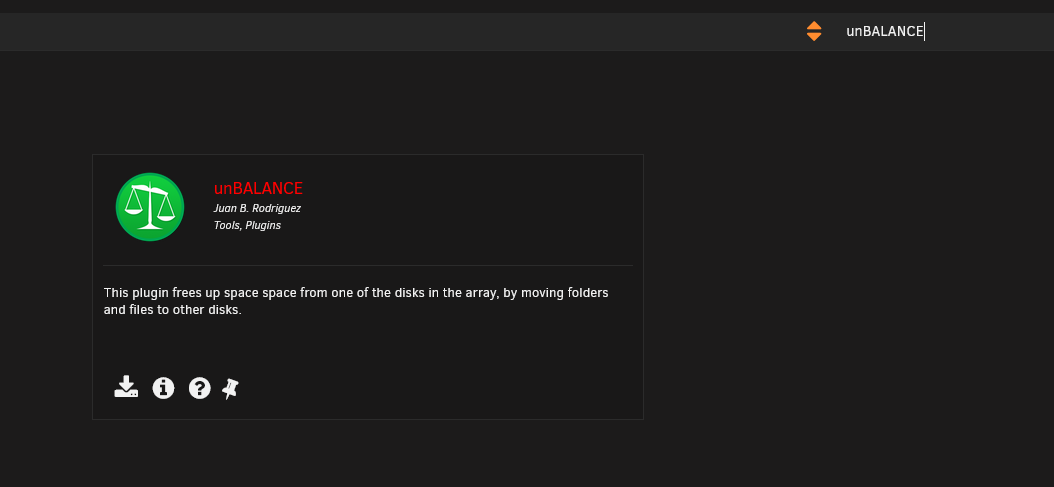

Wow, its like a whole new world.  I have installed the APP.
