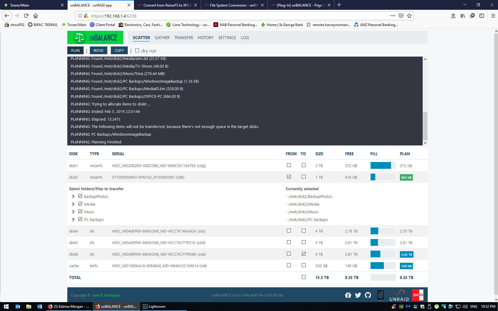

Not sure if it is something im missing, but im trying to move the contents from disk 2 to disk 6
Disk 2 has got 582GB, and disk 5 has 2.8TB Free
When i run the Plan option, it tells me that a folder cant be moved because the target disk doesn't have enough space
Am i missing something here?
Hi, looking at your screenshot, it's reporting
PC Backups/WindowsImageBackup as being 1.16 EB !!! 😮 😮 😮
Do you have any idea why that might be ?
The plugin obtains folder size with du, a system level command, so I'm not sure what could be the issue.
Let me know.
@jbrodriguez
Not sure why its reading like that.
When i look at the share size in the GUI, it reports as 551 GB
Ill try a restart, and see if it helps! Cant think of anything else
Run this from the command line
find "/mnt/disk2/PC Backups/." ! -name . -prune -exec du -bs {} +
Post back the result
@jbrodriguez
Result from cmd line
1155541323535496270     /mnt/disk2/PC Backups/./WindowsImageBackup
528     /mnt/disk2/PC Backups/./MediaID.bin
866     /mnt/disk2/PC Backups/./OFFICE-PC
Right, that's ~1.2 EB !
Can't tell why that's the case, though 🤷🏼‍♂️
What, etabyte?
WTF
How can it be reading EB?
I dont have THAT much storage!
I think i will delete that folder, as i can manually run a backup later.

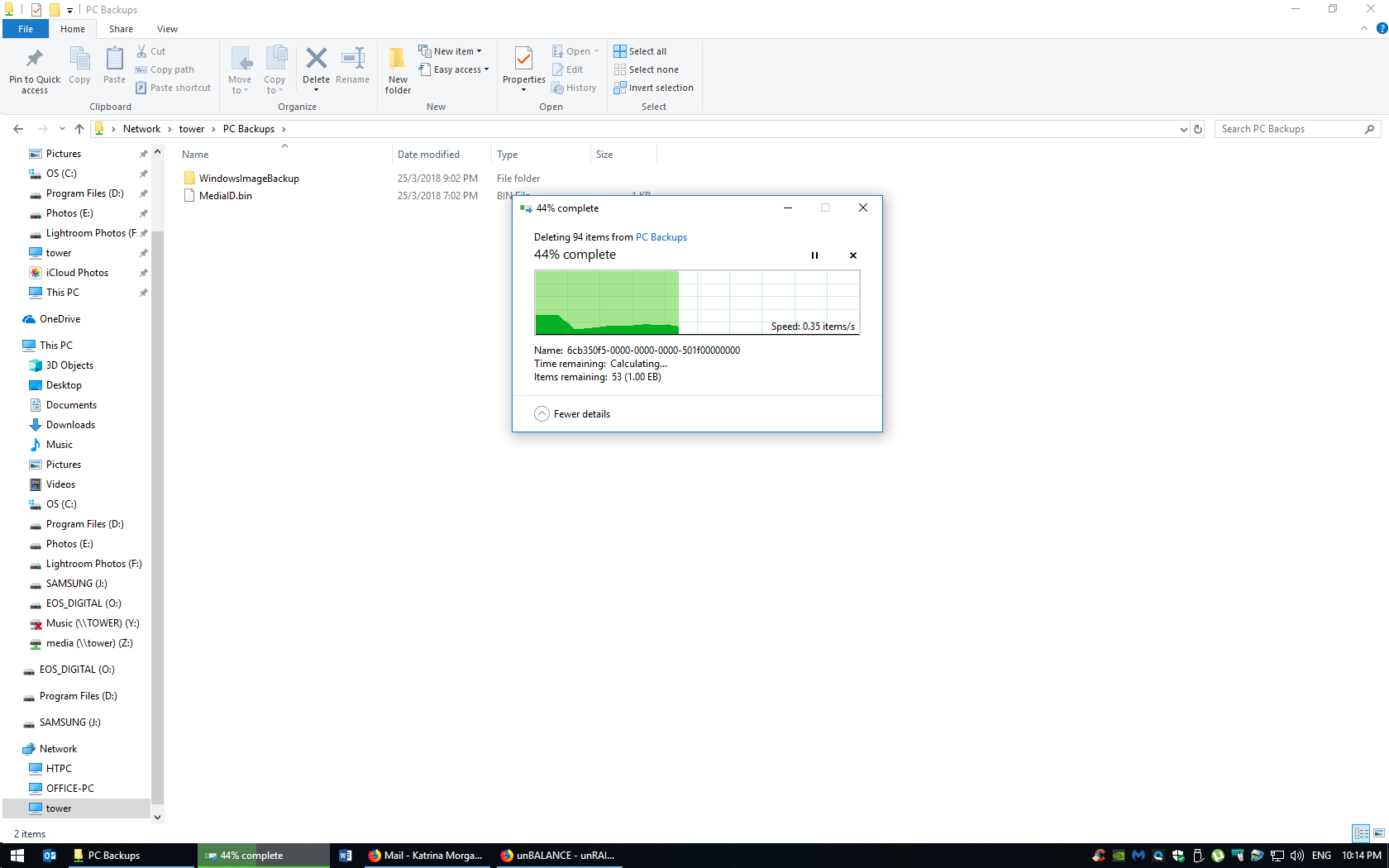

So i just tried deleting that folder contents on my windows machine, and
windows popup reporting as 1.0EB
Im baffled!
