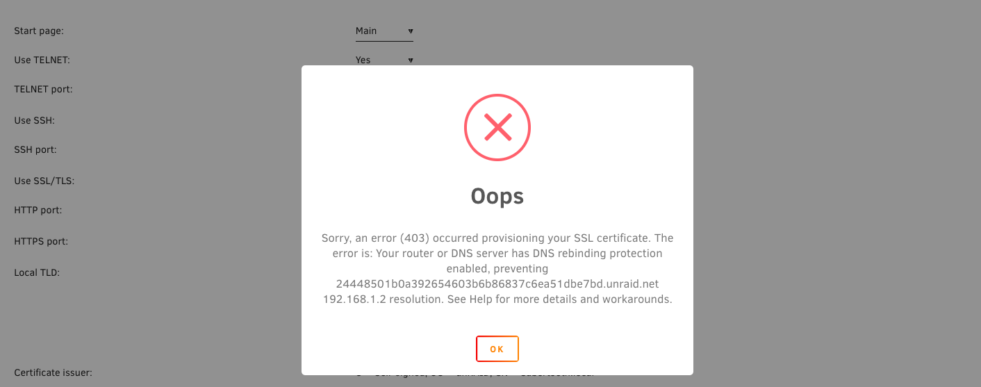

btw, I've already encrypted 2 drives, new drives (cache and array drive) but I never provisioned the SSLl Not even sure what that means really, or if that's what causing my issue. Anyway I tried to do it and got his error. Attaching screen shot.
I am using a pi-hole on a raspberry pi, with the router dns set to the local ip for for the raspberry pi. not sure if this is why I get this error or if this is something should fix, but hopefully you guys could help? Did i screw up  by encrypting drives without this ssl thing? I just saw that space invader one talked about it
This is slowly starting to get VERY overwhelming. Can you guys help me? I do I need to do this SSL thing? Are my drives not really encrypted without this? I don't know what to do, is this the issue with why my speed is so slow? Again I was able to encrypt 2 drives already without this SSL DNS, resolver thing which I don't even know what it is, or how to fix it on my ISP router with Pi-Hole running

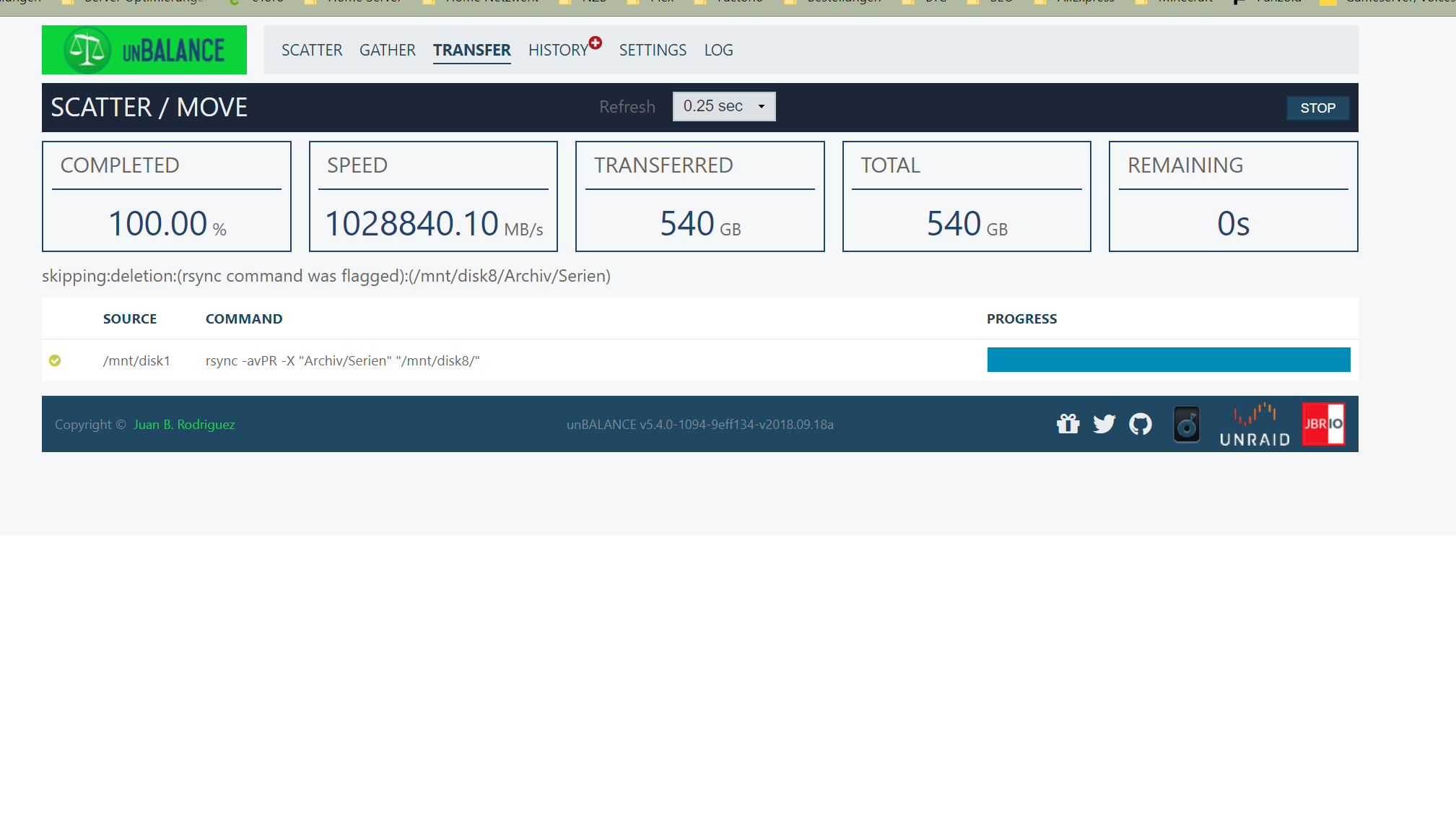

What i dont understand is:
I did now already 2 or 3 times gather move disk 2 -> disk 9, its 2 times successfull (with a checkmark in yellow), but if i go to history and redo it (because i still see files) it does the same again... and again... and again? Like if its not really moving it?
WHat does that mean?
skipping:deletion:(rsync command was flagged):(/mnt/disk9/Archiv/Spiele)
Nvm. i found out you can expand if its yellow flagged and can manually click rsmc, i checked that the dirs are empty and clicked it.
