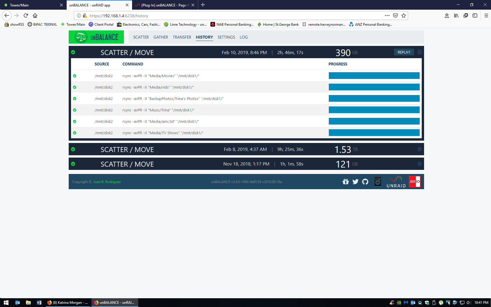

Have just run another instance. Moving contents of Disk 2 to Disk 1
Instead of Move, it seems to have copied the files instead.

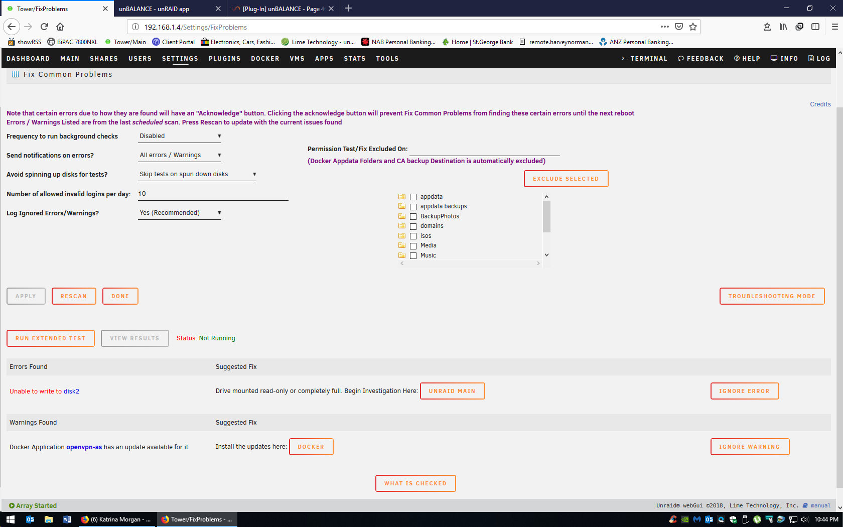

Could it be because, for some reason disk 2  is set to read only in Fix Common Problems

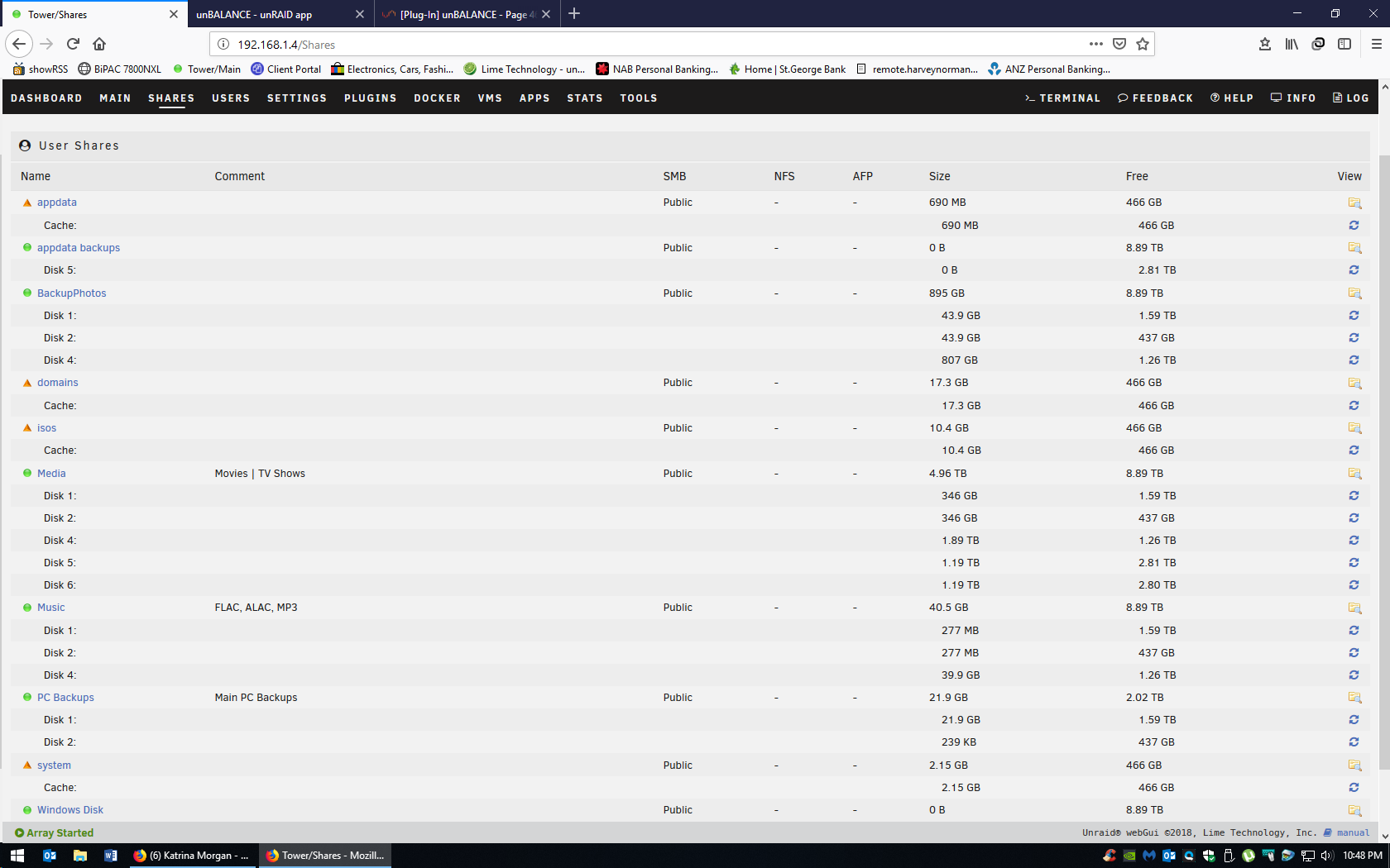

I can see from this screenshot, that all Disk 2 is the same size as Disk 1, for each share (except pc backups, but that fine)
Is this good sign that it indeed copied everything to disk 1?
Fix Common Problems is just reporting that it is set to read only. The Unraid OS set it to read only due to filesystem corruption so it won't get worse. And when it is read only obviously nothing can be removed from it.
So the move cmd in unbalance will move the files (or this case copy them) and not delete from source?
It will delete the source files if the rsync (copy) command was successful, which seems to be the case as per you screenshot.
If you send me the log (/boot/logs/unbalance.log), I can take a look if it was unable to delete the source for some reason (pm if you prefer).
Nothing can delete from a read only source, not any process. Your problem has nothing to do with unBALANCE.
You already said your source was reported as read only. Everything is working as it should. It would delete from the source but it can't because the source is read only. You must have filesystem corruption on the source disk.
Thanks - I was double checking that even tho i had used the move cmd, files were still copied to the target disk even tho disk 2 had errors.
Which Yes it did. Disk 2 had an error, so in this case, file were copied from Disk 2 to disk 1. leaving file on source disk.
Knowing i had duplicate files, i could safely format disk 2.

Not sure when it started, but Unbalance will no longer run for me, just says 'stopped'. I noticed on 6.7.0-rc3 so I upgraded to 6.7.0-rc4 and still the same. Am I missing something?
Try
- Enable unBALANCE server -> No
- Apply
- Enable unBALANCE server -> Yes
- Apply
Should work.
Let me know otherwise.
