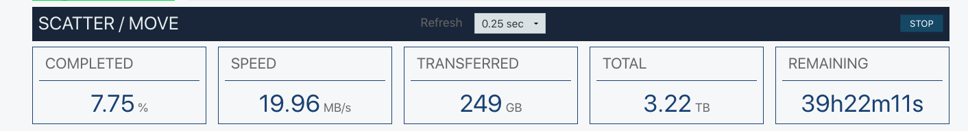

Can someone please help. I am having so many issues learning v6. I came from unrid v5 for 5 years without any issues...
I am encrypting drives so I am first using the unbalance plugin to move files from one drive to another, then exncrypt the empty one, etc...
For some reason everything has come to a crawl lately. I have disabled any parity and don't even have any parity drive assigned. I am getting max speeds of about 20MB/s! I just goan i5 8400 processor, LSI IBM m1015 controller. Never had issues with such slow speed before! Can someone help me out and let me know what's happening? I feel like this is slowing down my other dockers that I installed. I have 16 gigs of ram too. What's happening and why is everything so slow, even without parity!
