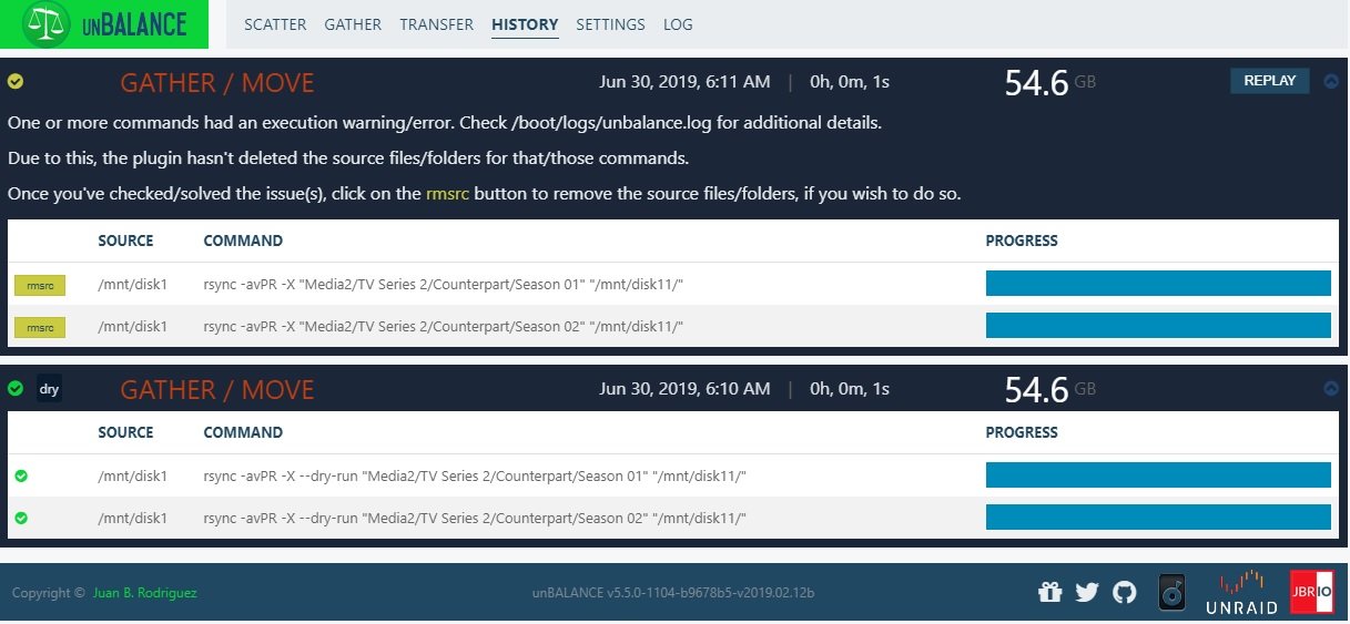

I seem to be having an issue with unbalance...  Whenever I run it to move files across my disks, it always ends with an error...
After checking the disk the files were supposed to be moved to, I see it made the directory and sub-directories but there are
no files within them.  It doesn't matter if I use scatter or gather, I end up with the same error...  I have tried deleting the .conf
file, as well as uninstalling and reinstalling the plugin...
unbalance.hist
Check the log ... /boot/logs/unbalance.log for additional information about the error (send it over if you want, I can take a look, pm if you so prefer)
