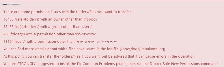

Hi - I'm hoping someone can put my mind at rest, or advise.
I have only just installed unBALANCE and used it for the first time to try and move data about so I could free up disks to upgrade the file system from ReiserFS to XFS.
So, first I added a pre-cleared disk to the array, copied all the data from one of the full (ish) disks to the new one - which left me an empty ReiserFS disk. When I did this it warned that there were 8 files/folders with an owner other than 'nobody' and STRONGLY suggested to run the Docker Safe New Permissions command - which I duly did. I re-planned the move and I was away from my machine, so didn't see any warning message (as this only seems to be shown for a few seconds then disappears!). So, I did the move and all looks OK... the ReiserFS disk only had a handful of empty folders left showing on it... so I formatted this into XFS and all looked good.
I then set up unBALANCE to move the data from then next disk to the newly formatted, empty, XFS disk and hit PLAN. This time it came up with a whole list of 'errors' and recommended running the Docker Safe New Permissions command - which I duly did again. After this was complete I re-planned the move and still have the same list of 'errors'.
I have attached a screen shot of the warning message.
So, I am holding back on moving anything else in case I am doing something wrong - so some advice would be welcomed. Or the other option is to ignore this warning and move it anyway?
Thanks
Thanks
A quick update, I SSH'd to my UnRAID box and looked at the folder (share) permissions in /mnt/user/ and they are all showing nobody : users - all the folders show rwxrwxrwx (0777) and the files show rw-rw-rw (0666). So as far as I can see, this should all be OK?!?!?! I double checked this in WinSCP too and had a quick browse, but cant see any obvious problems.
Thanks
OK... another update - I Planned each share separately and found that the errors were coming from the /appdata share - I used to have an app called 'My Media For Alexa', which I dont use, or have installed now, so I will just delete this directory and that should fix this issue.
Sorry to clog up the forum, but thought I'd post my findings in case anyone else ends up here with a similar issue.
Thanks

1 hour ago, SliMat said:
...and STRONGLY suggested to run the Docker Safe New Permissions command - which I duly did
39 minutes ago, nuhll said:
Or... u just use "install the fix comon problems plugin, then run the docker safe new permissions command"
Thanks Nuhll - as per my original post... I did do this ;-)
Edited by SliMat
and it didnt worked? u have to plan again?
Hi Nuhll
As my later post said... no, it didnt work, even when I ran PLAN again.
The issue seems to be that the 'Docker Safe New Permissions' command, ignores the /appdata share (for obvious reasons) and its in here that I have a load of folders and files which are not nobody:users... they are root:root - which is why UnBALANCE cant move them. So as I no longer use 'My Media For Alexa', I have manually deleted this directory and now all is working OK.
Thanks for the help though.
Ok, glad you found out.

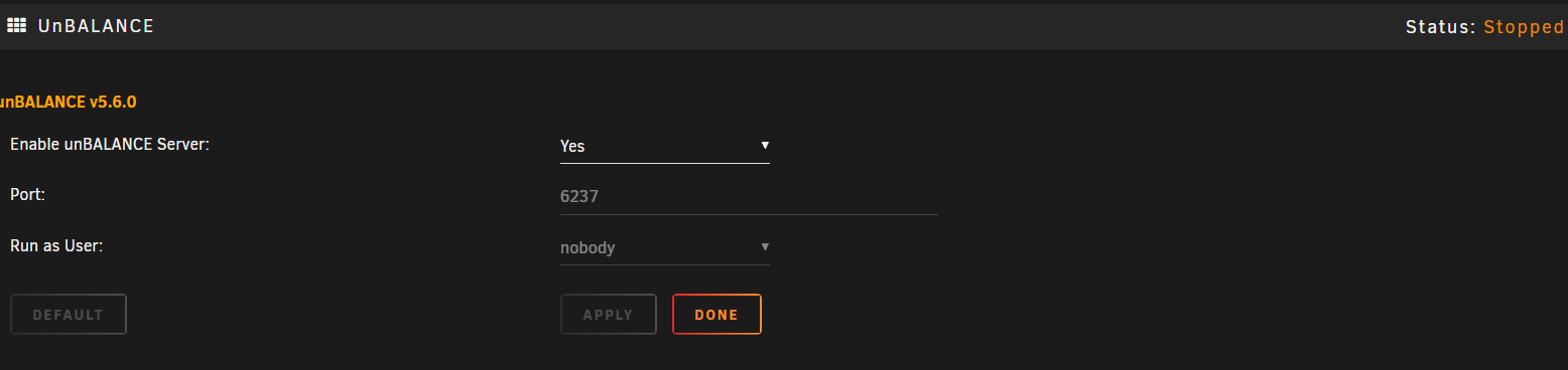

hi, cannot boot the plugin, list log as below
Sep 13 15:27:47 P101-S ool www[19885]: Invalid #command: /usr/local/emhttp/plugins/unbalance/scripts/start
Sep 13 15:28:26 P101-S ool www[19670]: Invalid #command: /usr/local/emhttp/plugins/unbalance/scripts/stop
Sep 13 15:28:31 P101-S ool www[19885]: Invalid #command: /usr/local/emhttp/plugins/unbalance/scripts/start
Edited by rallos_hoo
Hi, can you try running it from the command line, to make sure it works ?
/usr/local/emhttp/plugins/unbalance/unbalance -port 6237
