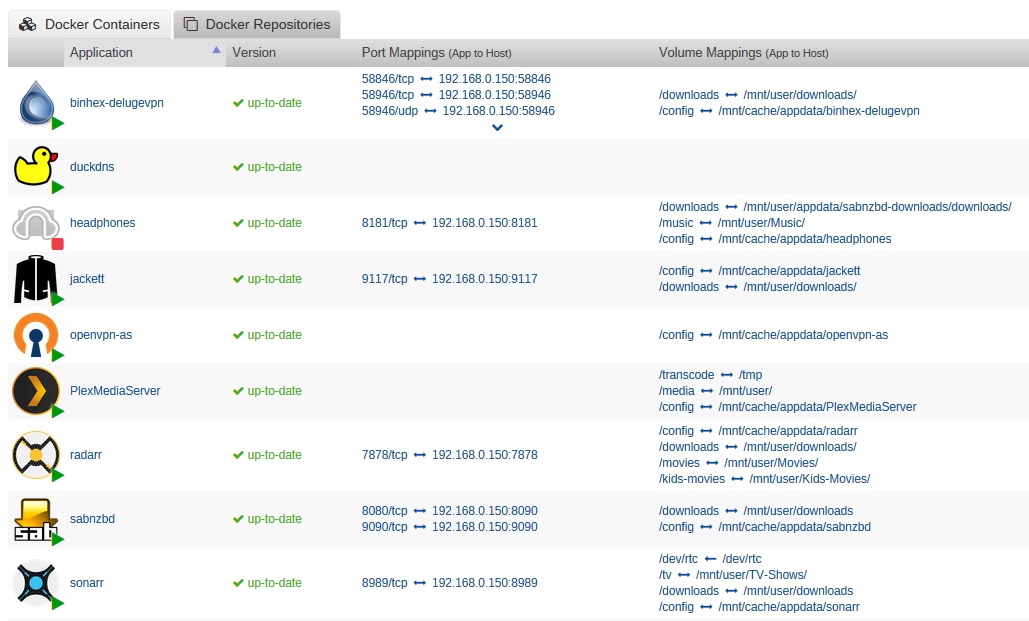

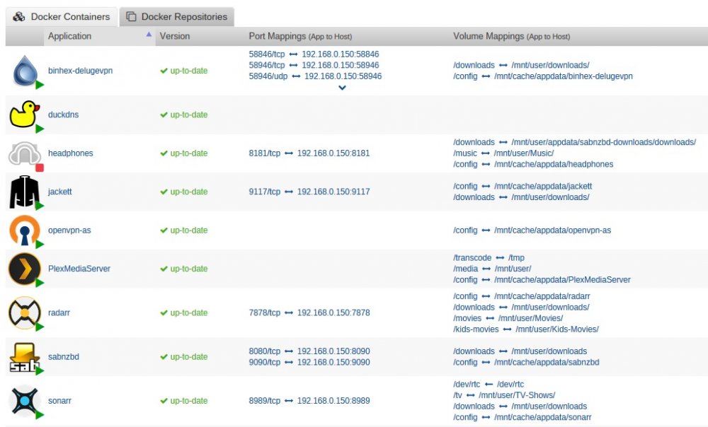

no it didnt still had the same error but as soon as i added the Remote Mapping in the files instantly renamed and moved
22 hours ago, ElectricBadger said:
However, Deluge refuses to connect and download anything — all torrents just sit at "downloading 0.00%" and all trackers time out.
have you configured deluge correctly?, you need to setup where its writing to for completed/incomplete, it should be writing to /data, which will be a volume mapping to your hosts fs.
This is the mapping that made everything work
Main key to success was changing Deluge from /data to /downloads
Unless there is a better way ??
Edited by brettm357
Not strictly correct, the main key to success is that the applications configured download location (the container volume path) AND the host volume path ARE EXACTLY THE SAME for ALL DOCKER CONTAINERS that need to interact.
Read that bold section, then read it again, then get the tattoo on your arm, and lastly say it last thing before you get in bed :-)
So for example:- -v /mnt/cache/appdata/downloads:/data must be consistent throughout all containers, with the application set to /data.
Keep in mind /data can actually be called anything, it just needs to be the same, using a mix of /data and /downloads = failure, as does a mix of different host paths.

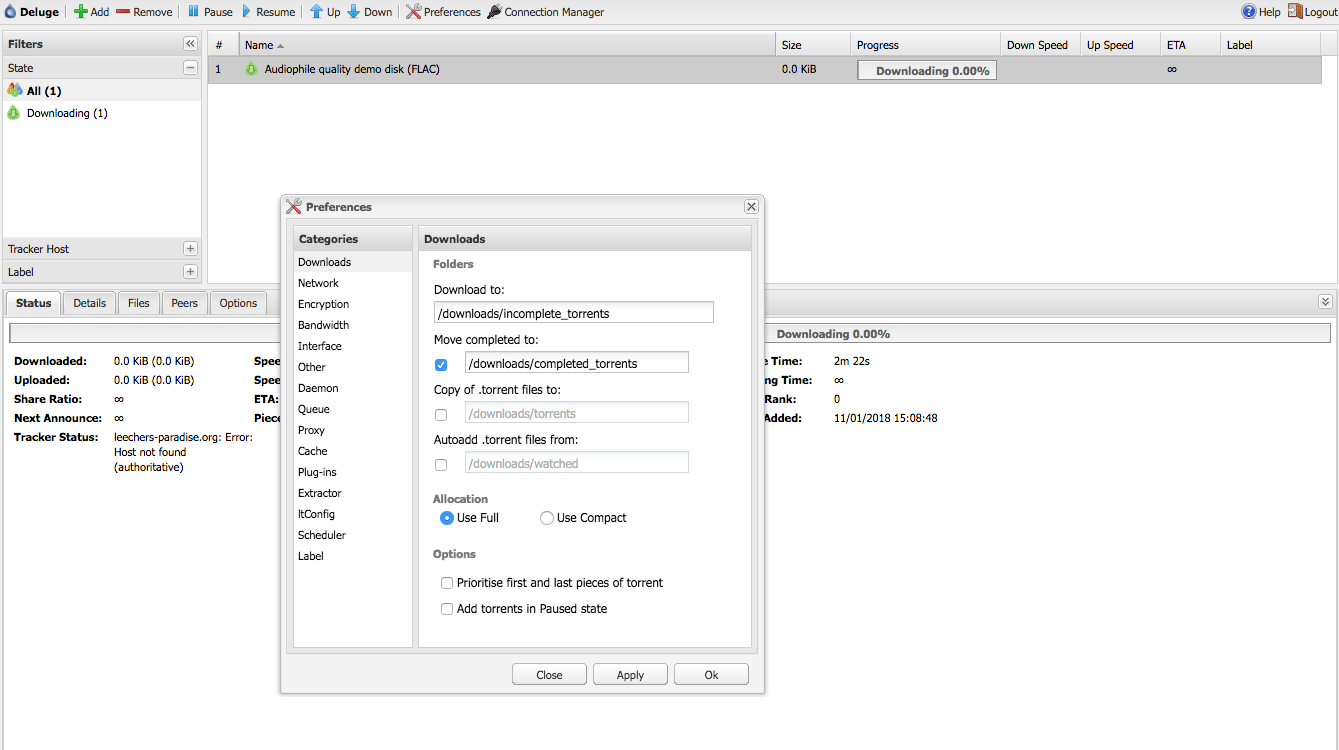

Yup, that's all correct:
5a577ec5d6cee_ScreenShot2018-01-11at15_09_38.thumb.png.85d4e1d6da77f4a4d9fe58a1b9b21d55.png
5a577ed0dceb1_ScreenShot2018-01-11at15_10_33.thumb.png.3cc3481479a6866d49a0b1dd1de7271c.png
/mnt/user/downloads/incomplete_torrents and /mnt/user/downloads/completed_torrents both exist and are mapped correctly when I look inside the docker with docker exec bash.
It seems to be an issue with connecting over the VPN though, as I said, it can download the blockfile OK so it must be getting out somehow!
