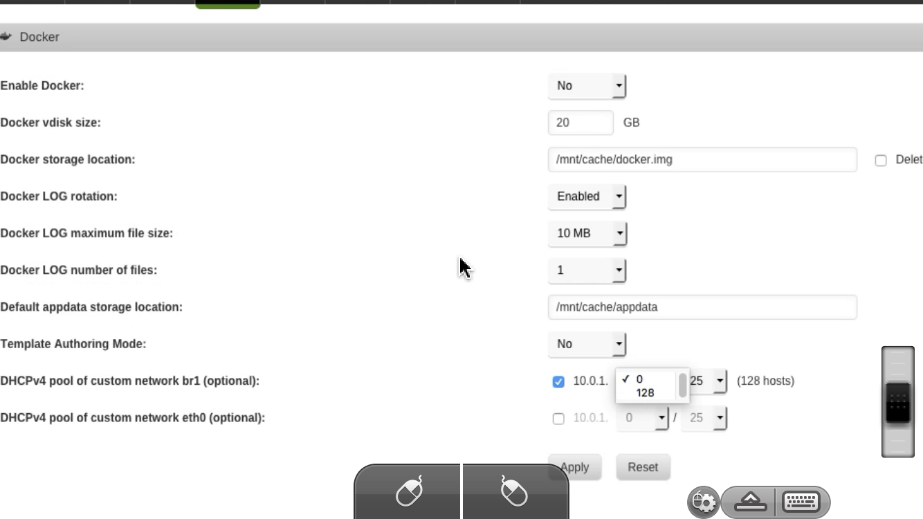

12 minutes ago, binhex said:
if your lan network is 10.0.1.0/24 (is it?) then set your deluge network to something other than that, e.g. 10.0.2.0/24,
Guess I’m not sure what you mean by “deluge network”? Are you talking about the br1 settings in settings>docker or the network type in Deluge docker configuration?
sorry that is a bit ambiguous, i meant the definition of the br1 network, so br1 network should be 10.0.2.0/24 (or anything other than the same as your LAN), in short delugevpn needs to be able to differentiate between your LAN and the internal netnetwork (aka br1) as used by docker in bridge mode.
Edited by binhex
Alright, I get that I think. And then set a static IP of 10.0.2.200 and 10.0.1.0/24 in the LAN_NETWORK Deluge configuration?

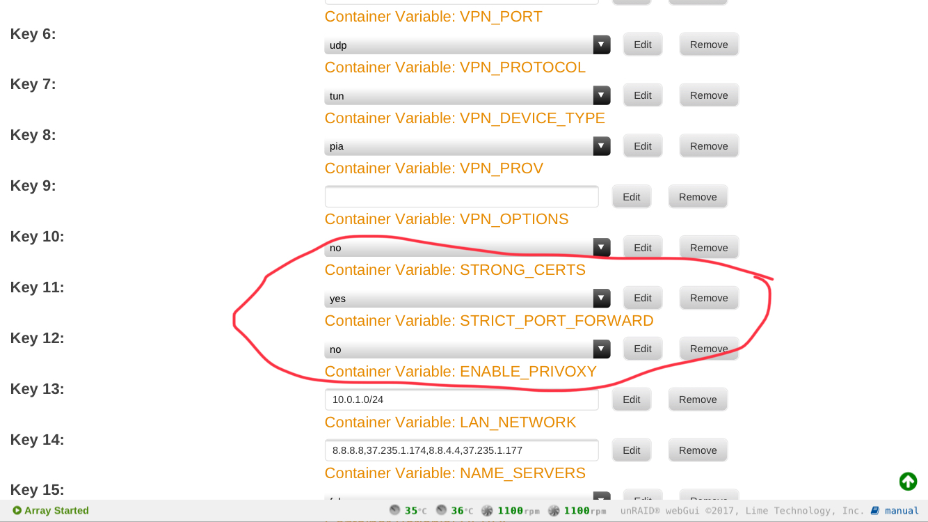

10 hours ago, takkkkkkk said:
Thanks how can I set STRICT_PORT_FORWARD to yes? I don't see that in the option
exactly, yes.
im actually quite surprised you could even define a overlapping network for br1, god knows what sort of issues that would give you, doesn't sound good to me (ip conflicts most prob)  so def needs fixing up.
Just now, binhex said:
exactly, yes.
That was actually the suggested setting ie it was already present in the settings and I put a check mark in the box.
hmm sounds like a bug in the unraid ui then to me, unless the idea is to give you a starting point, as in "here's your lan network, now create a new one thats similar by tweaking the octet".
IDK. It’s an optional setting. Maybe the idea was to give an example? Probably for most people 10.x.x.x would be completely different from their LAN.
5 hours ago, binhex said:
exactly, yes.
This isn’t going to work. I can’t change the subnet.
I am either use 10.0.1.0 or 10.0.1.128. I tried just not setting a custom pool at all but that failed too.
Ah I see, just had a play myself. So I only have a single NIC in my system so I can't try this, but can you not define additional networks for your other NICs and then use this for br1 or even create another bridge adapter?
I have to ask as well, why the heck do you want to do all this? What does it really give you over running it in 'normal' mode? I could understand it if your internet connection is Gbit

2018-01-19 18:04:10,108 DEBG 'start-script' stdout output:
Options error: --ca fails with 'ca.rsa.2048.crt': No such file or directory (errno=2)
Options error: --crl-verify fails with 'crl.rsa.2048.pem': No such file or directory (errno=2)
Fri Jan 19 18:04:10 2018 WARNING: file 'credentials.conf' is group or others accessible
Options error: Please correct these errors.
Use --help for more information.
[info] OpenVPN started
supervisord.log
EDIT: NEVERMIND I wasn't even thinking about backups. Restored from an app data backup and now everything seems to be working. I think I'll just leave everything alone for now. :D
Edited by wgstarks
