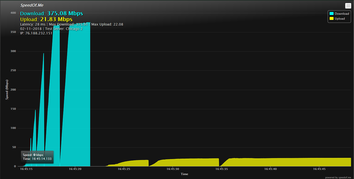

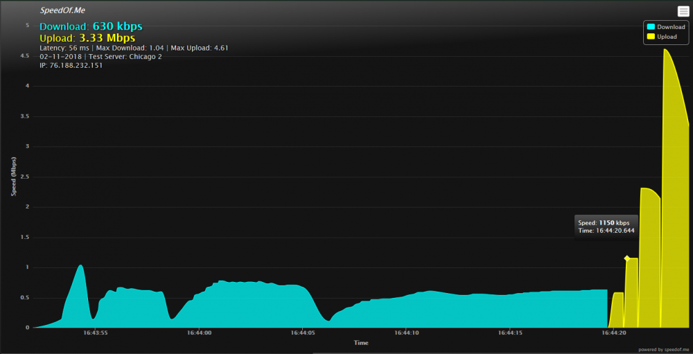

Here are all the things I've tried:
  • Checking the logs (see nothing that would indicate any type of failure except `Authenticate/Decrypt packet error: packet HMAC authentication failed`)
  • Setting the "vEthernet (DockerNAT)" interface to "Private" and ensuring it isn't blocked by Windows Firewall
  • Checking that my router is not blocking any traffic
If anyone has any suggestions, I have tried what I could find in the FAQ; any help would be greatly appreciated!
supervisord.log
Edited by winglerw28
Adding images of speed tests
