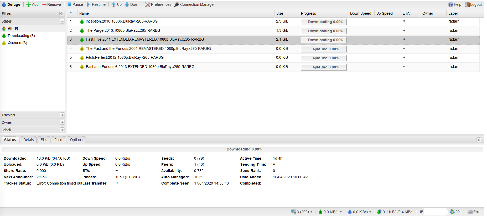

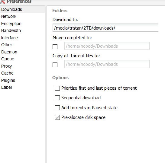

I've been through what seems like every solution on here. I'm very new to unRaid and have a mild knowledge of networking, so please ELI5 if you can. I cannot get the WebUI to load with VPN_ENABLED. I'm using PIA with the proper credentials. I've copied over the correct cert files and tried multiple region .ovpn files, including confirmed port forwarding locations. Logs show nothing alarming, it says WebUI started, but when I try to load the WebUI, it just never connects to it. I'm on br0 mode, locked the IP, but have tried different IP configurations, including Bridge. I've deleted and started over from scratch. I've deleted web.conf and had it rebuild. Nothing. "This site cannot be reached." WebUI loads fine with the VPN off. Can anyone please help?

2 hours ago, ironsights said:
Ok so I put both the supervisord.log and my docker compose file in these pastebin links. Let me know if that helps.
Ok, so a few things here.
1. Nordvpn does not support port forwarding so even if you were able to get it to work your speed will be slow at best. It wil also only work on public trackers since you won't be able to seed. So do yourself a favor and switch vpn provider
2. VPN_PROV is defined as nordvpn, AFAIK there is only three valid options PIA, Airvpn or custom. If you don't have PIA or airvpn it should be custom.
3. Are your volume mappings corrrect? What path do you have under downloads in the deluge settings? Even if it's correct it won't work well with the radarr container you have. These two containers needs to share the same volume mapping for downloads, or else radarr won't be able to see the downloads when deluge is finished with them. So you need to change the container side of the mapping for one of them so they match.
1. I didn't know they didn't support port forwarding, but I've already got their membership for another year or so, so I'm stuck with them for now. But I was using NordVPN with haugene / docker-transmission-openvpn and it worked pretty good.
2 and 3. I fixed both of those discrepancies but with the same result. Every torrent is showing the tracker status as timed out and the downloads stay at 0%. Here's my updated docker-compose file.
br0 is not supported in this container change to bridge. Or you might be able to get access if you use the desktop/thin client insted of the webui on br0. Check the faq on who to set it up if you want to try that. Is your LAN_Network defined correctly? What have you defined and what Ip are you connecting to?
Disable strcict port forwarding too and try again. Your volume mapping looks better, but what path do you have under downloads in deluge?
Edited by strike
Ok did that. Same thing so far. It's weird because it'll look like they start downloading go to like 0.15% then drop off and go back to 0%.
Here's another screenshot of deluge if it helps.deluge2.thumb.png.0276b491cdc2b105ecf90b1f3e0eb56c.png
Yeah, your settings are still not correct, you need to understand how volume mappings work.  The download path to should be /downloads
I also strongly recommend setting an incomplete and a complete folder. So the download path then should be /downloads/incomplete also check move completed to and set it to /downloads/complete
Looks like you're using labels too so make sure the paths are correct under there too. If you set incomplete/complete folders and lables make sure to change the settings radarr accordingly
Edited by strike
As stated, I've tried Bridge, but it doesn't change anything. LAN_Network has been tried in many formats. including 192.168.1.0/24, blank, and matching IP i set to as br0. I use br0 on everything, including DelugeVPN at the moment, everything works until I try enabling the VPN, but like I said, even on Bridge, WebUI will not load.
Ok. Thank you so much for clearing that up. I could not grasp the concept of volume mappings for the life of me. I have it setup like you suggested. I don't really know how the labels work though tbh. Does that just make another directory in the downloads directory?
Also downloads are still saying tracker timed out.
Edited by ironsights
Lol we've all been there 😆
Yeah, it basically tells deluge to put the finished downloads in the correct folder. If you're using radarr then you're probably using sonarr or something else for tv shows too, and if you have no labels deluge with put everything in one folder, so it becomes a mess for radarr/sonarr trying to figure out what is a movie and what is a tv show. As a result the logs will just fill up with errors. So labels is a good thing, but you need to set the paths correctly there too or else it won't work as intended.
