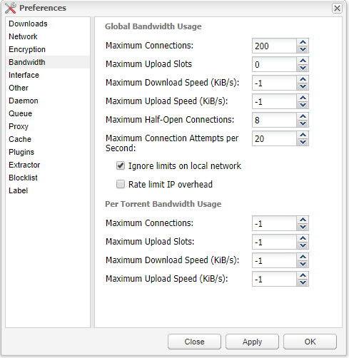

Does anyone have some optimal settings for deluge for speed?
These are my settings but the speeds are very slow :
Edited by Armed Ferret
adding screenshot
